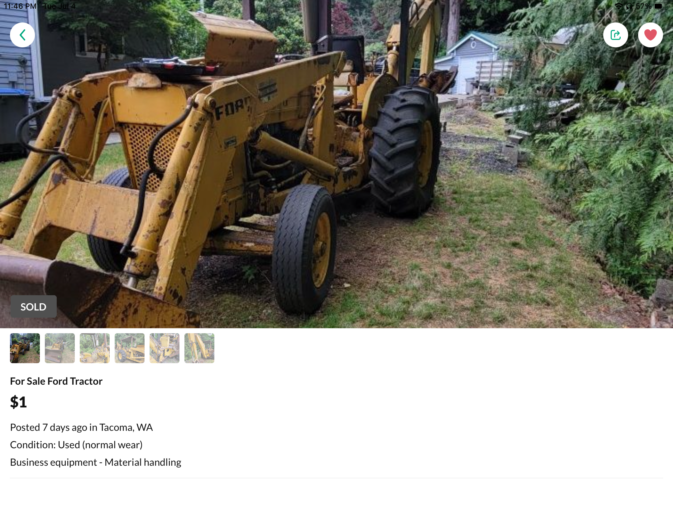

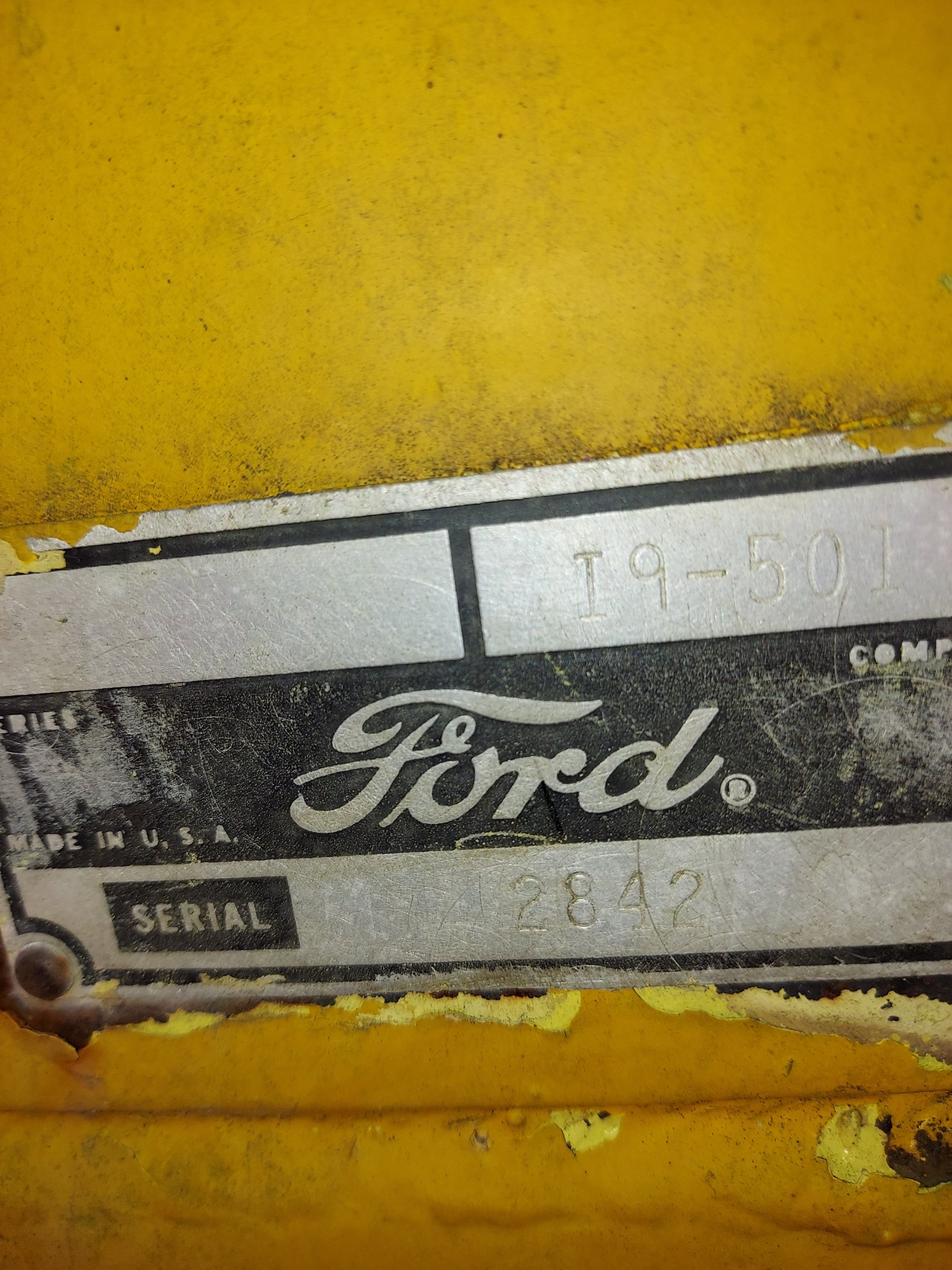

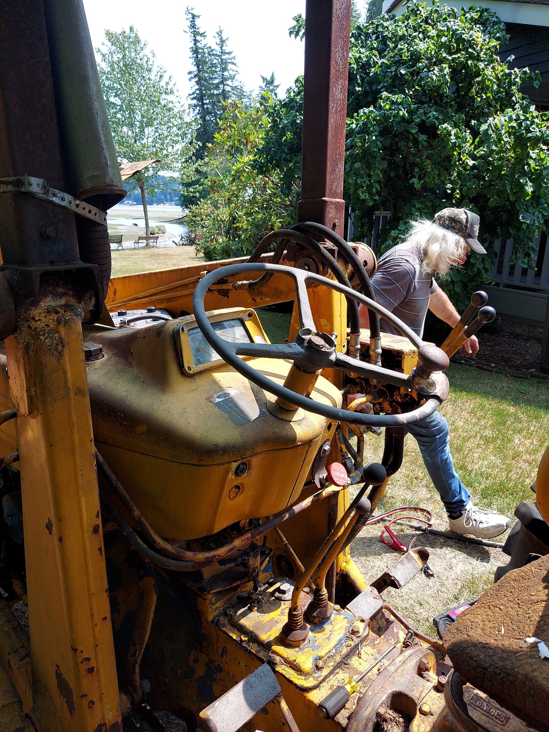

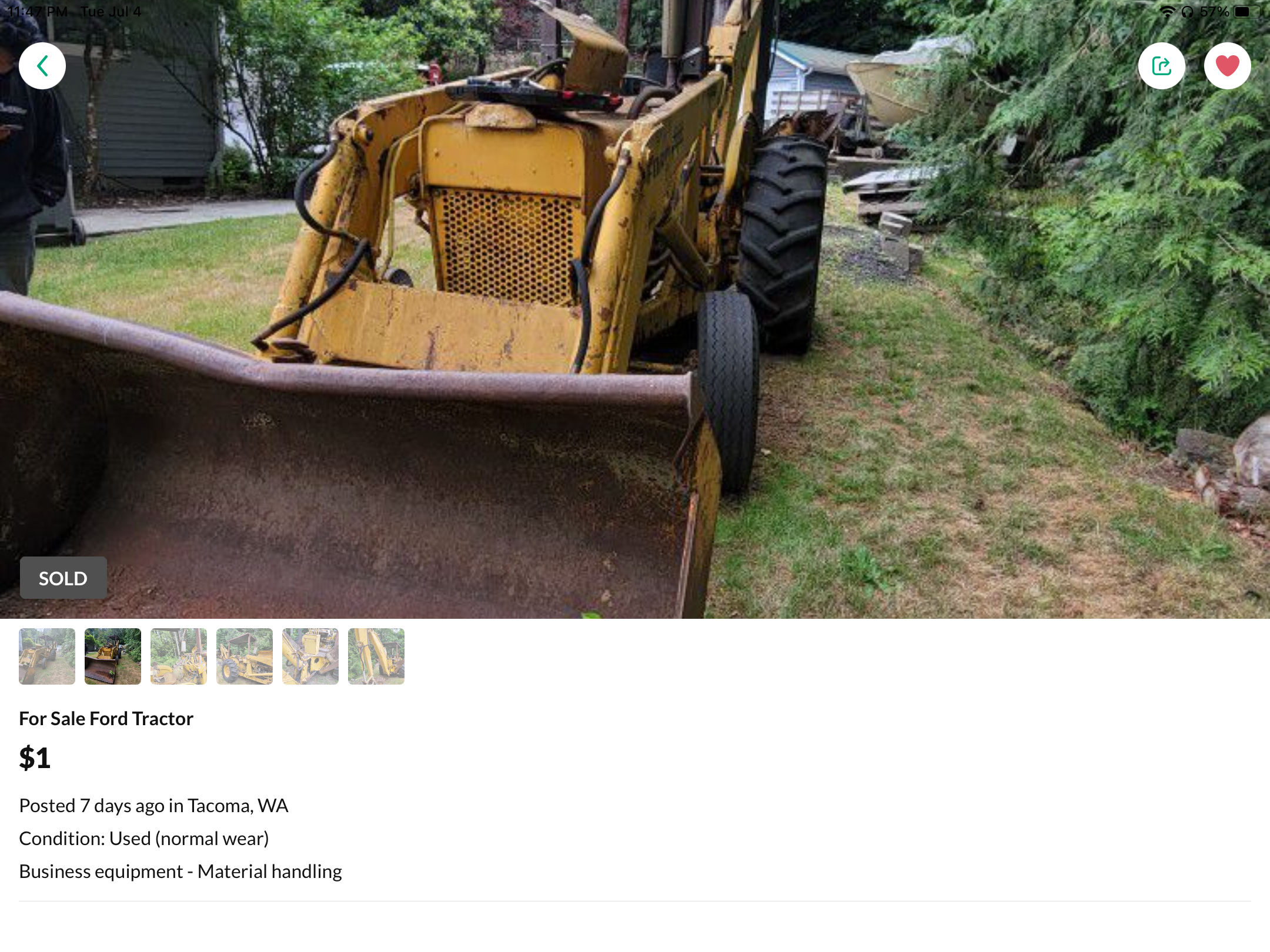

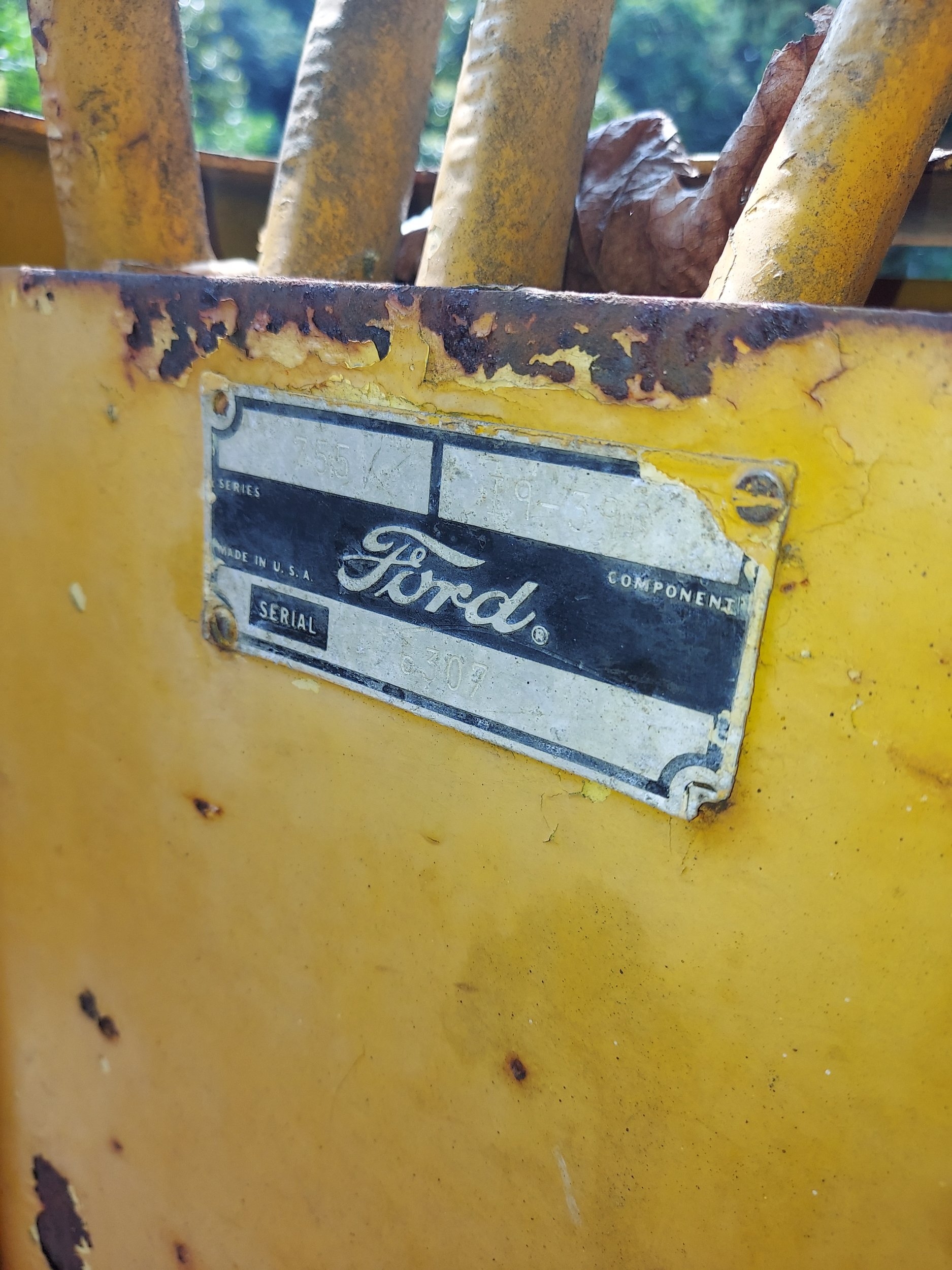

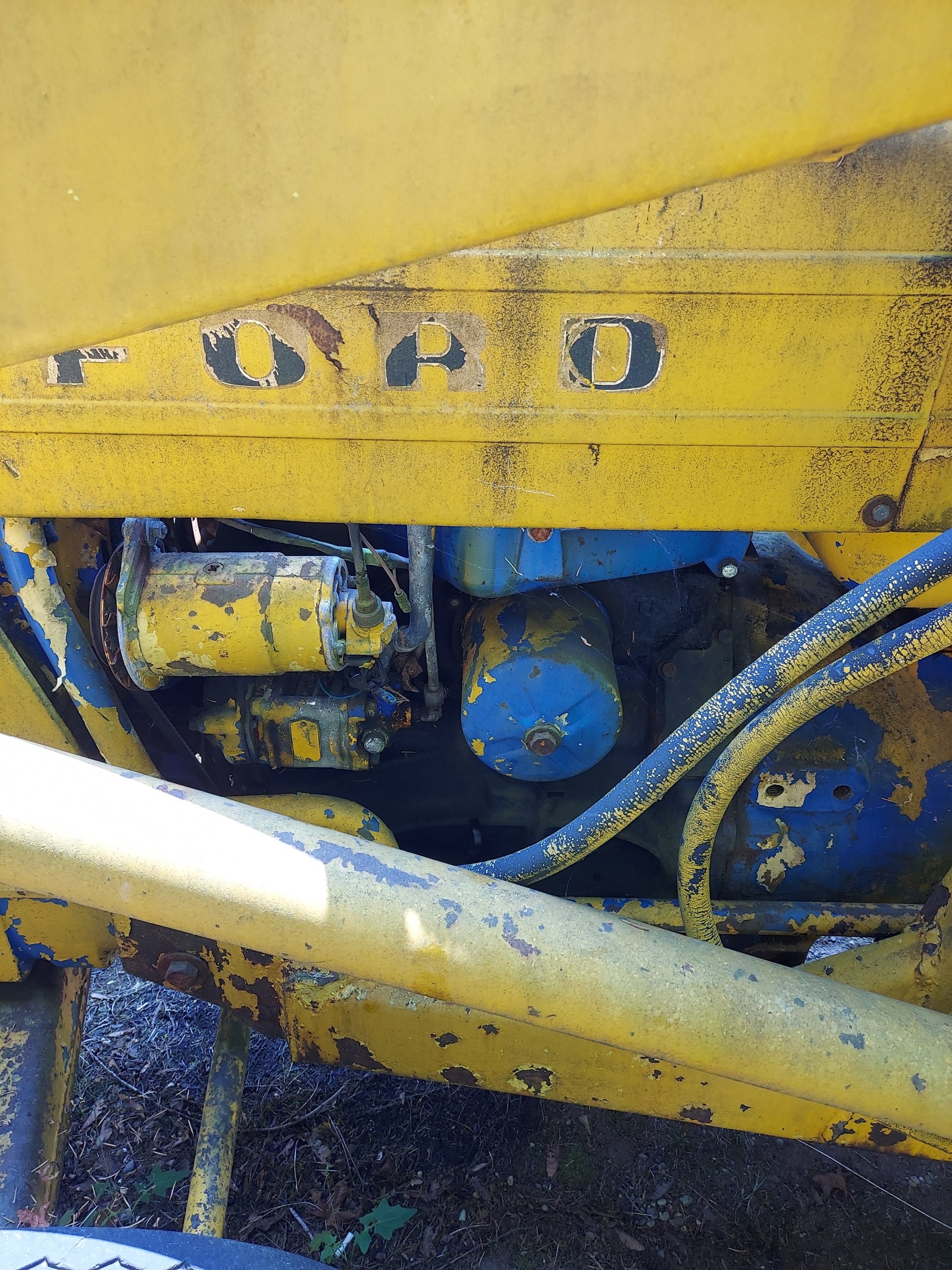

New to this forum. I hope you guys can help I just bought the tractor pictured. Can you help me identify. I was told it was a 755 but according to everything I researched. The 755 is a 4 cylinder 96 hp. PLEASE someone tell me what I have. Looks like 3cyl perkins
View attachment 809474View attachment 809475View attachment 809477

maybe a 3400 Industrial or?
not a 550 or 555- hood is wrong generator would be pre mid 1970s looks like a 4500 without a backhoe optioned possibly for a 3 point and PTO instead?? JAWAG

Thanks it has a backhoe huge I took picture of plate on loader and bacKhoe.Iwill try to send sale pictures.
/ Ford 755? #5
well a 755 is a backhoe that could be factory on a Ford 550 TLB and the 3400 3500 4500 industrial
One model had an even Bigger than the 755 backhoe, edit correction as posted later in thread by LD1 the 5500 Ford and 7500 TLB
Ford made it interesting with the numbers since they also made the "755" TLB that was around 20K lb 90+ HP machine
/ Ford 755?

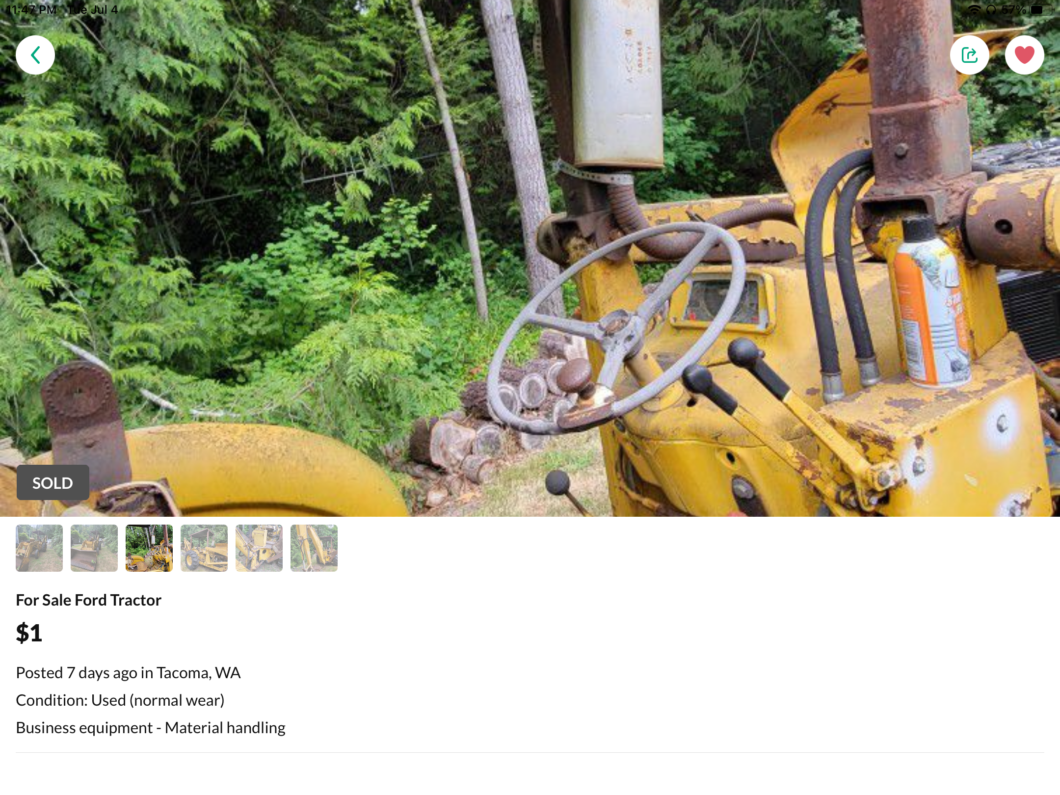

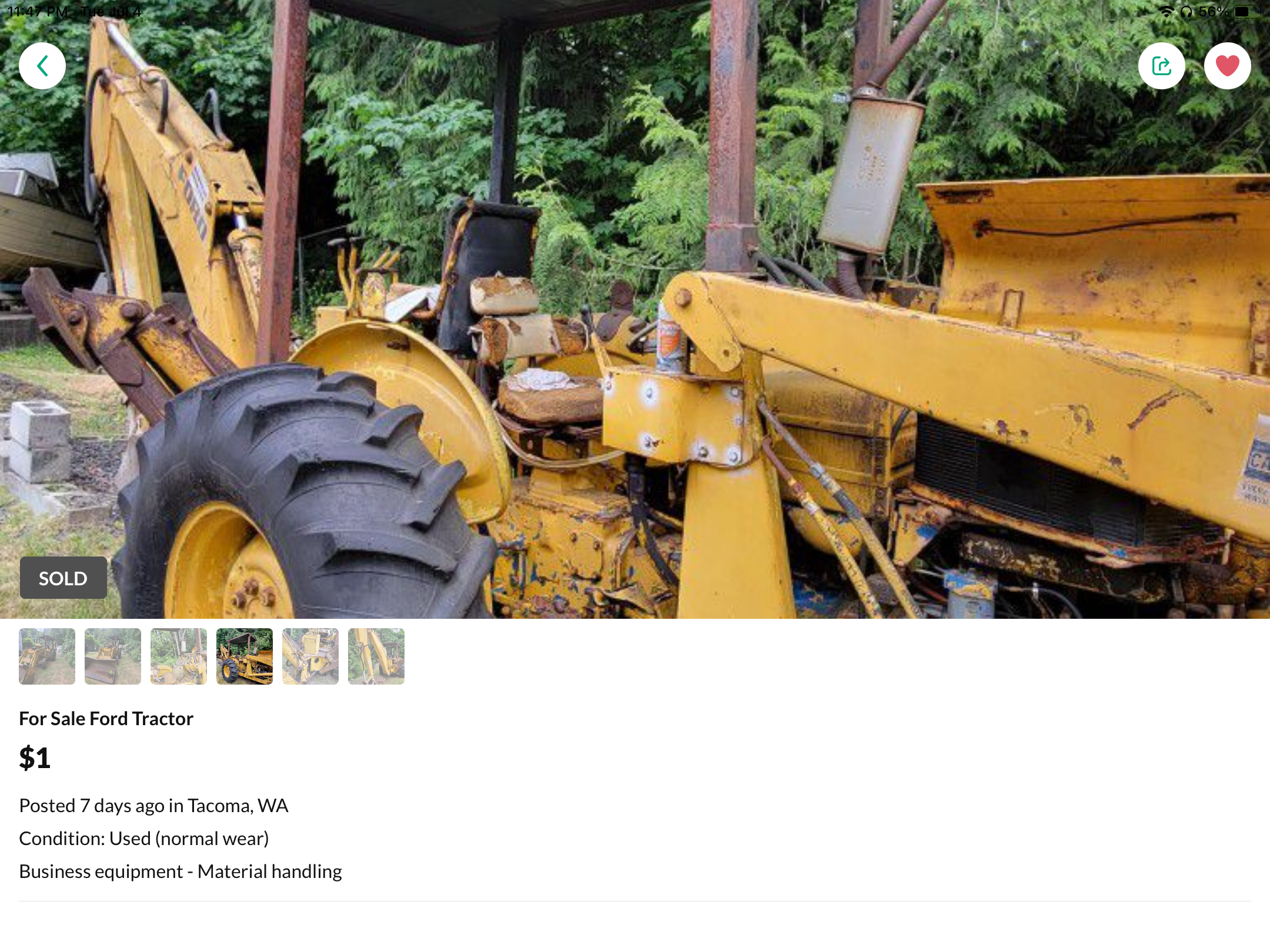

these are the pictures from sale add .I had been looking to upsize from my Kioti CK 25 to help me park out the heavy under brush in my forested remaining 4 acres in pacific nw. This came up for 2000 grand and I’m off on a new learning experience. So much to learn so little time .thanks for your help.
/ Ford 755?
/ Ford 755?
#9
I have decided it’s a 4500 like you suggested Thank you

Thank you for your reply. I have come to the conclusion that it’s a 4500 and I’m happy I don’t know if you got my last post, but I live in the great Pacific Northwest between Olympia and Tacoma, Washington.
