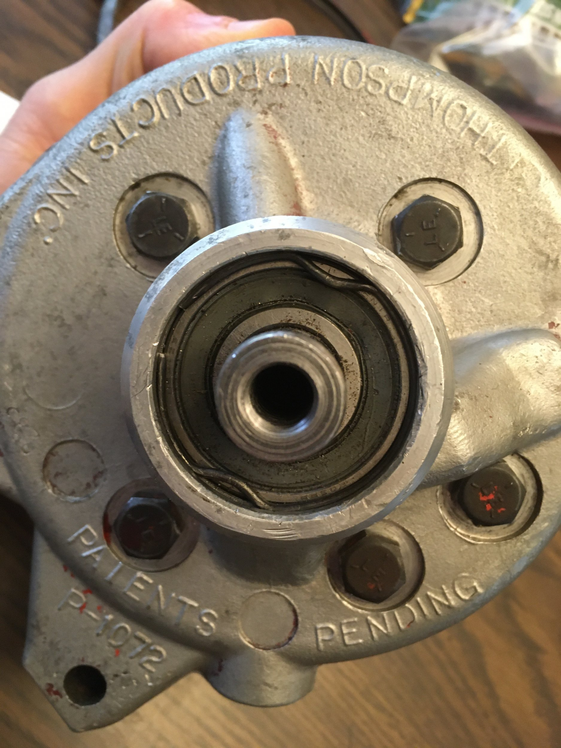

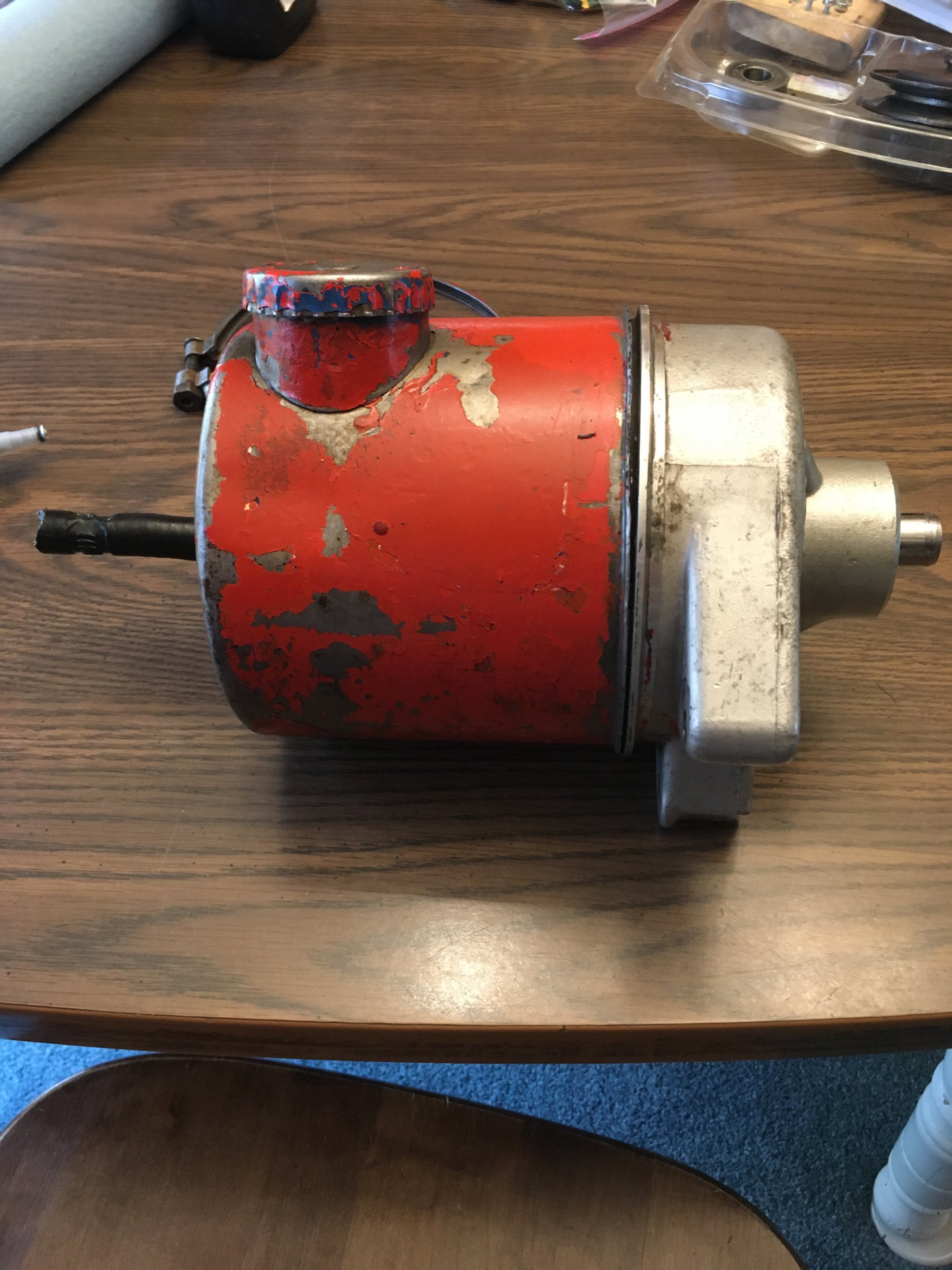

I am looking for parts or an entire pump for my Ford 800. It is a Thompson Products Inc. pump model P-1072. Any help on parts or resources would be greatly appreciated.
   / Ford 800 Power Steering Pump #2
I am just rebuilding our P 1072. I have the bearing and seal kit.
Be careful disassembling the internal pump from the cast bearing retainer cover. The internal pump is very unique and complicated. if it comes apart and will if not handled properly, it is very tedious to reassemble. There is no need to disassemble the internal pump. You will get an education if it is allowed to slide apart.
