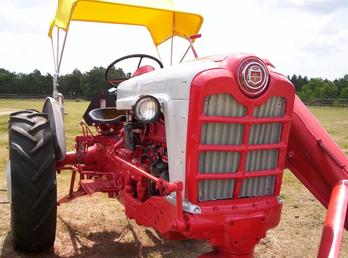

kinda hard to follow your posts.
the GRILL screen HAS to go on the 'inside'. that fits into the hood pieces once they are assembled the egg crate goes on OVER that.
i'm going to see if i have any pics of me assembling a 901.. probably don't.. but will check
this likely won't help much as it is of a rowcrop and doesn't have the lower bits..

only the 801/901 series wil have the egg crate and only the 801 will have the lower trim. I ...sadly... :( do not have any 801 I do have 901, and plenty of X00 though. wish I could help more, but just don't have pics or machines available with thtat trim package you seek.
hit this webpage.. you can see a pic of a very nice 801 and the lower trim.. might help some. see where it bolts thru the doglegs.. etc..
