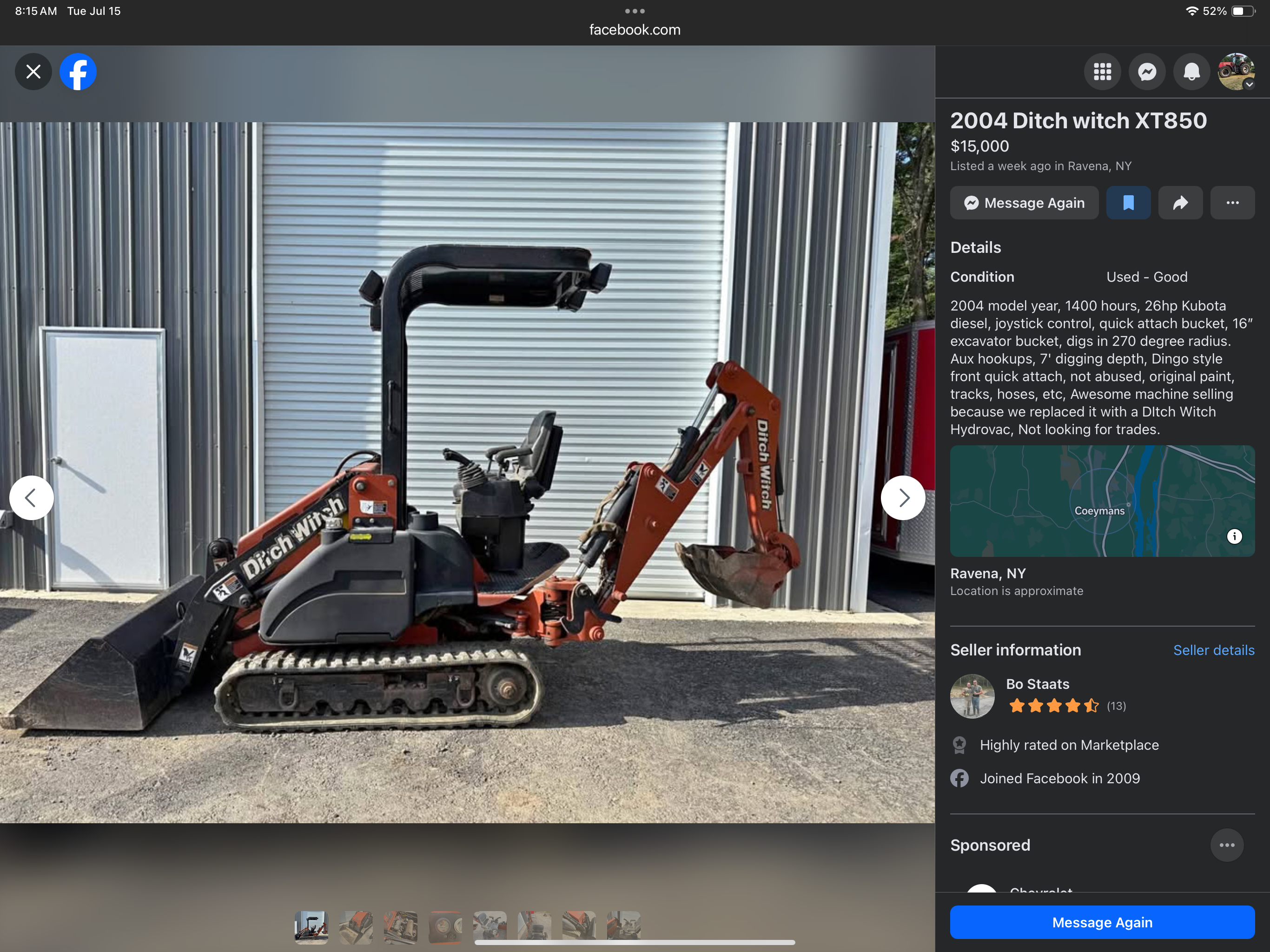

After reading your thread, I was wondering if you could find something like this? I would love to have this for tree work. Tracks would give you traction. Kubota Diesel. Backhoe. Bucket has 3rd function. This one sold in a week for ~$15,000 which even used, seems like a steal.
Newer version:
Newer version:
I'd love one of those. No Ditch Witch dealers on our Hawaiian island, however.
