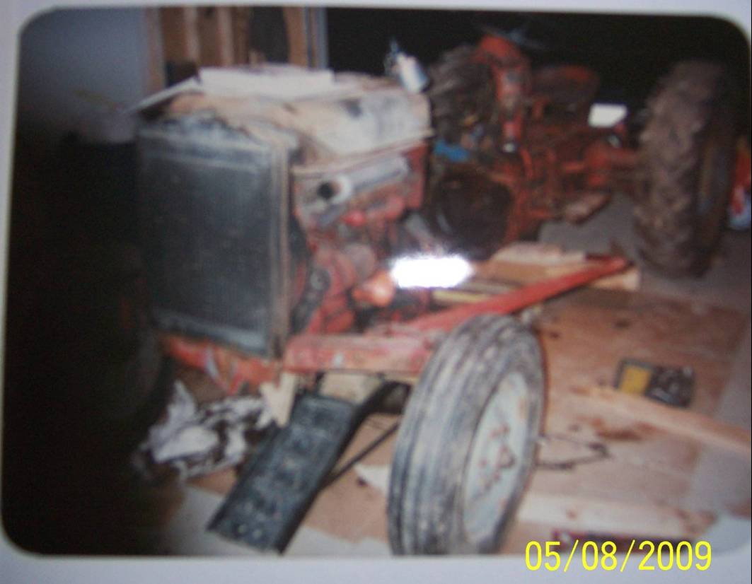

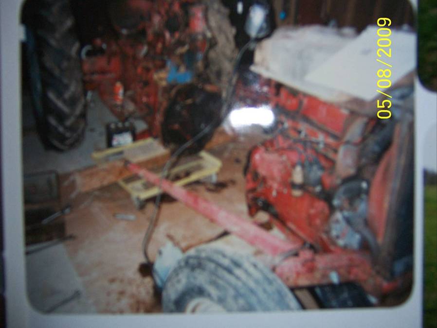

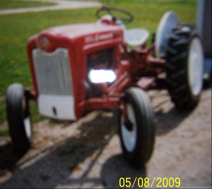

Hey. I found some old pictures of when I replaced my clutch in my Ford641 about 10 years ago. I did it with very few tools. The most difficult thing is ensuring that the clutch settings are proper such that you will not get chatter. For this you need a jig and then some lock tite. You can't adjust it once you put the tractor back together. It took me one weekend but I did other work that weekend. Also, don't over torque the clutch bolts - I broke one off and had to drill and retap it. Good luck. Here are a couple of photos but the quality is poor. It is pictures of pictures - ****.
