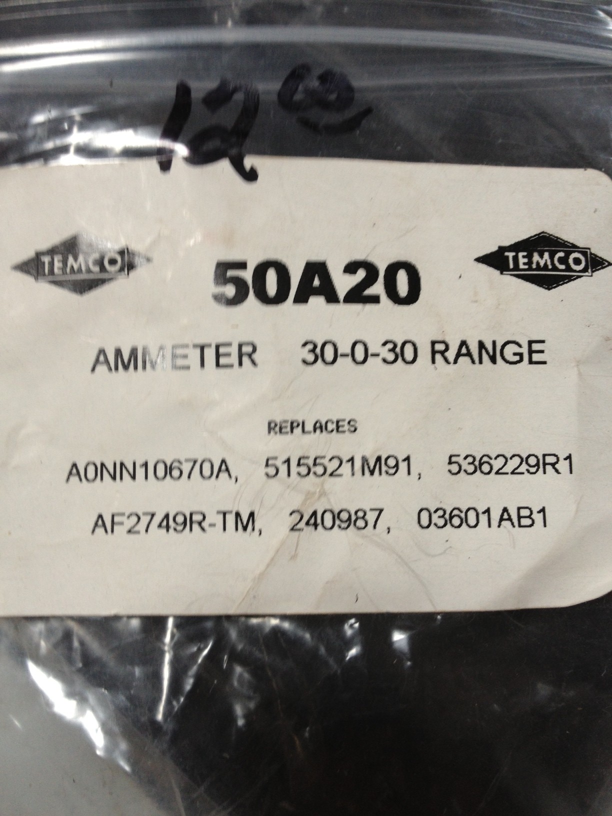

Update:
Went to the local Agri-parts store and purchased an ammeter which the clerk had to blow the dust off as he handed it to me. Here is the package tag. The clerk couldn't tell me if voltage mattered as far as if ammeter would run off a 6v or 12v system:
Next, I performed contuinity testing on the wires between the gennie and the VR and identified the Ground, Field and Armature wires. At the VR was a fourth unmarked wire which presumedly is attached to the BAT terminal on the VR. We continuity tested this and it had continuity with the battery terminals.
The gennie was bench tested on Friday at the repair shop and pronounced "normal".
The battery had been charged for three days and tested 6 volts on the button.
After wiring connections were made we turned the ignition key and observed the ammeter needle deflect as it usually does to the left. The tractor started and ran well. The ammeter never strayed into the positive side even with engine revs. Presumedly because the battery is fully charged?
The VR never became hot.
So have I fixed my problem or am I just kidding myself and running for a few days off a fully charged battery? Any suggestions for confirmatory testing would be welcome.
