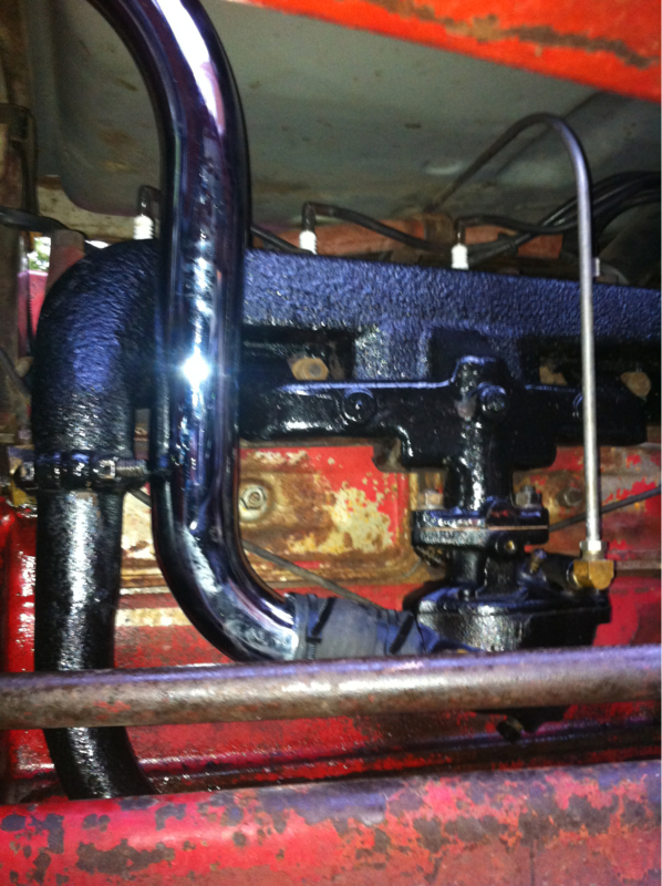

I think it is over drive all the way up, under drive in the middle, and normal drive all the way down. I just used it down by the lake and it is a really nice way to control pto hydraulic pump speed also.
Finally got an air intake tube and paint :)
   / Ford 8N Hi/Lo question #14
