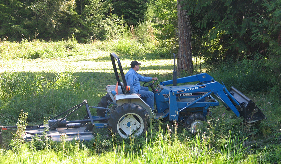

We have five acres in Washington State. Eleven years ago I bought a 1994 Ford 1720 with loader, plus a brush cutter, box scraper and auger. Several neighbors who own those foreign-made bright orange tractors have back hoes, so on the rare occasion when one is needed, it's easier to knock on a door than change out a heavy piece of equipment I've had to store. I have been very happy with the Ford. It's reliable, rugged, relatively rare, versatile and -- as a proud member of The Manual Gearbox Preservation Society -- it even allows me to shift for myself when I'm outstanding in my field.
