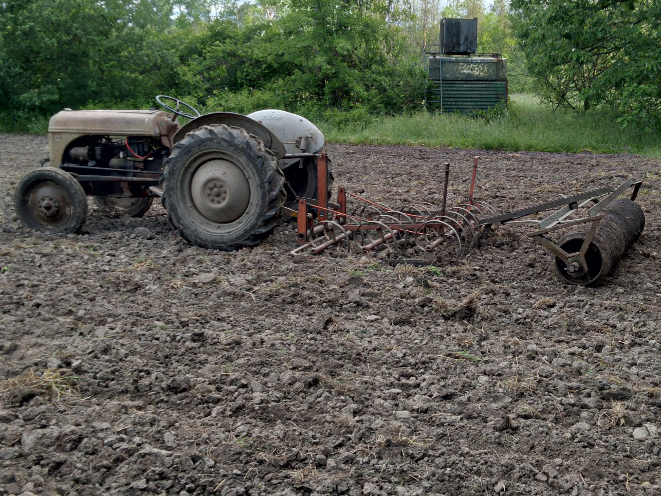

LOVE that shiny plow!! --- cant invision the tractor its hooked to actually pulling it!!! LOL!!
   / Ford 8N or similar older types #105
As long as there is no standing water, It always pulled that plow very well with calcium loaded rear tires. I am not sure how it will do after I replace the rims and mount unloaded ones. That might be the last 2 acres it plows. I will likely use my other tractor, that has larger, loaded rear tires, double the hp, and 4wd, on that plow from now on.
The only thing the bigger green one lacks is hydraulic draft control. My plow depth won't be as uniform as it always was with the old grey and red tractor. The larger 4wd is handy on wet years, when there is still some water holes in the fields. Those dont even slow it down with that little plow behind. It is cool watching the wakes roll off the moldboards, as I plow thru the standing water, in the low spots.
Unfortunatety, it looks like the 9n deal isn't going to happen. It is still parked out out by the road with a phone number on it, but the guy won't answer his phone, or the door when I knocked. My wife was also not thrilled with the idea of me dragging home an old non-runner.
I just ordered a new rear rim and tube for my 8n. I got a little vacation time planned over the 4th of July, so hopefully I can get that bad rear rim replaced by the time the corn needs spraying and cultivating.
Here are a few more action shots of the 8n at work this spring. In the other plowing shot, you can see a deer antler that almost took out my other rear tire. Fortunately, I spotted it before it punctured my left. The 8n also excels on that 3-point carryall and 2-row planter.

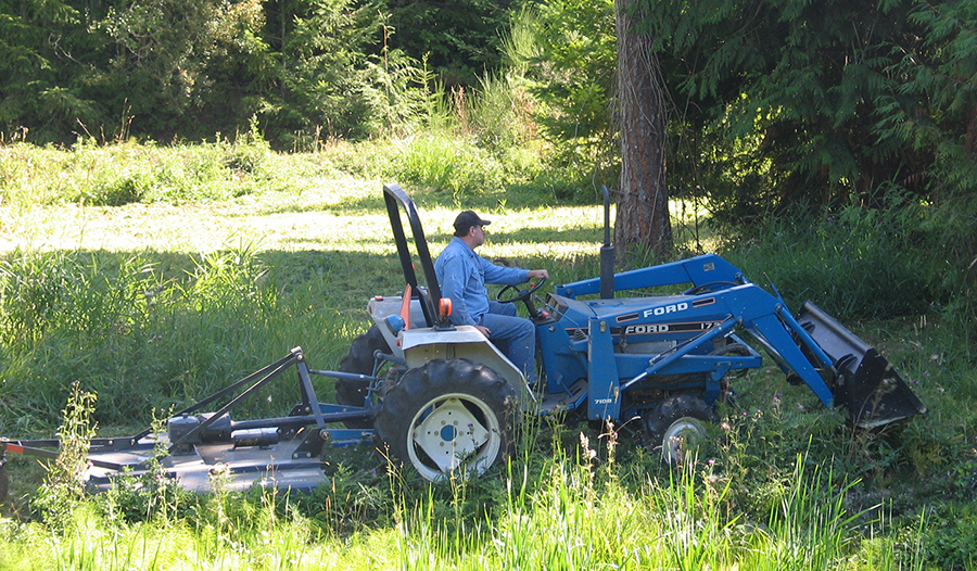

Is your 3500 gas or diesel ? I have ran both in that series, and I have no complaints from either. The gas ones start better in the winter, but the diesels are more efficient and a bit less maintenance worries. The diesels take a bigger battery to crank, and are harder on starters.
The rear hydraulics are very strong on them. I made a rear loader for my 2000 deisel, that worked great. No 2wd handicap at all with that, because you gained traction as you loaded the bucket. A boom pole on back, with a set of tongues, worked great for skidding logs with that tractor.
I made the rear loader, simply by hooking the boom pole to the top link position of a backwards pond scoop, and I made a couple lower link extensions from angle iron. My 8n could just barely lift the empty scoop, but the 2000 would lift it heaped full of manure, dirt, or stone.
My first job was working for an outfit that had (2) 3500-type Ford diesels with loaders (340B'S), a 3000 gas with the light front end, and a Case 580C, so I got real familiar with the operating and doing the maintenance. The overcenter boom made that Case backhoe nice compared to the Fords of that era.
Two idiosyncracies to watch out for on your 3500 are a plugged hydraulic inlet filter and a bad dash resistor. You will know that your inlet filter is plugged if you have to keep it topped above the normal full level, to make the lift arms work normally.
They can be ran for years that way with no harm done (dont ask how I know). The extra oil allows it to spill into the pump over the top, bypassing the plugged filter.
You will know your dash resistor is bad, if your fuel and temperature gauges start reading erratic. I changed out a few thermostats before I learned that lesson. The guy at the local Ford parts counter tipped me off, when I came in for my third one.
Funny you should ask. According to the numbers it started life as a diesel but someone swapped in a gas. I never knew just by looking at it that it wasn't original. I believe it was restored years ago and maybe got a repaint at that time. It runs so nice. Haven't got a chance to work it yet. Waiting on some implements. It would be nice to have a loader if it was easy to take take off. I've got many questions about ford loaders and my machine. Mind if I pm you?

You got power steering, live hydraulics, and a strong front end, all of which would make it a ton better than an 8n on a front loader. I would be thankfull to have found one that never had a front loader on it, because those that do, tend to have the crap pounded out of them.
I was helping a friend clear a building lot one time, and the track came off his Cat D3 dozer. He had to get the job done on time, so he finished it with his 340B 2wd Ford loader tractor. Watching him hit that solid packed, dry topsoil at high speed and using the tractor's momentum to chip away the dirt was painful to watch. I feel sorry to whoever ended with that tractor.
With your Case 580C, you got plenty of rear ballast for the front loader. I would never recommend a front loader for a light 2wd tractor, due to the traction issue. You would be much better served with a rear loader on that 3500, made from a TSC boom pole and pond scoop, and a couple 6 ft lengths of 4 " angle iron. That would be relatively inexpensive, less that $ 1000 total all in.
Besides the huge traction advantage the rear loader has on a 2wd tractor, getting it on and off is as fast as any 3 point implement. Any front loader you find will take hours to do that, cost you several thousand dollars, and hobble the tractor for most other jobs.
