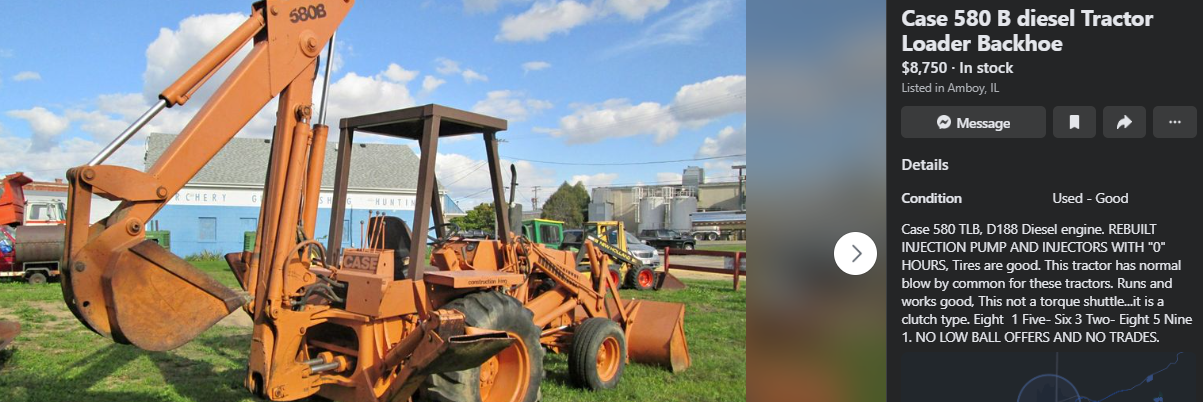

you need something like a Case 580 for what you are talking about
