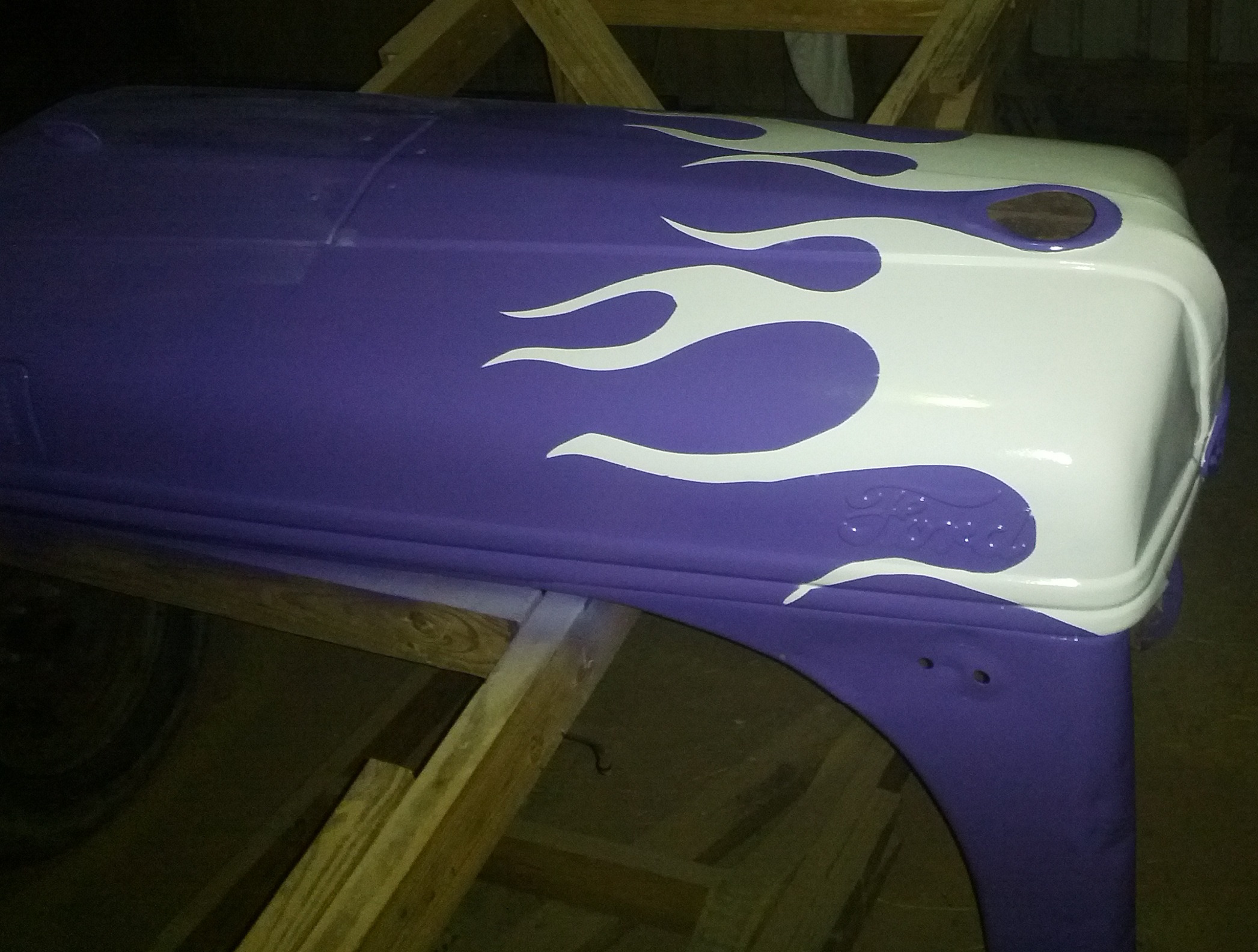

Update:
After
-2 bent studs
-6 broken studs
-2 broken drill bits in the stud holes
-1 broken tap in the stud hole
-5 dremel bits
-2 heli-coil repairs
-countless drill bits
-a mouth full of siphoned radiator fluid
and a month of an hour a night working on the beast, I have successfully replaced the header gasket, thermostat, and Exhaust Manifold Gaskets. She started right up on the first try. I even positively redirected my frustration on this project and put flames on the hood.
