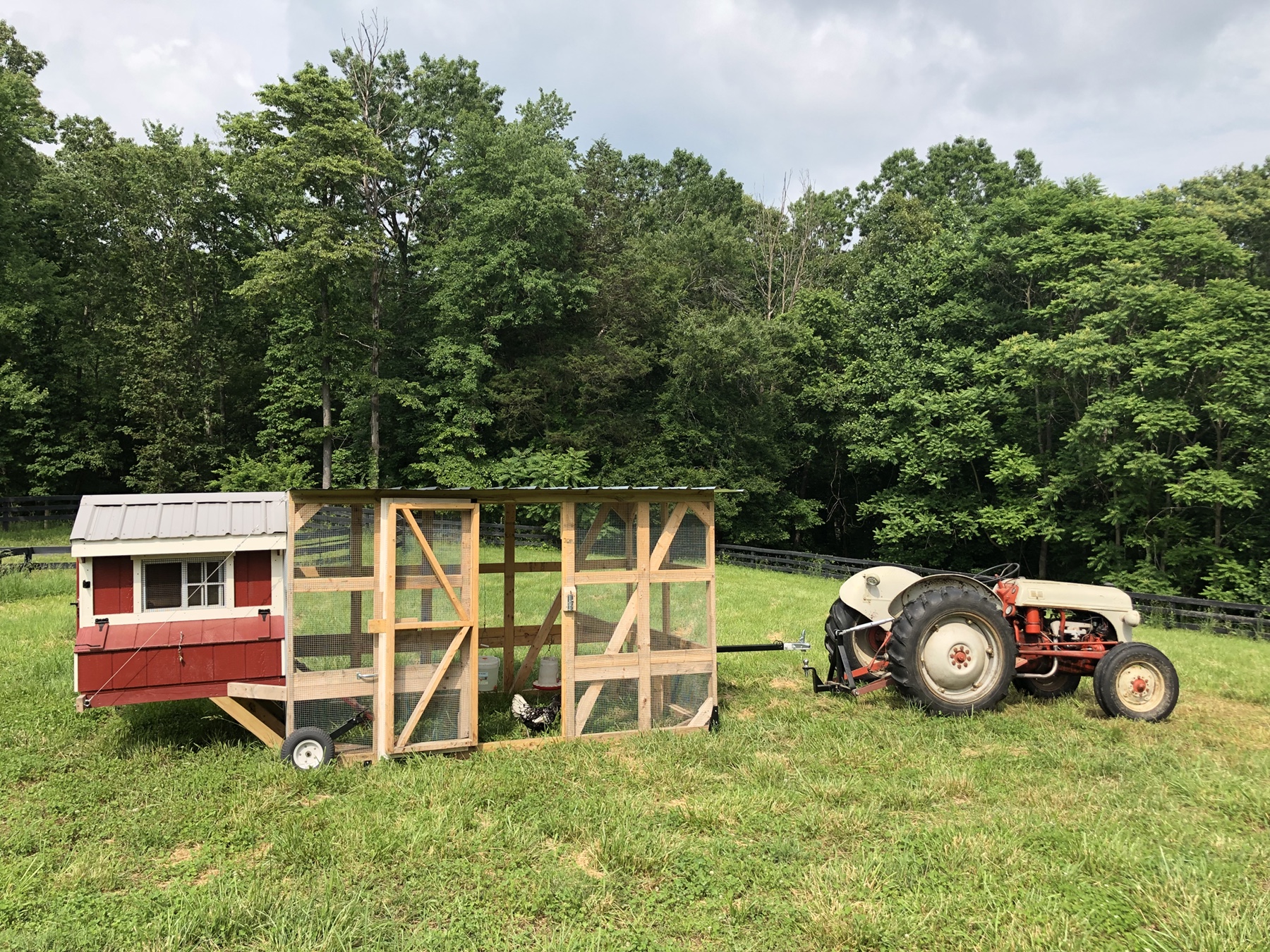

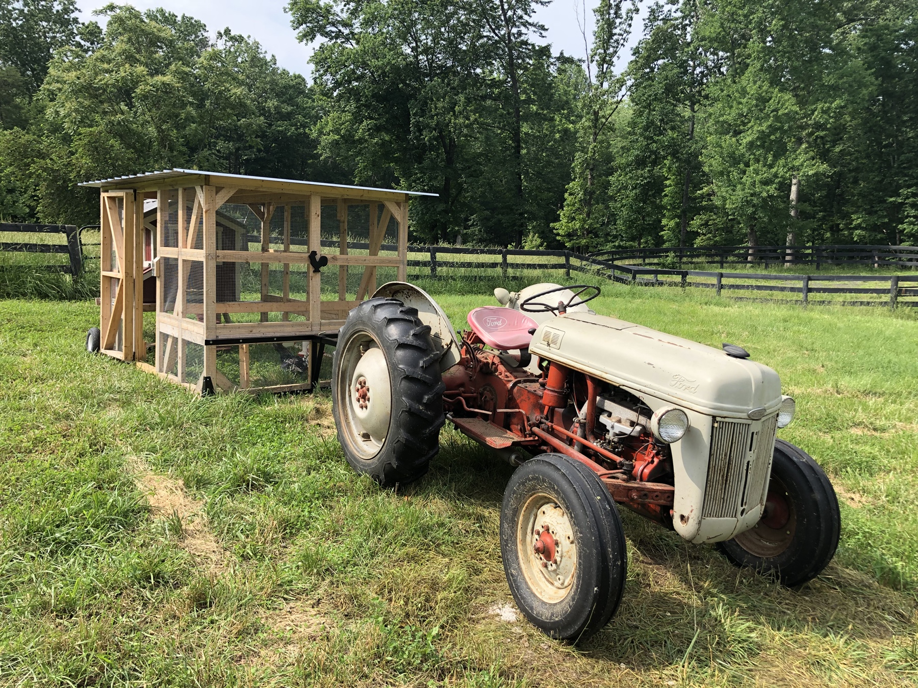

Here’s the 8N tractor pulling the chicken tractor....would also be an easier task with HST.
