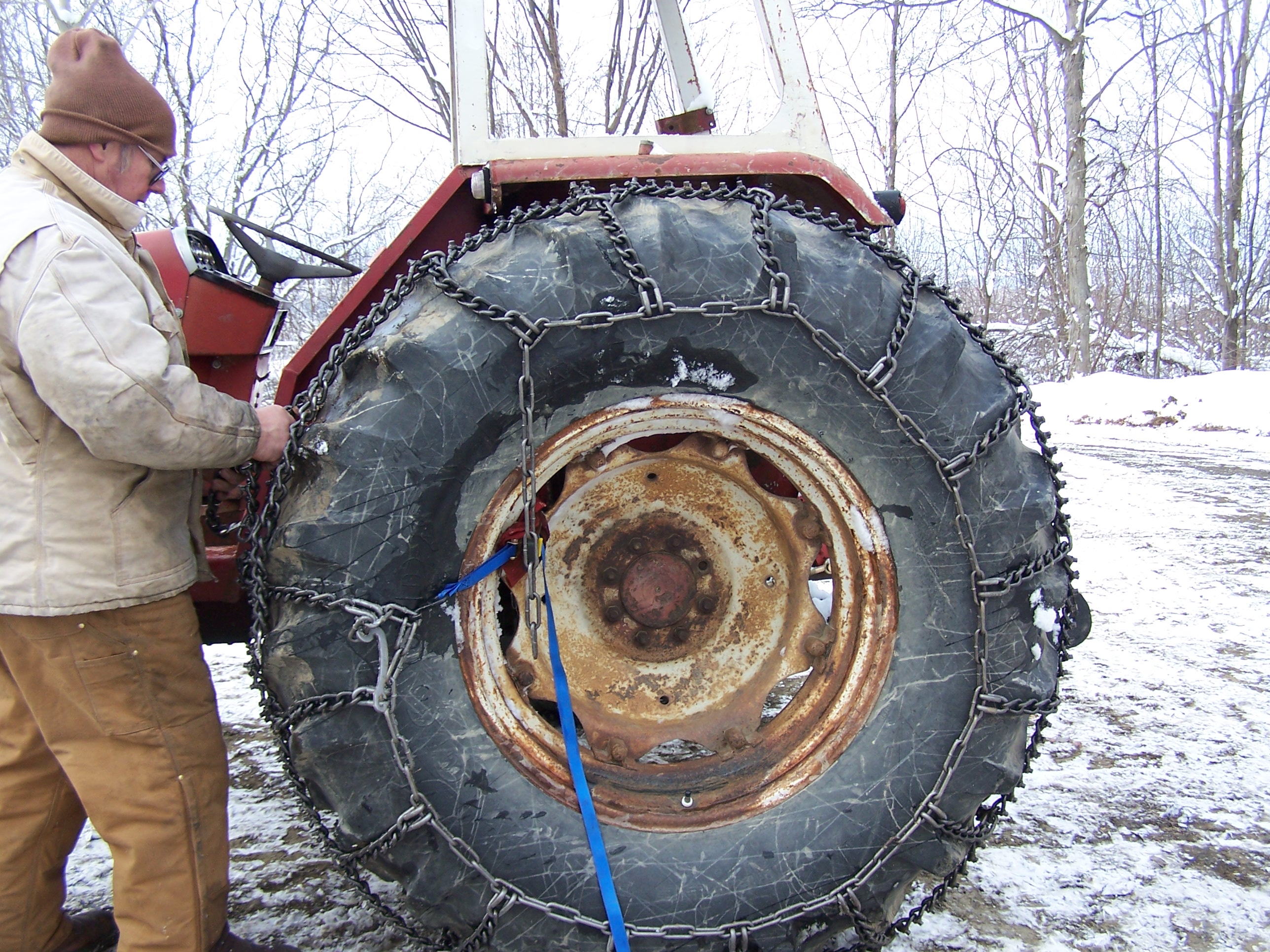

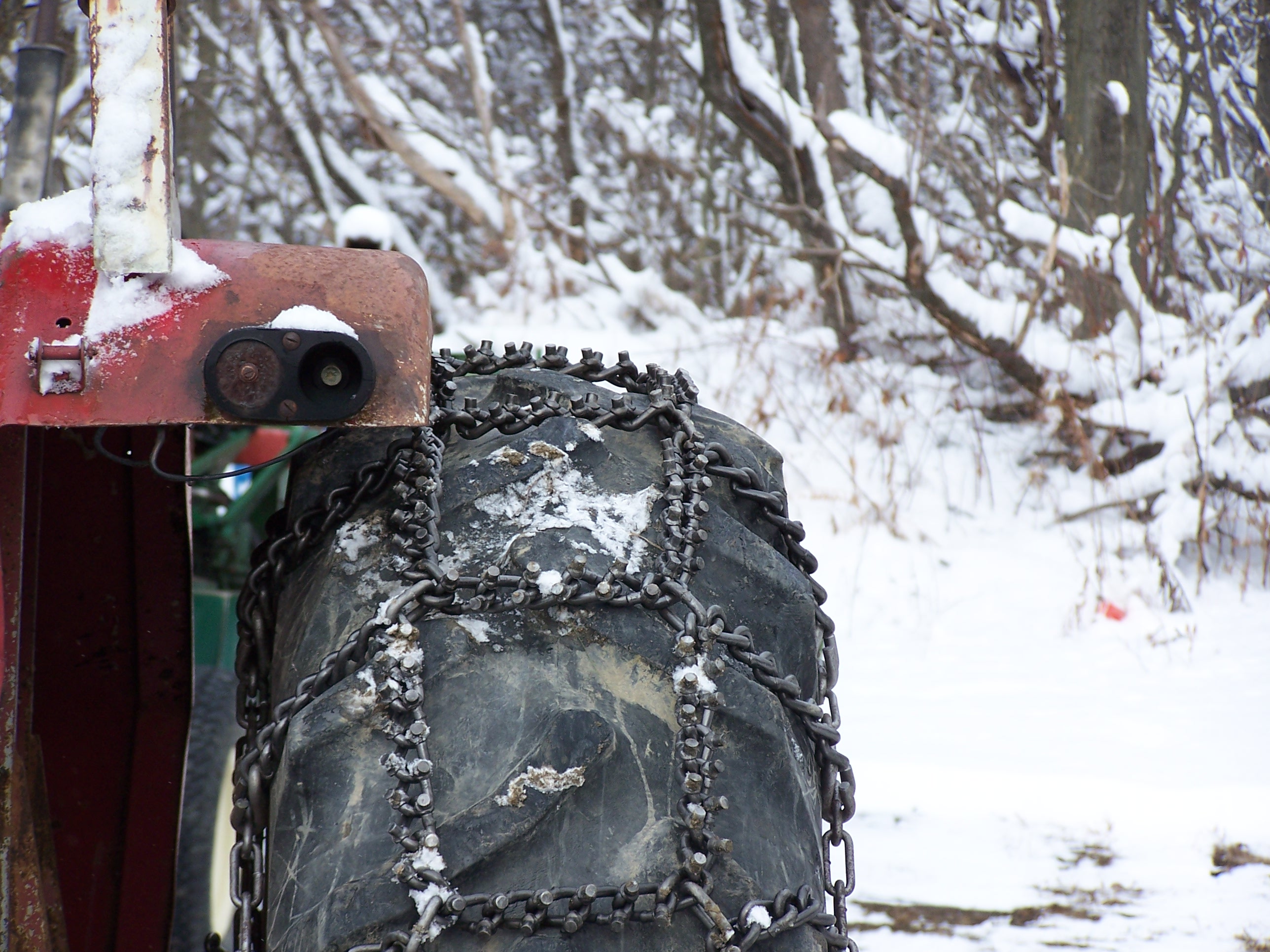

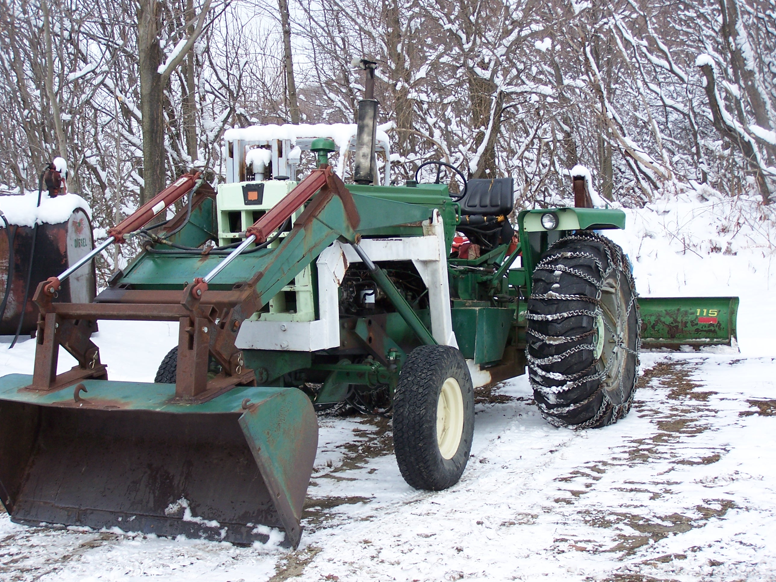

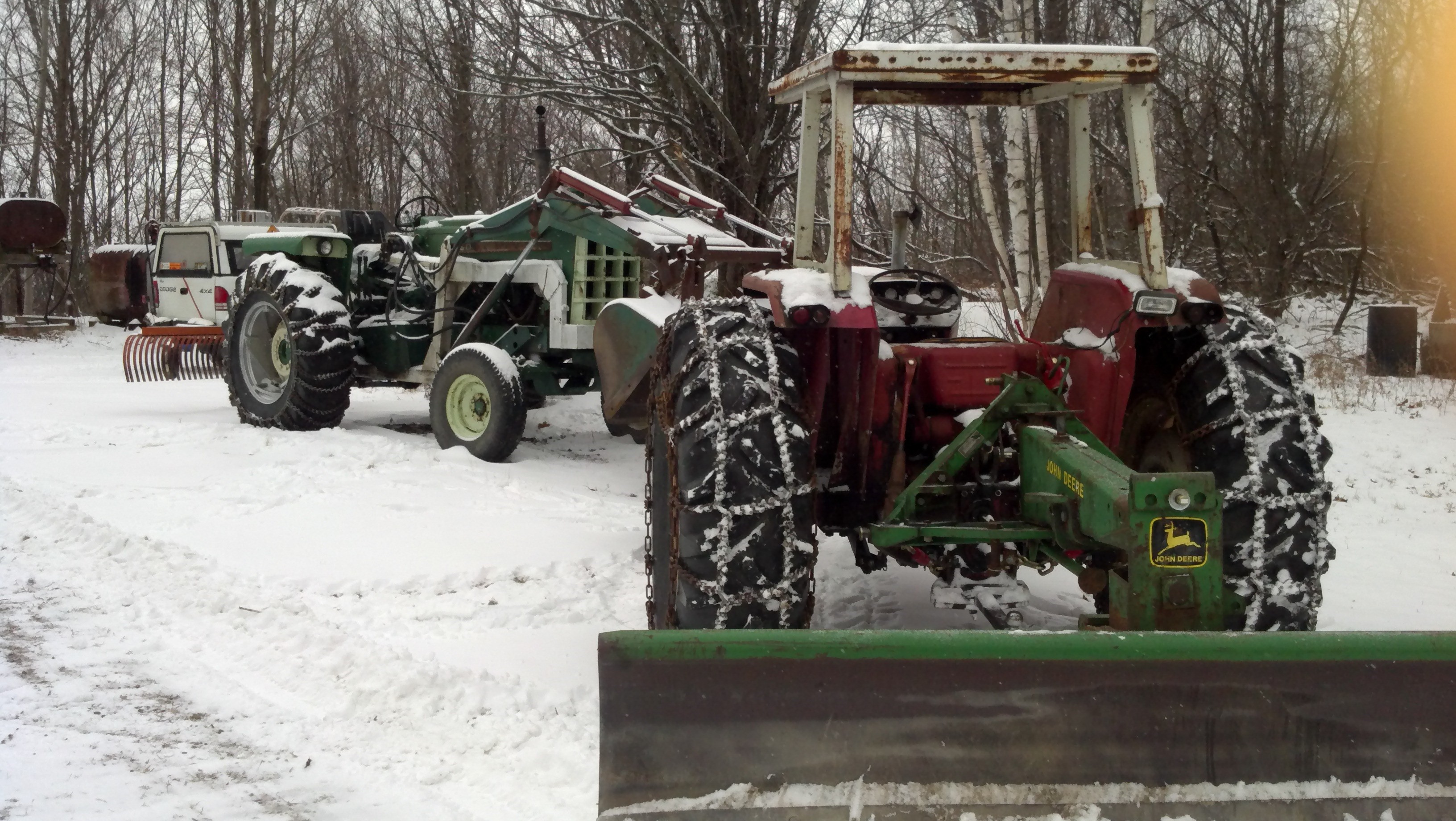

I used two wheel drive tractors for many years to move snow, some with filled tires some not.
Chains are what will make it work and the higher the quality of the chain the better they work.
The Euro style will work the best,several times as well as conventional.
The TRYGG's OFA's and Aguline.

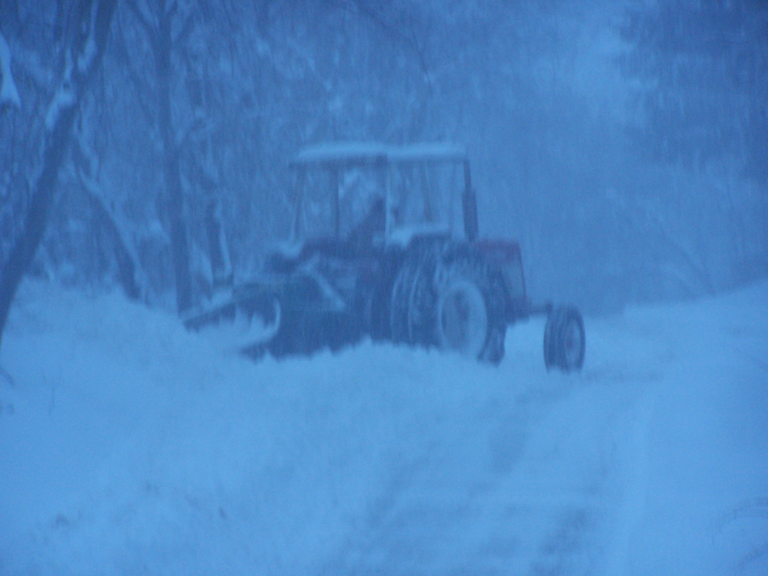

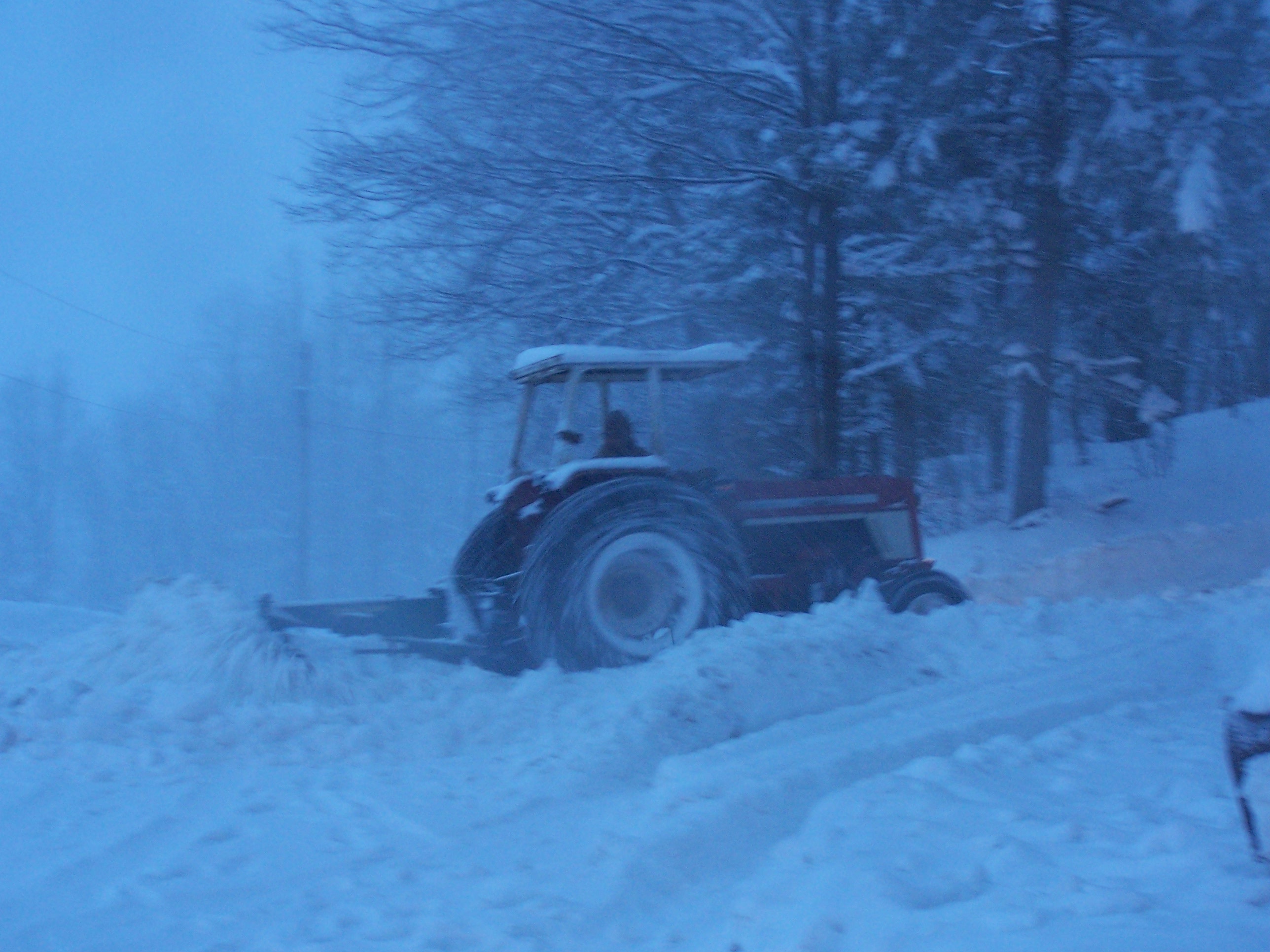

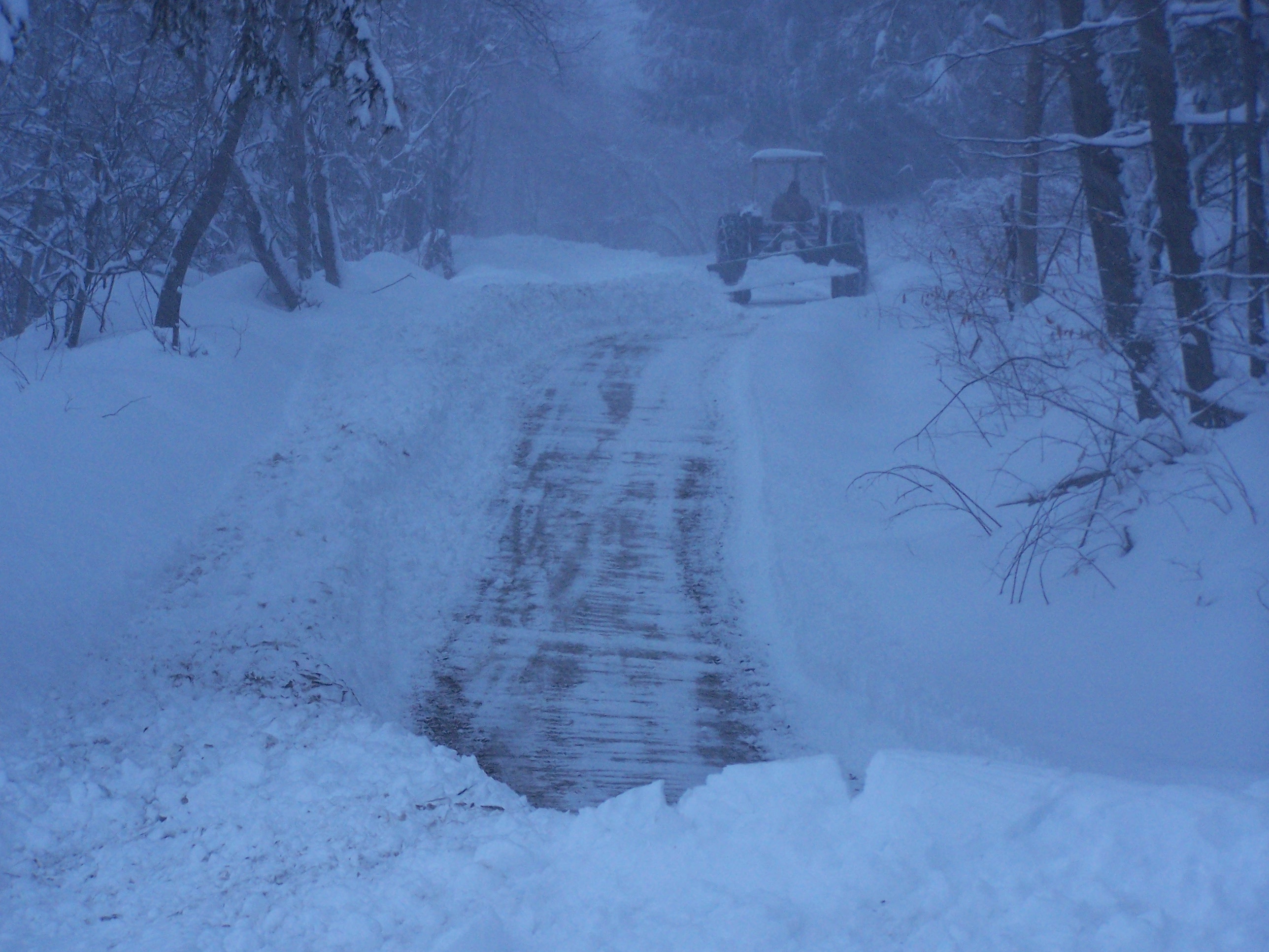

My tractors were a bit bigger then an 8N but the 574 is similar in that it is light those tire are not loaded and she hasn't any wheel weights either.

When you make up the ice and snow chains for your old 2wd vintage tractor put some thought into how to make some of the chain sit on top of the tire. A lot of automotive "H" pattern chains will drop between the tire lugs instead of sitting up on top of the lugs. The more chain that sits up, the better the traction gets. "X" pattern chains - often with a circular link in the center of the X - are especially good for traction.
