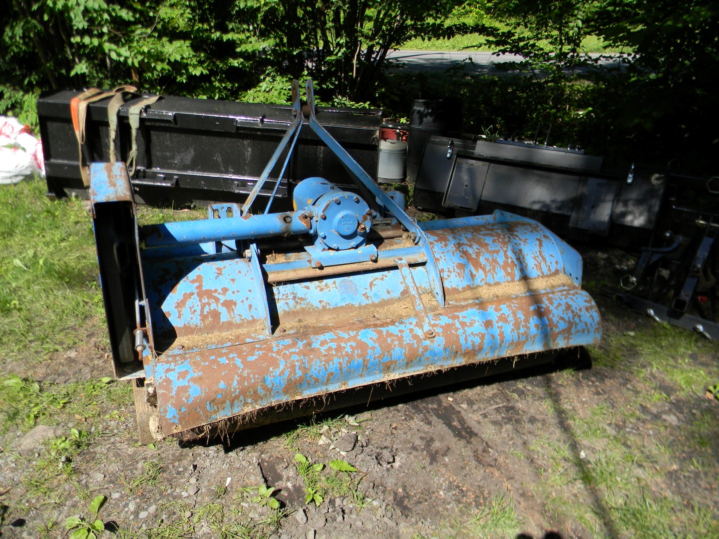

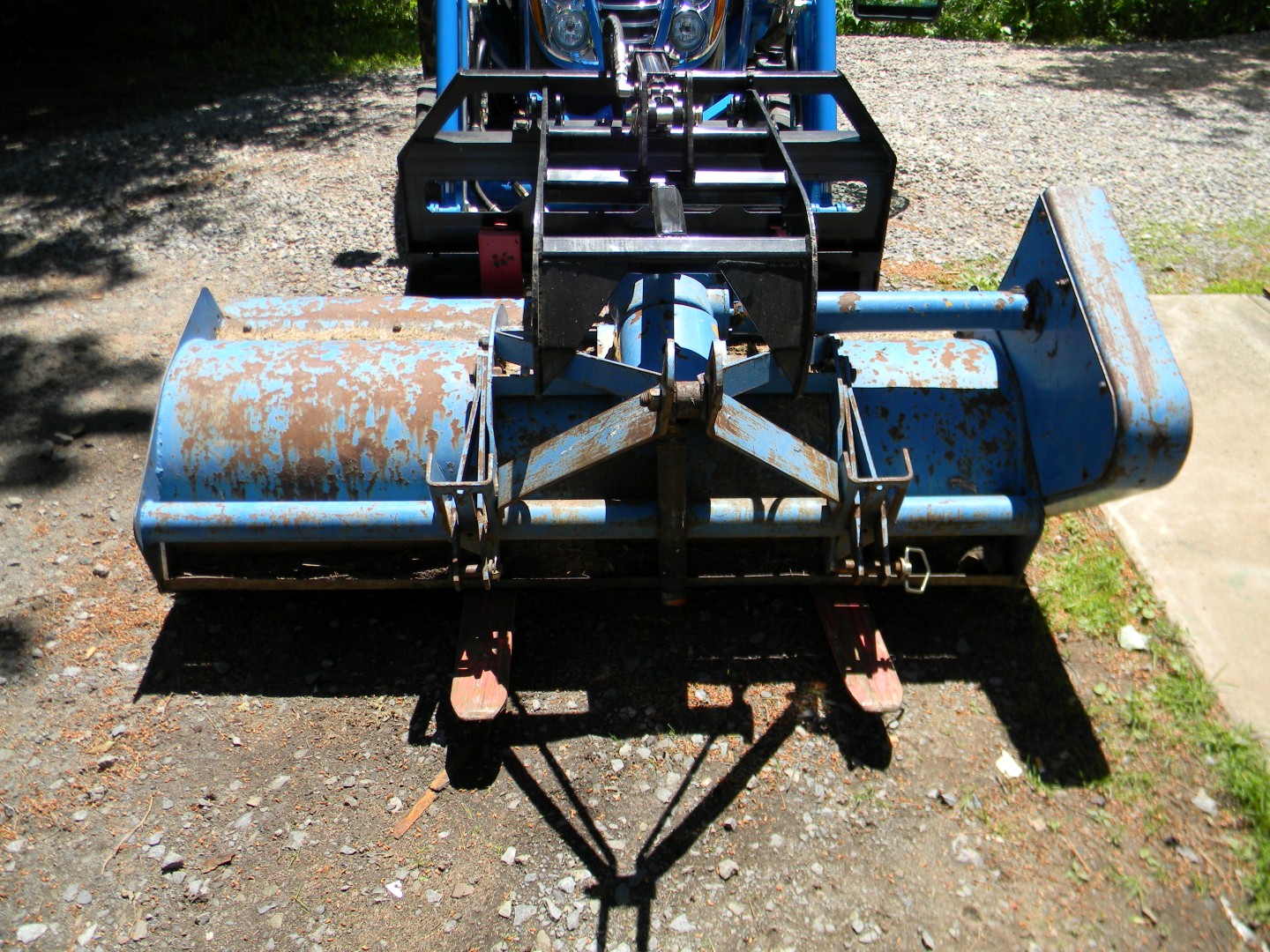

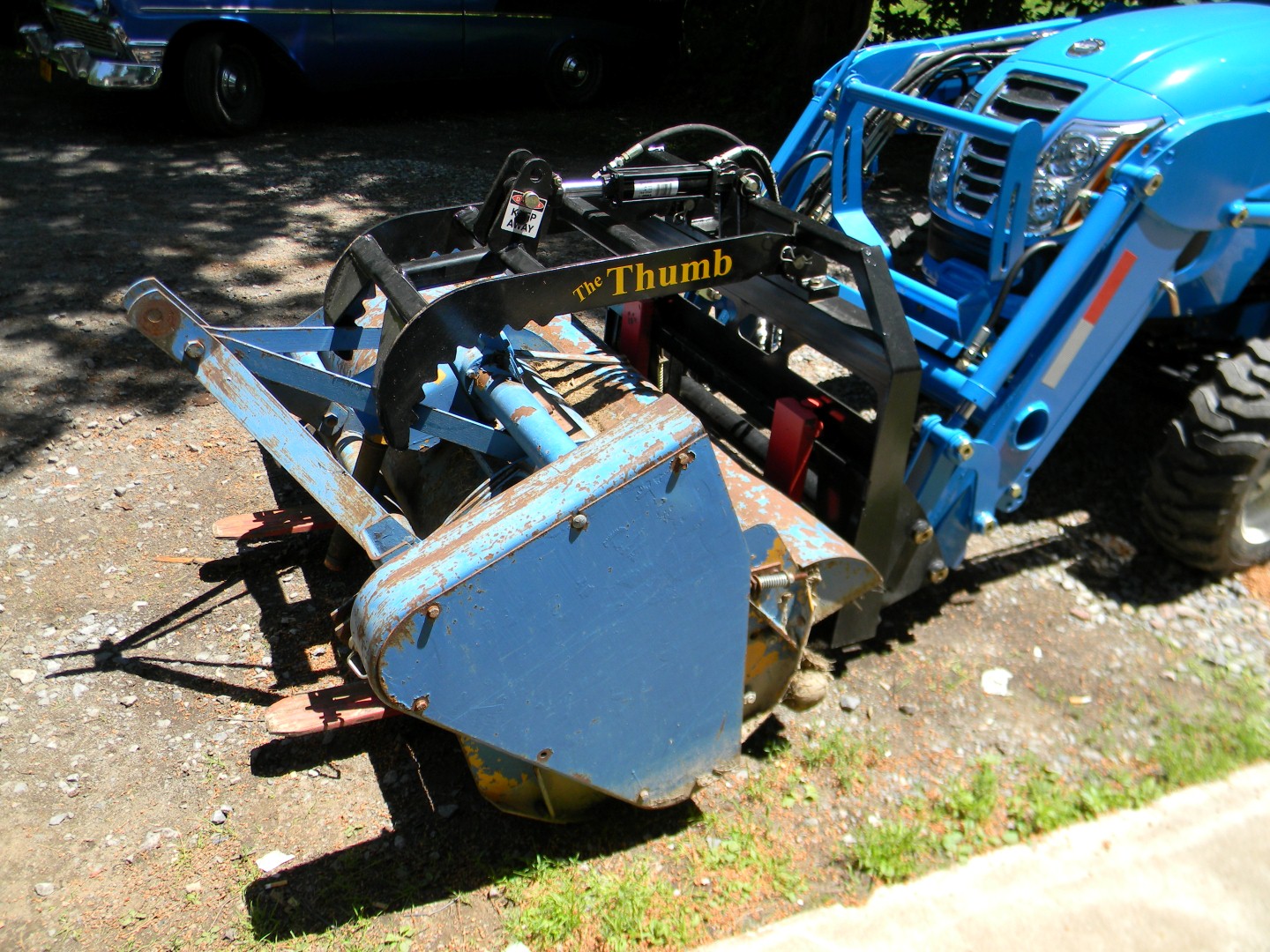

Thanks leonz. Here's a couple pics of the old brute. You can see the crack under the gearbox. Welding looks kinda scabby so I'm going to run some bolts through it in the spring. Thought I'd bolt a plate over the crack with 1/4-20 button heads which should allow clearance for the blades. The rear guard is missing and I may fabricate something simple if need be - is that the rear door you mentioned?
Just wondering if anyone else had seen similar damage?

If I had $2K burning a hole in my pocket I would have bought a used Alamo. I wanted a 6' centered flail cheap that was usable and had parts available. BTW Flail-Master has very little for the 907 but there are other sources including NH. Not looking to win any beauty contests just mow some weeds beside the road a couple times during the summer.
Thanks again
