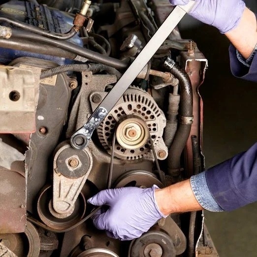

I’m interested in trying to adapt an automotive serpentine belt tensioner to my Ford 917, so that maybe an option for you.

Serpentine Belt Tensioner
