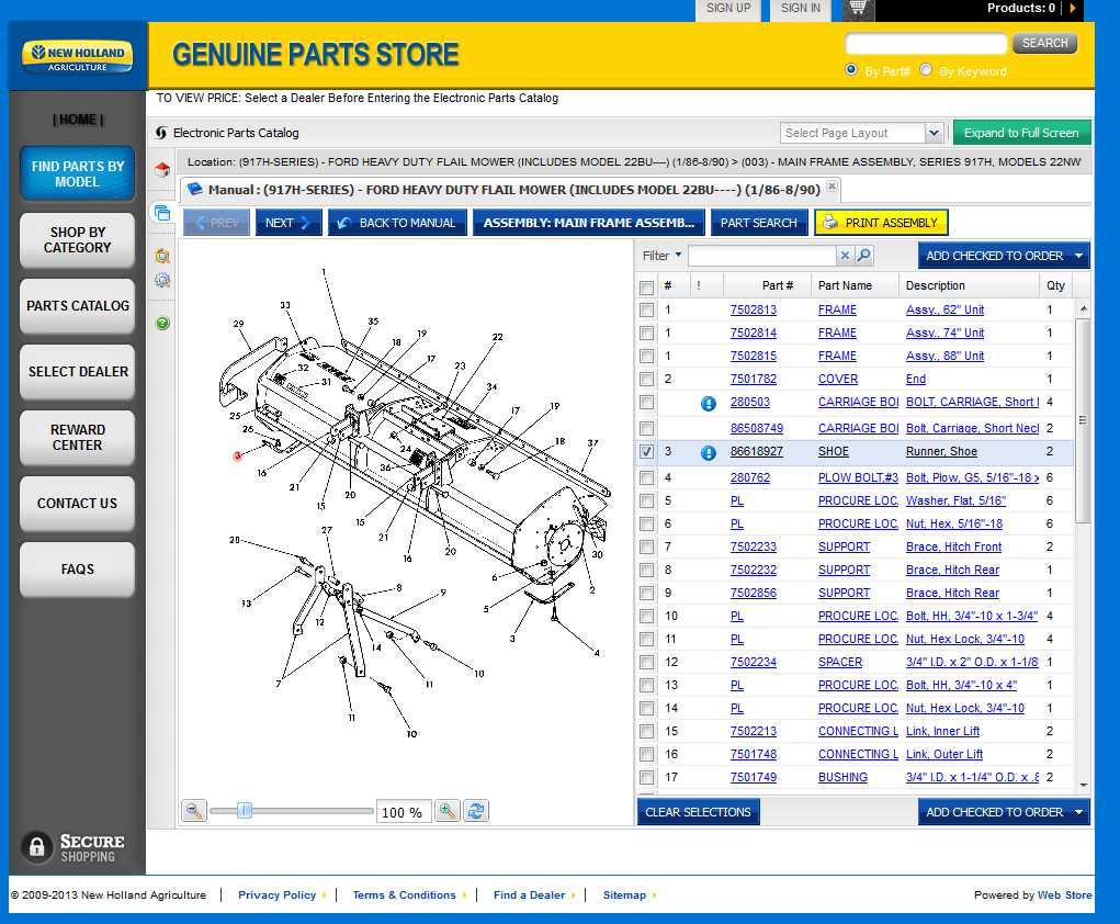

Thanks, I have gone to the New Holland site twice and the parts list will not load on my computer for some reason. Thought something was wrong with the web site but it may be my slow DSL. I believe it will be easier to just to fabricate some shoes than to order some.
That's probably what I'd do too. And here's a suggestion for the fabricator; turn up the skid nose a good inch from level (like a ski tip), then attach to the frame with plowshare bolts and NyLock nuts. Countersunk and beveled holes on the underside of the skids of course, to accommodate the plow bolt heads.

Again, follow the instructions I posted for the 917L parts list. They're clearly identified right down to quantity and part number(s). They're Ford/New Holland part numbers by the way, not Messicks.
//greg//

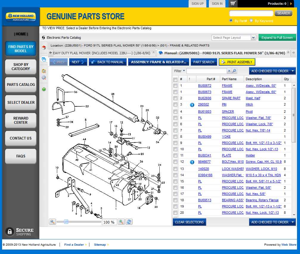

Upon further review the parts diagram you are referencing is for a 917H. I finally was able to access the New Holland site and the 50" 917L does not have skid rails.
I appreciate the assistance. Looking closely at the diagram, I began to realize there were some differences in my machine and the illustration such as hole placement and attachment points.

And you're exactly correct, I cannot explain why - when I clicked the 50" 917L pull down graphics - that the 917H diagram displayed instead. I simply didn't notice the "H" part. When I tried it this time,
the 917L
pulled down correctly. No skids. Sorry for the confusion.
