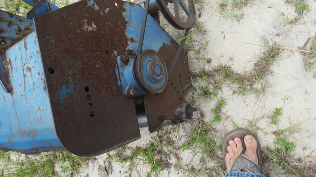

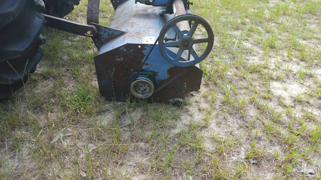

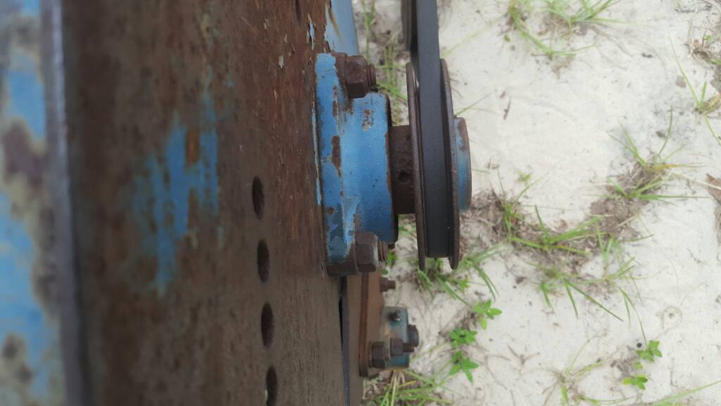

My 50" Ford 917L has a bad bearing on the belt side of the shaft. I unbolted the assembly and removed a small hex set screw that holds the pulley on the shaft. Is there something I'm missing to remove the pulley from the bearing and all? uploadfromtaptalk1465867033937.jpguploadfromtaptalk1465867041861.jpg I beat on it some, but nothing. put some PB blaster in the set screw hole, and leaving it sit. Do I just need a BFH? Also, I found on Messerinks the bearing, but it's $65, hoping to match size for less $$
   / Ford 917L shaft bearing #2
Check closely to make sure that's the only set screw. Lot of pulleys have 2. One on the key and another 90* from it. May also check inside the pulley groove. I would guess it'll be rusted real good (or bad) at the key and keyway on the shaft. Lots of soaking should turn it loose. Hope you can save your pulley they'e not cheap either. Also need to be soaking whatever is holding the shaft to the bearing.
So, after lots and lots heat, PB blaster and a Whole lot of a BFH, I got the bearing off. It appears I need 1.5" ID x 3.0" OD bearing; oh and a pulley with a 1.5" ID and a roughly similar OD to the orginal....

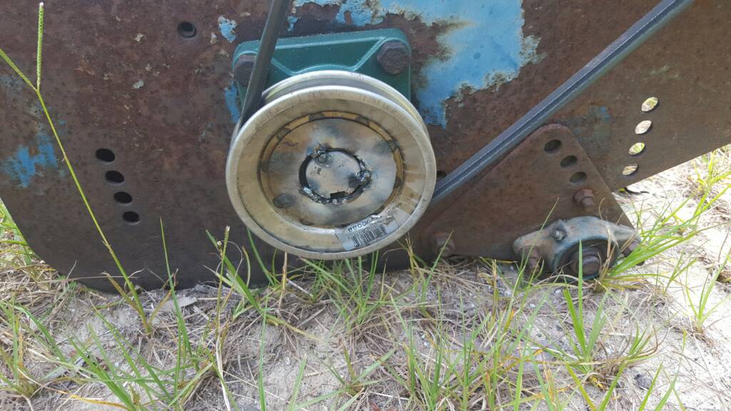

New bearing arrived yesterday, with 4 bolt flange and bolt holes matched perfectly. Bearing ID was correct, but I had to file, buff, grind, and polish shaft to get it on the end. Apparently it was either mushroomed when I was trying to remove pulley, or it was already mushroomed, and that's why I had to break the pulley of with the BFH.

So, the pulley I had to break to get off, costs $68... so, who knew a 1-3/8" bore, 5" diameter pulley was so dam expensive. Couldn't find one cheaper, so I grabbed a $12.99 pulley at TSC, welded a 1-3/8" collar to it, and then slid it on shaft, then tacked it in 3 places. Hopefully it holds up for a few years. $65 bearing and $68 pulley on a $150 mower. nah.
