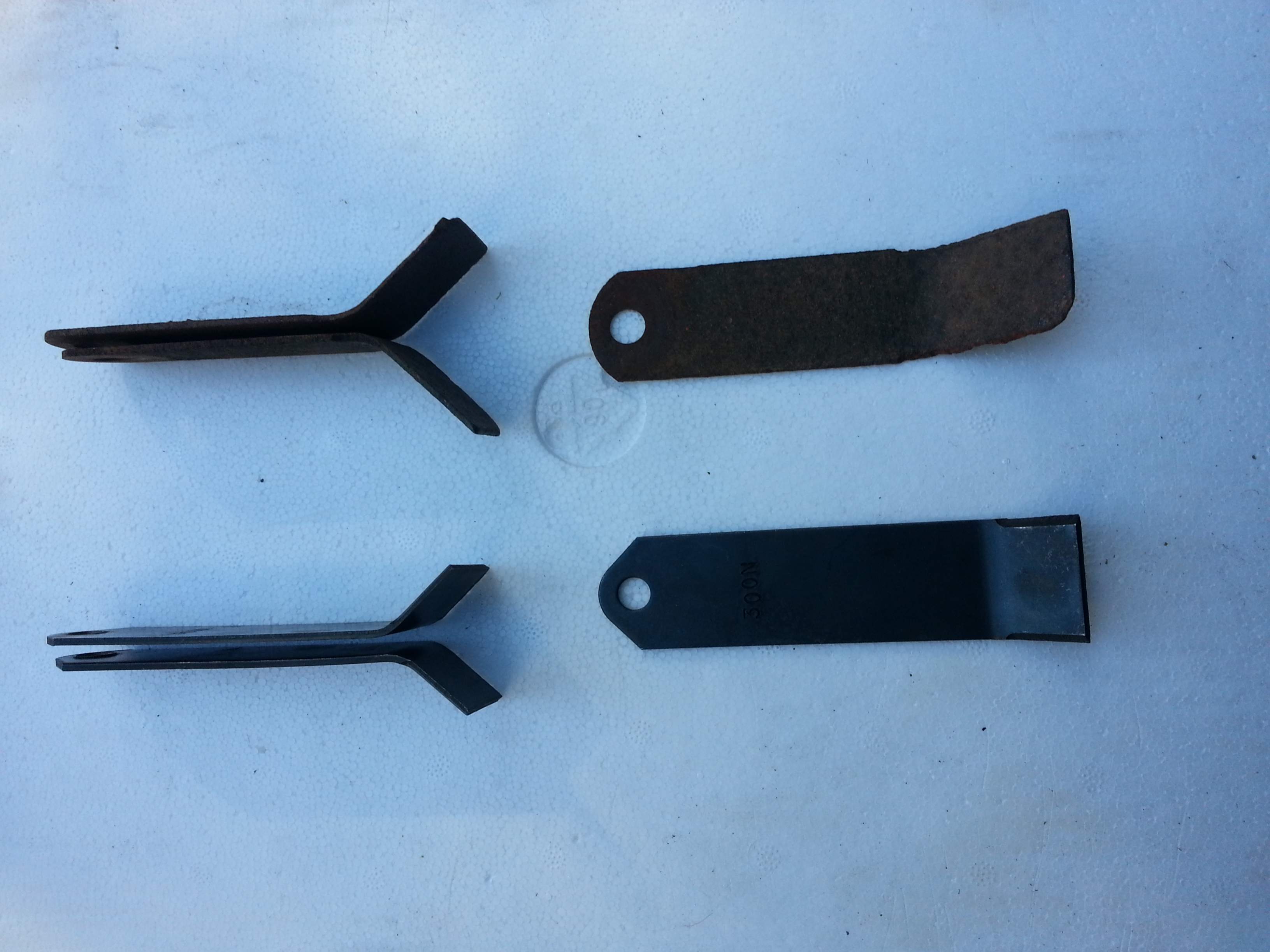

Ford vs. Mott / Alamo MH386 from Flail Master

My 6ft 907 has 33 stations. I was quoted roughly $7/knife delivered which feels expensive. it does not look like the Alamo knives have the same cutting width so I worry that there will be missed sections as the knives will not fully overlap. I found a company that has a hardened scoopstyle knife that would fit for roughly $4/knife delivered. Still seems expensive compared to what you were quoted though.

The Alamo knives are cutting very well in my 917L but since your 907 is using scoop knives they are totally different and prices should be different accordingly.
33 knives in 907 vs. 96 knives in 917L

ya the knives on it right now aren't true scoop, they are kind of a single piece that are nearly a "Y". the Scoops i have found have the same cutting width and dimensions so i figured they would be a suitable replacement. Do you have any experience with the scoop style? are they pretty good?

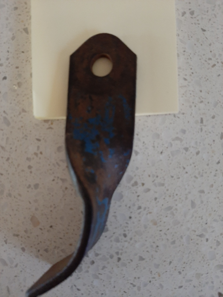

This is the type of knife/blade/flail (whatever you want to call it) on my machine. It takes 48 of these. They are 1 3/8" wide and therefore have a 3/32" overlap. I am waiting on a gearbox part to come from Messicks. Looking forward to seeing how the unit handles the heavier growth areas.
   / Ford 917L shaft bearing #30
Interesting - it looks kind of like a very lightweight "hammer flail"!
With a large oxy/acet torch etc. etc. tools you could probably twist MH-386 to similar shape if they are long enough, but hopefully you can buy the correct factory made ones at a reasonable price.
