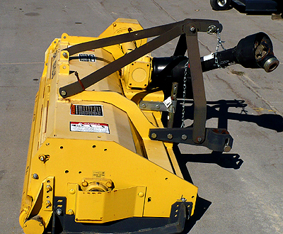

Nope. Seems the owner doesn't even know what model it is. I've got a 74 inch 917H. So I'm pretty sure that's the 88" model 917. But there's not enough detail in the photo to ascertain which sub-model (917, 917A, or 917H). The photo below is of a 918H.

Finally found out it's a 917 flail. It has some spots rusted through the sheet metal. Owner will take considerably less than asking price.
I assume you can't get sheet metal parts for them anymore, correct? If I could replace them, it might be worth a shot.
Owner said it still mows good-mechanically sound, but it was stored outside.

A visit to New Holland's website, and do a parts search for the 917 will yield good breakdown of parts and assembly. You're probably correct that sheet metal isn't available however most of the flat pieces can be sheared and/or bent by a local steel fab shop and easily cut to shape as needed drilled and mounted.
Flails, stirrups, and link's are available at flailmaster.com.
The I.D. plate if its readable, should have a number such as 22-xxx and will identify the individual mower model.

Not necessary. According to the NH parts website, the 88" frame assembly is part #7502524, the 88" rear guard assembly is #7502087, and the cut-to-fit rear deflector is #7502394
The parts system is pretty easy to use, but you can only get to it by first starting at an authorized dealer website.

I'm running a 917H, but only a 74 incher. The "H" is for heavy duty, the "L" is for light duty, and I'm not sure what the "A" represents. But it's exceeded my expectations, convincingly replacing both a 72" rotary cutter and an 84" finish mower. Got it at an equipment auction for $150, put about $400 into it, and saved myself from having to buy a new one up in the $5000-$6000 range. Sold the other two mowers for $1400 by the way. A net gain is pretty hard to come by in this economy.
The 917 was made for quite a few years - '73 to '86 I think - and had several variants: basic 917, -A model, -L model, and -H model. So you'll have to follow the advice about finding the tag, and determining which specific model you're considering. In my estimation, they're all somewhere between good and bullet proof. But it pays to know which specific variant you're going to be ordering parts for.

Judging by the length of the transmission output shaft, I'd speculate that's an 88" model 917. Not enough detail in the photo to determine if it's a 917H. Only way I can tell if it's the heavy duty version, is if there are two 3/8" pin holes above and below each lower lift point.

/ Ford 918? #17
You too would look beat - if you were parked out in the weather that long. I guess you don't realize how old these machines really are. If you want a better looking appearance, you have to shop New Holland (and of course pay accordingly). What you've been showing us are machines that were built before Ford even changed their name to NH. Pretty sure the last 917 flails were manufactured in 1985, the serial on mine suggests it was built in 1978
