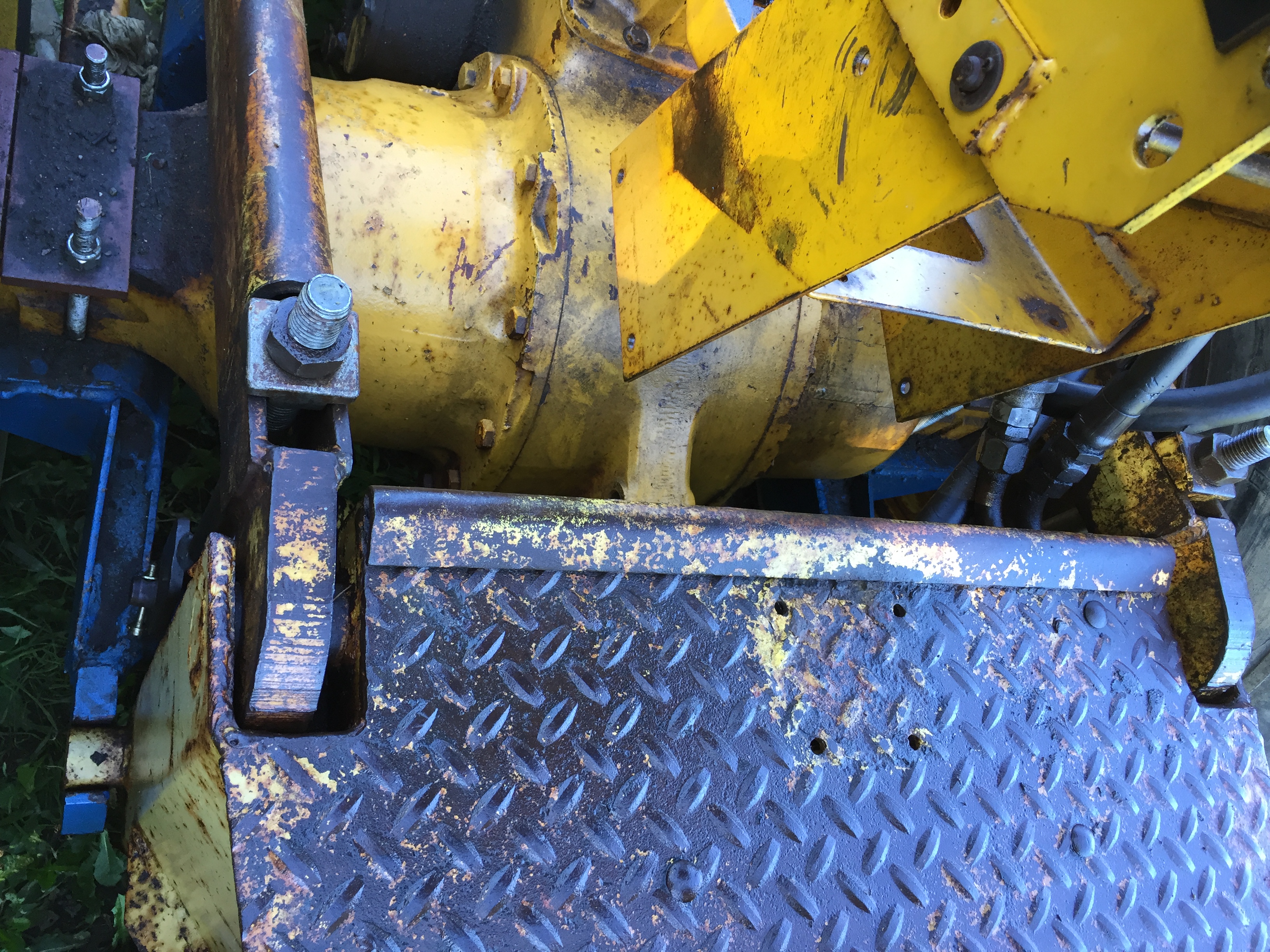

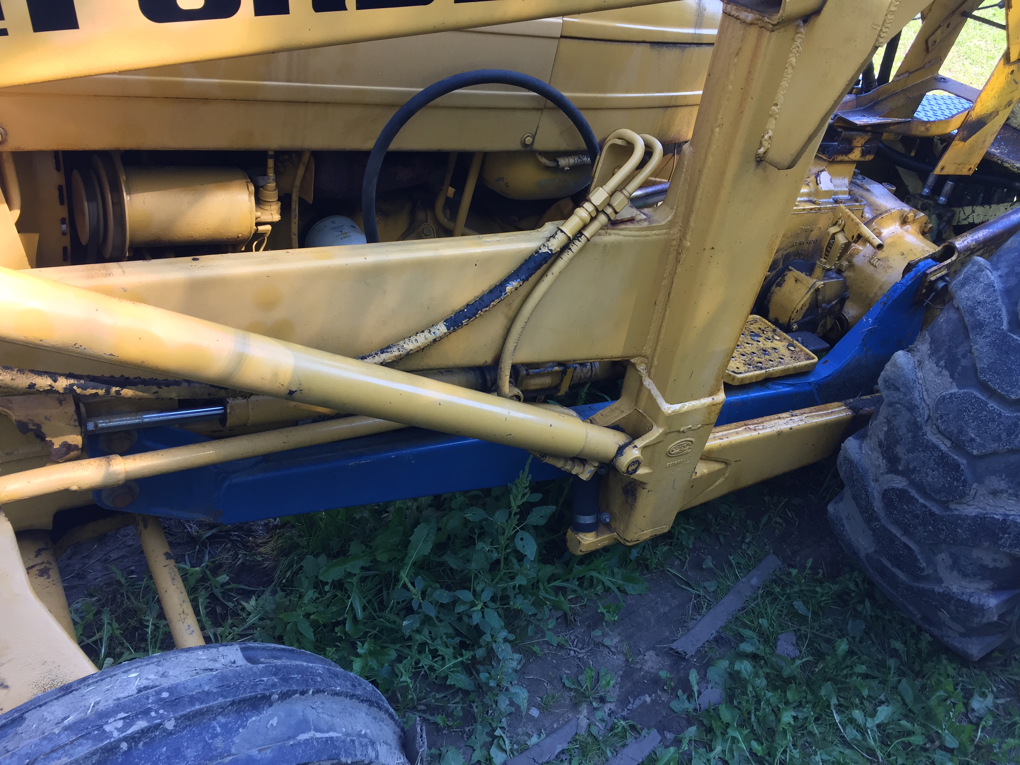

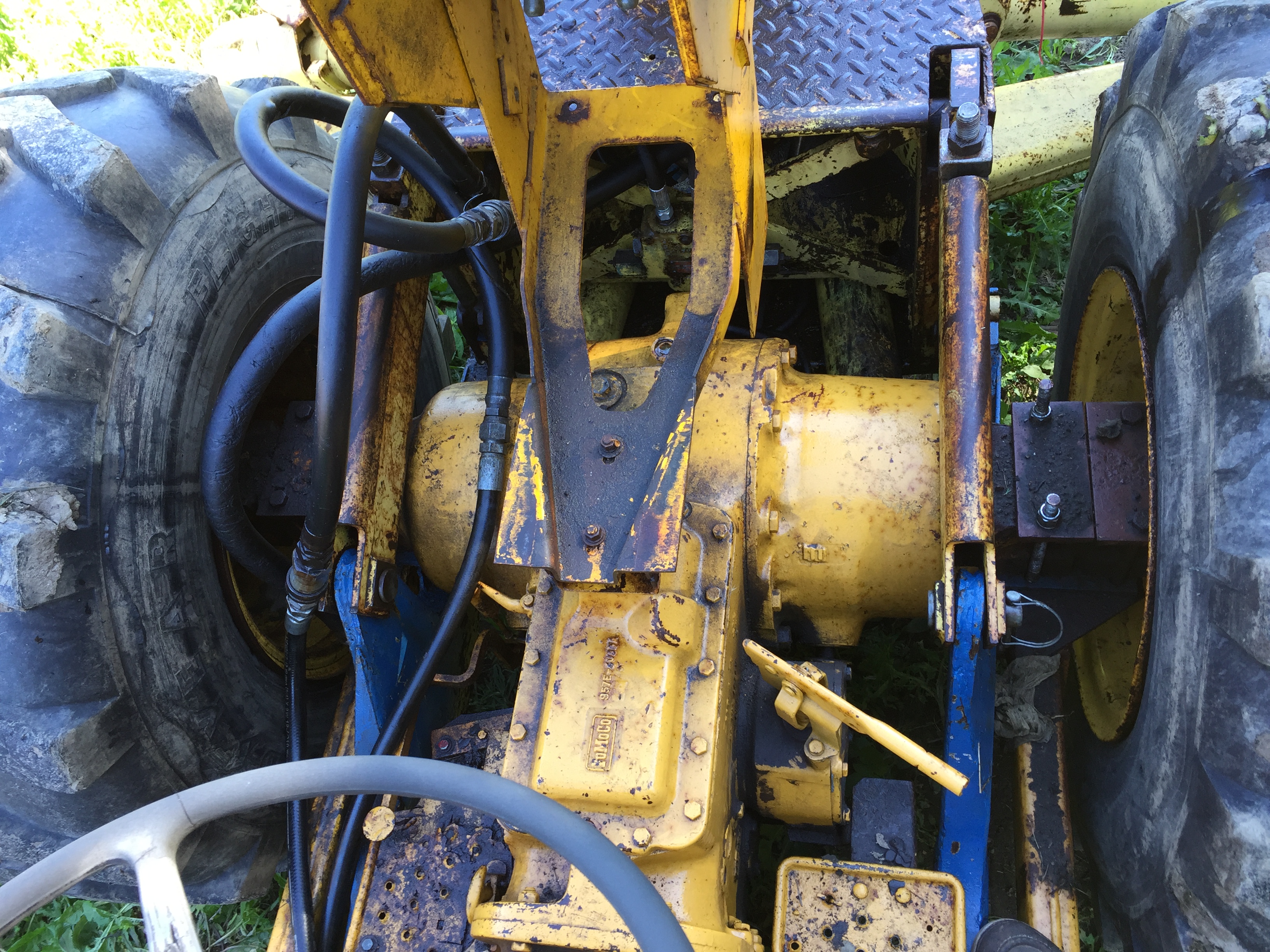

Here's some picture to answer a few questions that I've been asked. I took the pictures of my 4400. The brackets and arms for sale are exactly the same except in yellow.
1)The brackets run just behind the front axle to underneath the rear axle. They bolt to the ROP, fender or cab bolts.
2)The clamps/arms on top lock/hold the BH in position.
3)It's not bad putting them on, each bracket weighs about 175lbs or so.
4) I can have the BH off in 15min. by myself.
5) The attachment works with a 3ph but the lower lift arms must be removed.
6) $350 gets everything to mount the BH except the mounting bolts, 2 each side.
Thanks for the interest. Let me know if anyone else has anymore questions.
Andy
