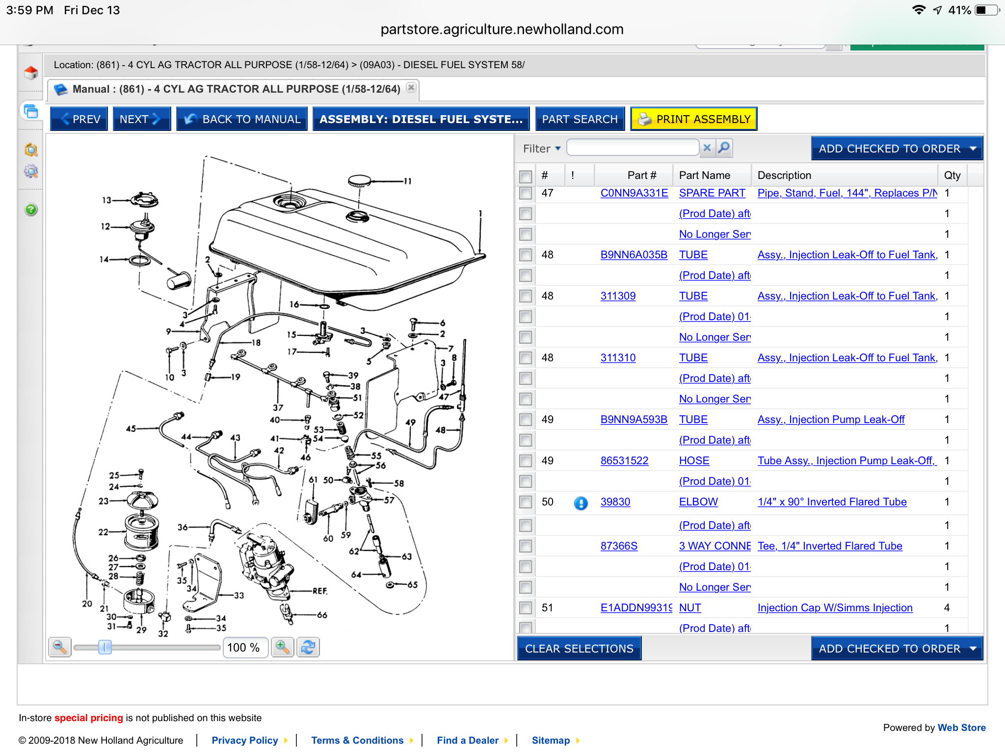

Hey RickB, this one has a return line for the injectors running from the head to the front of the tank. It doesn't look like the pump return goes there unless it attaches to the head somewhere. This thing has a weird injector system. It looks like they screw in from the inside or something. They almost looks like they're welded in. The injectors have no return on the top, just a line coming out of the head running to the tank.
Thepumpguysc and LouNY, I ran it for about a minute on either with a return line running up to the tank.
Nothing happening so far, although there is fuel coming out the return line.
Unfortunately the parts for my 4500 are supposed to be in today so this one is going on the back burner. When I get back to it I'll hook a chain to it and drag it a bit. Hopefully that will do the trick.
Thanks for the help guys!
I'll let you all know how it goes.
John
   / ford diesel injector pump shutoff question #15
See references #49 and #50 in the attached schematic.
Edit: the illustration is valid for all Ford tractors equipped with 4 cylinder 144cu.in or 172cu.in Diesel engines.
