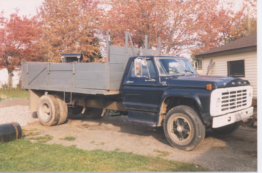

I wondered about that when I saw your pics: there's a lot of body overhang behind the hinge that could interfere with the trailer. Like Duffster says, can you shorten the overhang? Years ago I had a similar setup on an F750 (27,500 lbs. GVW). Notice the rear overhang...I wouldn't want it any longer than that.

The mill where you intend to haul to, would you be dumping the logs or would they be picking them off with a loader and grapple? That overhang would be good for dumping because once the load slid to the ground, you could drive forward and ease it to the ground without breaking the tailights.
Maybe some kind of latch could be fabbed up to keep the dump body from rising? Other than that, I don't see shortening the body as a viable option unless you could do it yourself.
