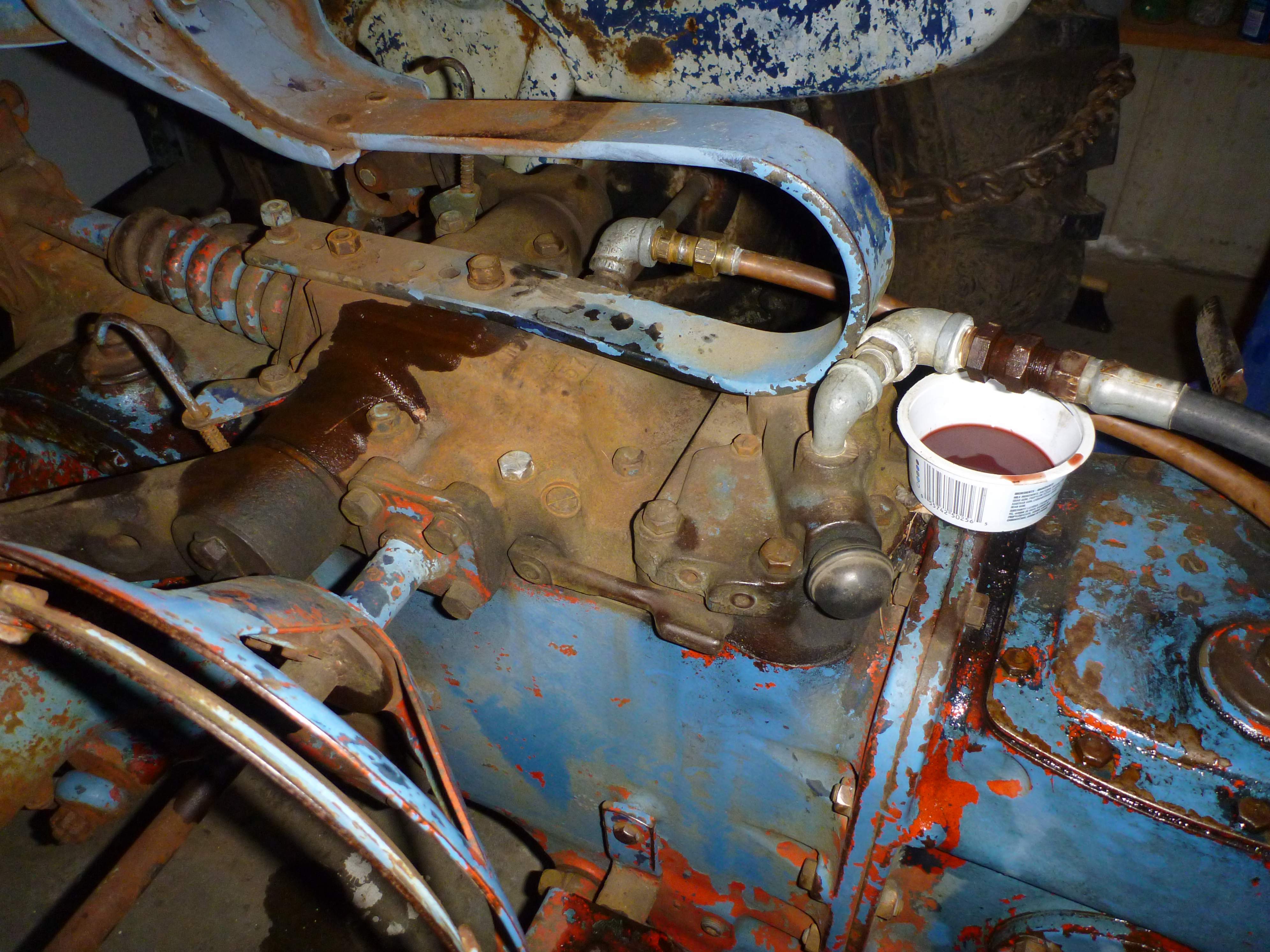

that fitting in the hyds fill cap is a RETURN from some other hyds function.. when you opent he cap you will lkely find NOTHING under it. it's a way to return fluid there
and yes.. the person wo told you it was common sump was DEAD wrong.
the 39 to 52 N series was common sump.
the 53-64 hundredand early thou series were 3 sump.
the 65+ machines had a trans sump, and hyds and diffy were common.

"soundguy" talks of a third "fill" under the left of the seat....for the all important hydraulics....this did not sound familiar. I just went and looked...Oh boy!!
Now I do recognize it as a fill plug, just like the other two....except... it has a pipe plug elbow dead centre that connects to copper pipe that runs to the front hydraulic lifts. It is very "Rube Goldberg"ish. So...it appears the only way to remove this plug is to first disconnect the piping and what will it be connected to inside?? Is there no other way to get the fluid to the hydraulics. Another Ford tractor person just down the road also thought these tractors have a common "link" (hole??) between the reservoirs to keeep the levels the same. He is wrong??

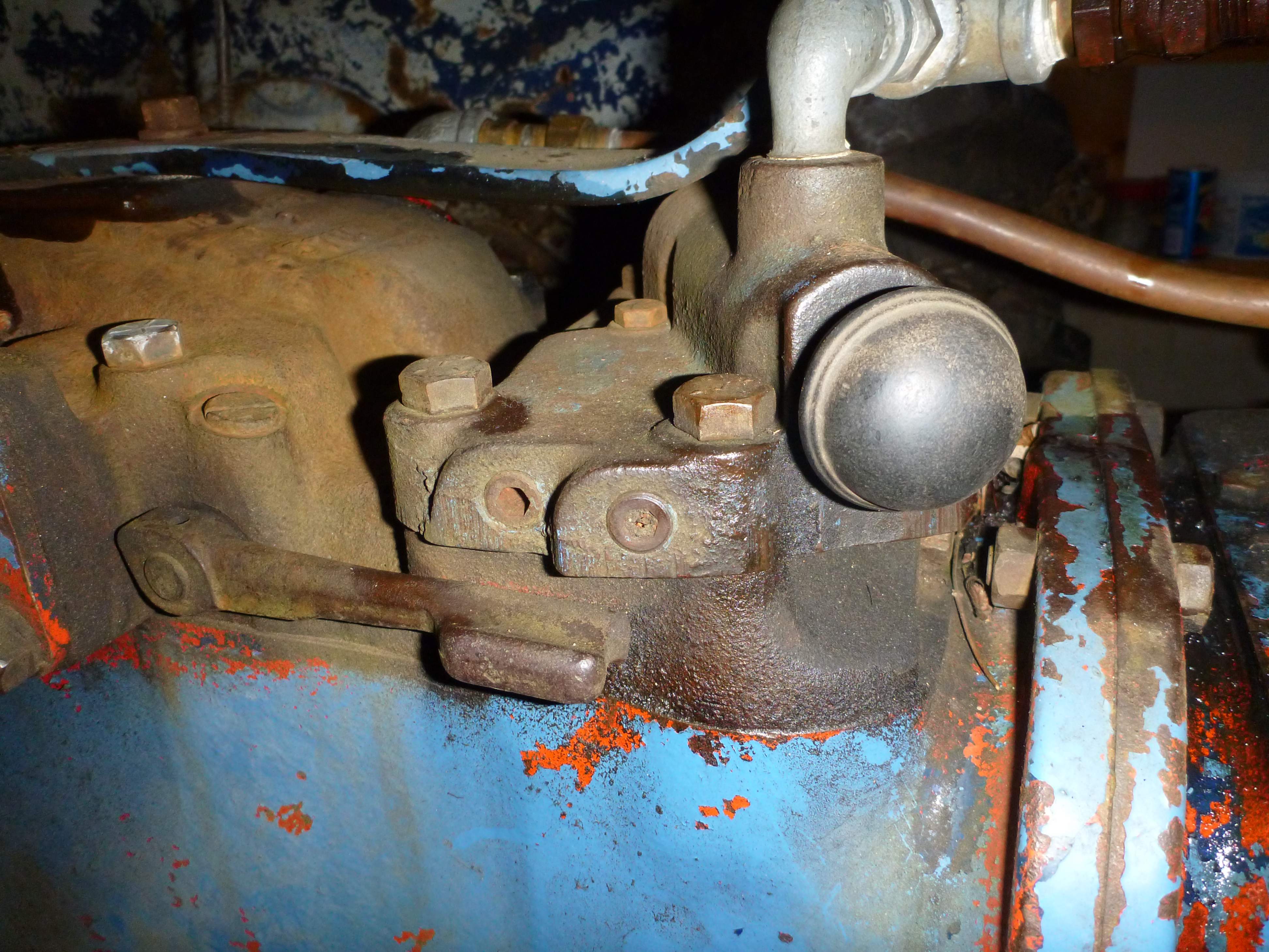

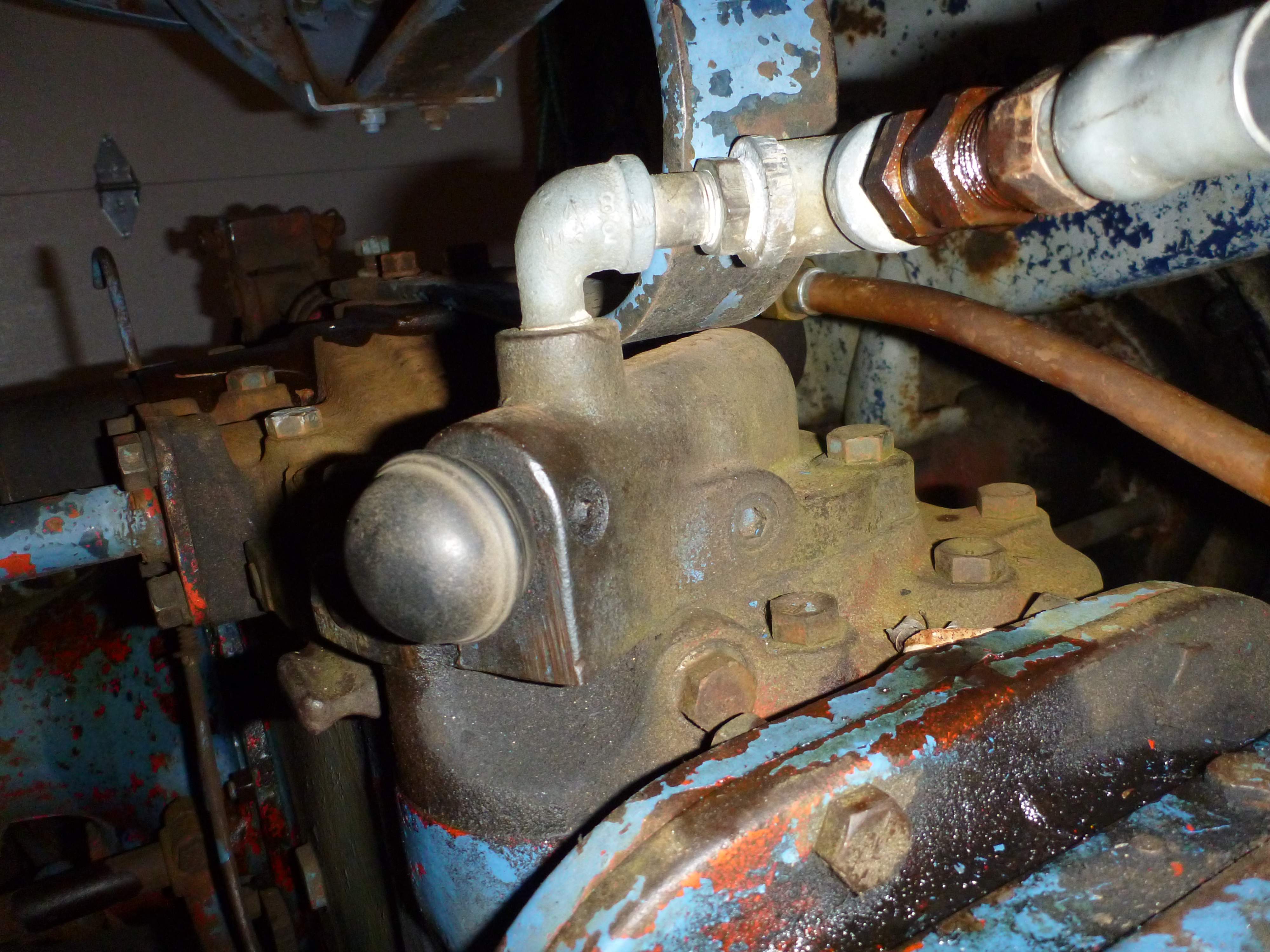

you have an aico hyd valve on the top cover.. if it is a diverter valve.. ensure it is not diverted.. if it is.. you will have no 3pt.
also.. i'd bleed the pump by pulling out the pipe plug in the top front of the head on the pump. whether or not he's a good tractor guy in general.. i can't say. all i can say is he doesn't know fords of that era...

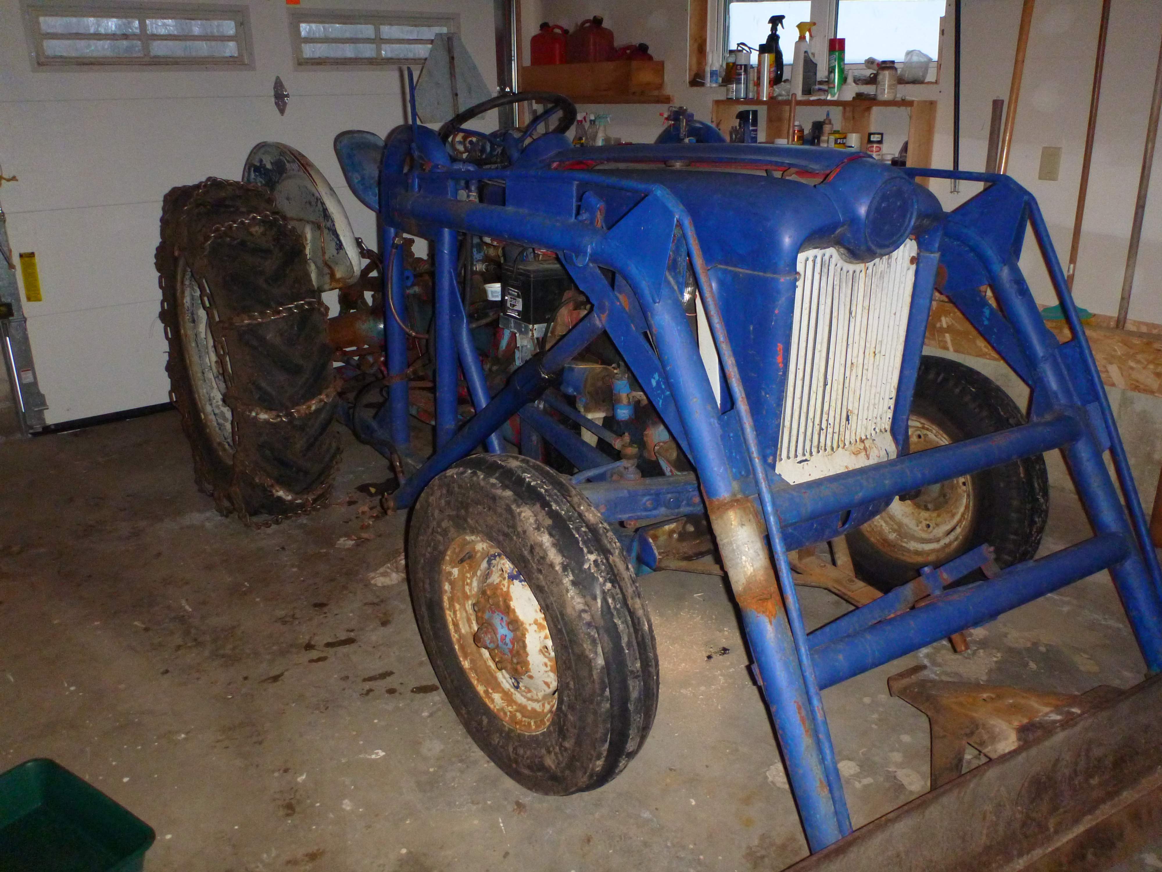

I located a number at bottom right of motor ...# 310905

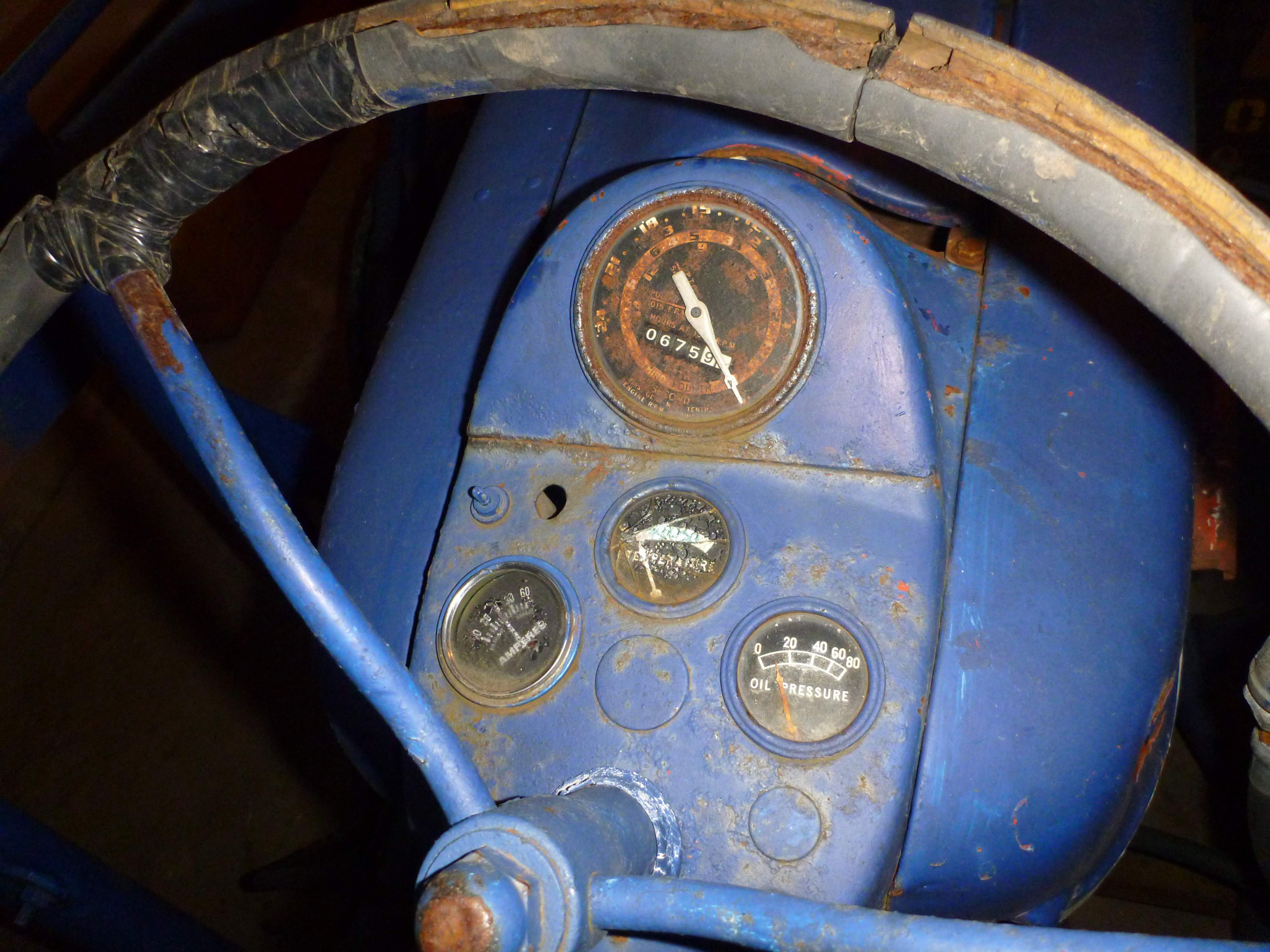

there is a speedo, ammeter, temp guage and oil pressure guage. The only one that works is the oil pressure guage. there is an empty hole that may have once held a red light. This old thing has been out in the weather, not even a tarp for the last 40 years. P1030249.jpgP1030250.jpgP1030251.jpgP1030252.jpgP1030253.jpgP1030254.jpg

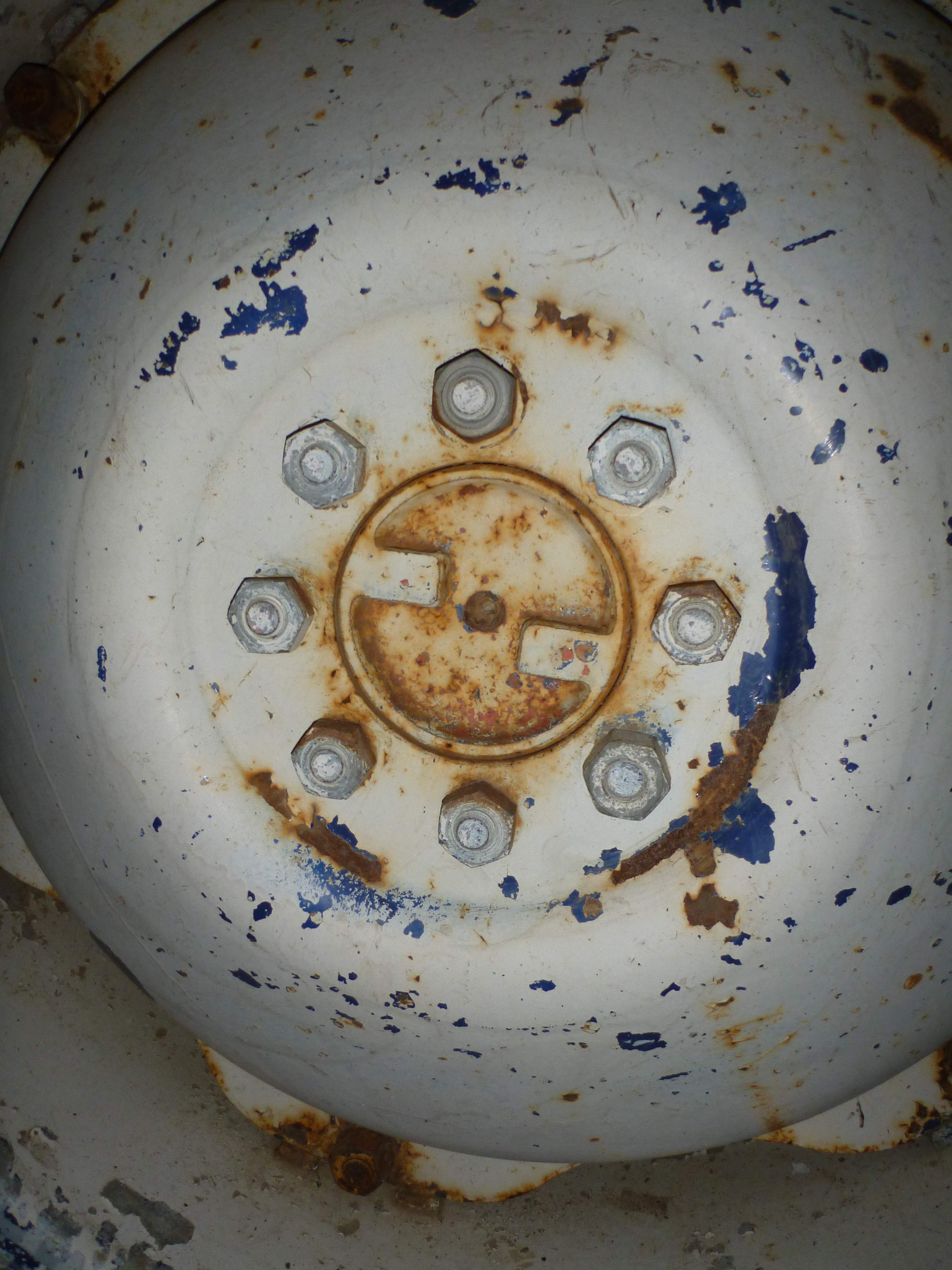

The rear hubs are not smooth they have a raised 1/4 x2 inch offset part, rather the opposite of a slot.
there are a couple allen keyed pipe plugs on the pump, one at front side and other on right side.
Wow...probably took 1/2 hour to load these 5 photos. Hope they help. It is well below freezing this evening. I will try the pump plugs tomorrow.
Thanks again.
   / ford jubilee..changed hydraulic fluid and now nothing works!! #18
so far witht he slotted rear hubs and dash with hole for a charge indicator i'm looking at an 01 series that someone stuck an ammeter in place of the fuel gauge.
the casting # 310905 - 134ci 1958-1959
so i'm seeing a 601 block.. and a matching 01 rear chassie.. if a 5spd.. it's either 651 or 661.. you can check the dual clutch by pressing half way and engaging pto ( entine off ).. if pto is stuck solid, but tractor can be rolled when in 1st gear.. then she is a dual clutch.

I would however burp it.. and do double check your valve on t he top cover.. if it is sending oil elsewhere.. the 3pt will not work....
pull that plug out of the top side front head of the pump.. probably can just loosen it and crank tractor over.. etc... may have to start it.. etc.
if it does not prime, put plug back in.. take a air hose blow gun.. preferably with rubber tip.. start tractor. run at mid throttle.. raise 3pt lever and be clear of 3pt.. remove hyds dipstick.. put air nozzle to dipstick hole and apply some air pressure. don't go wild and hit it for 150 psi.. etc.. that should force prime it...
