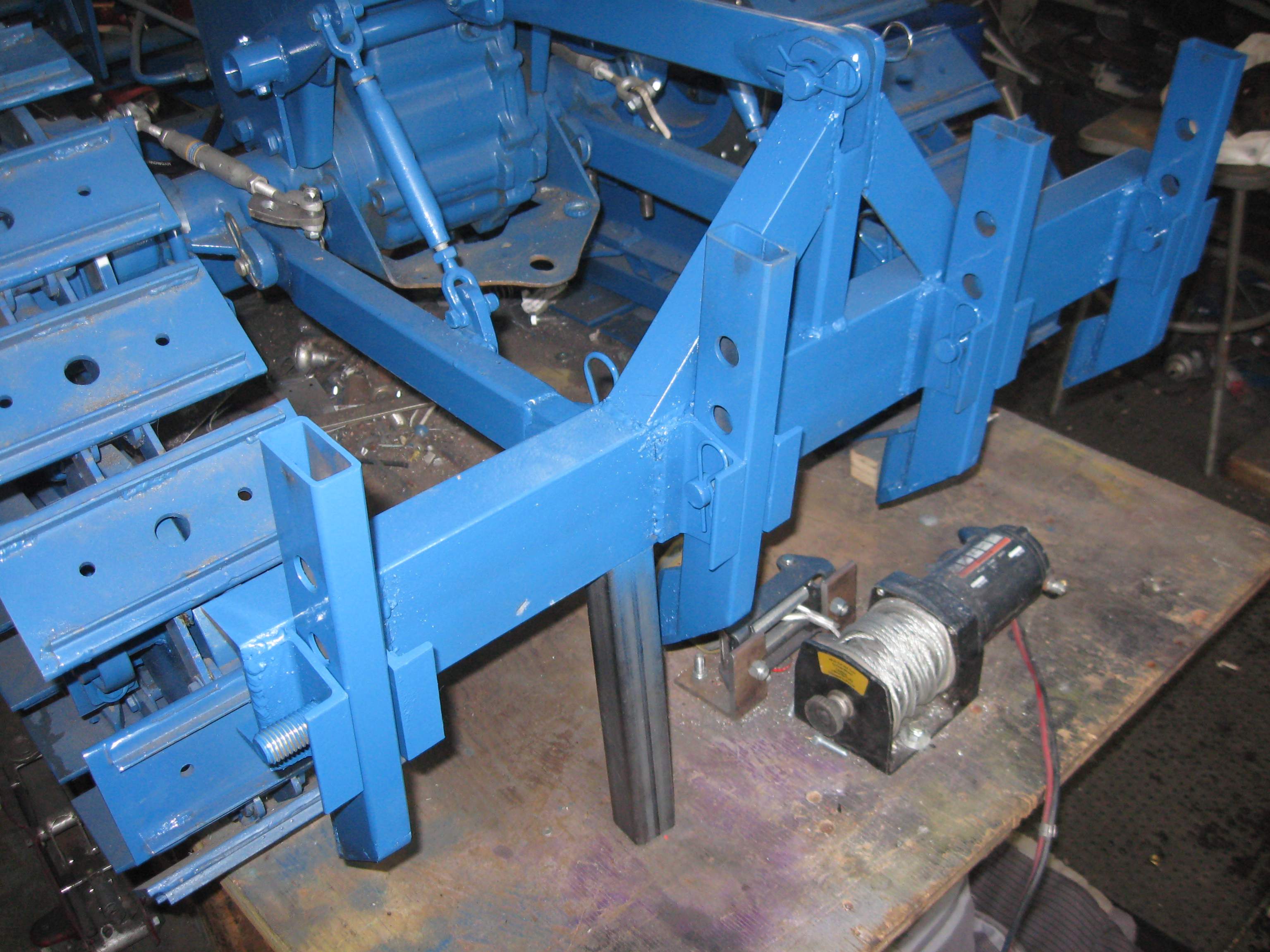

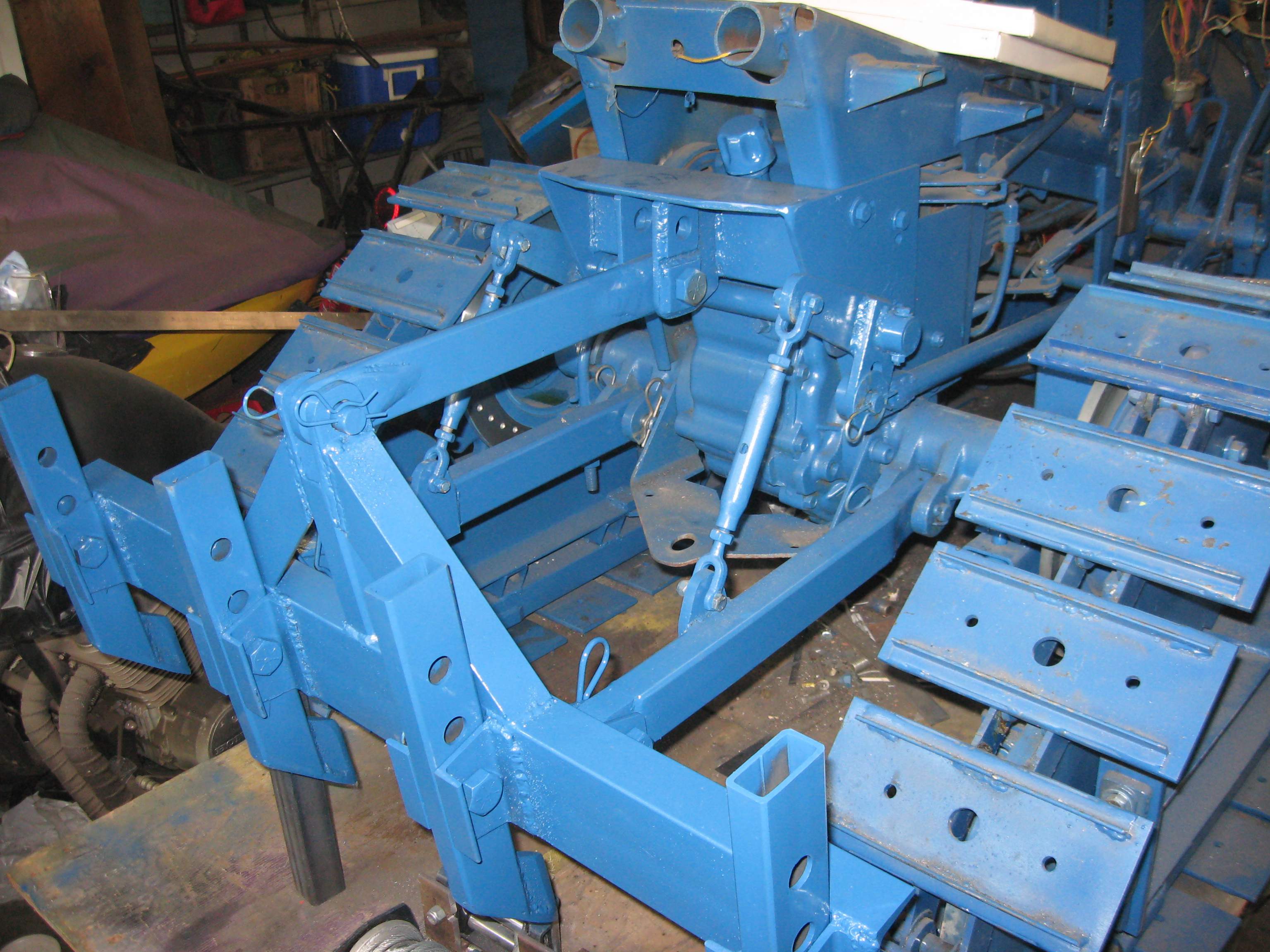

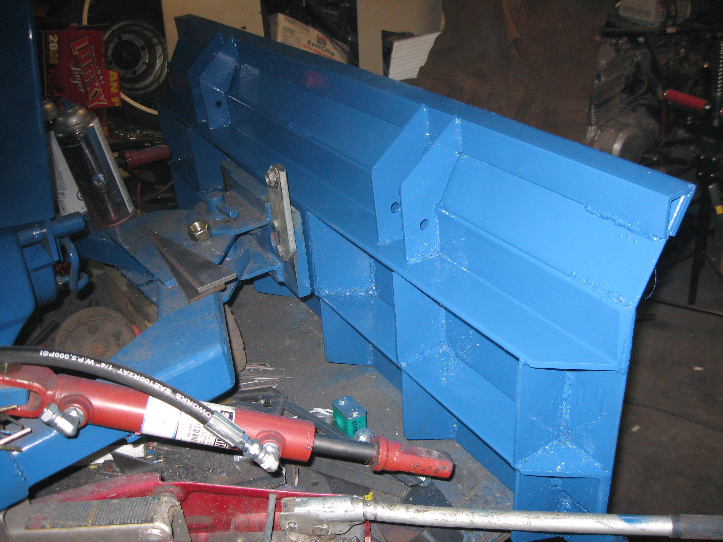

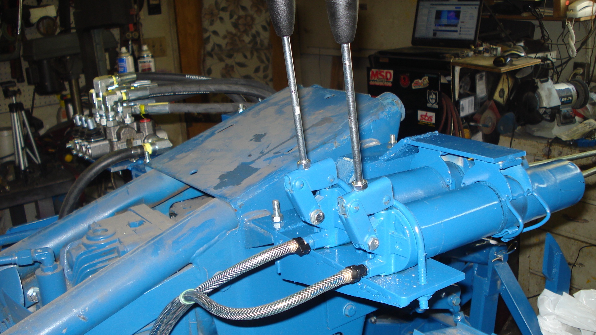

Been working on things. The rear ripper bar is complete, painted and installed.

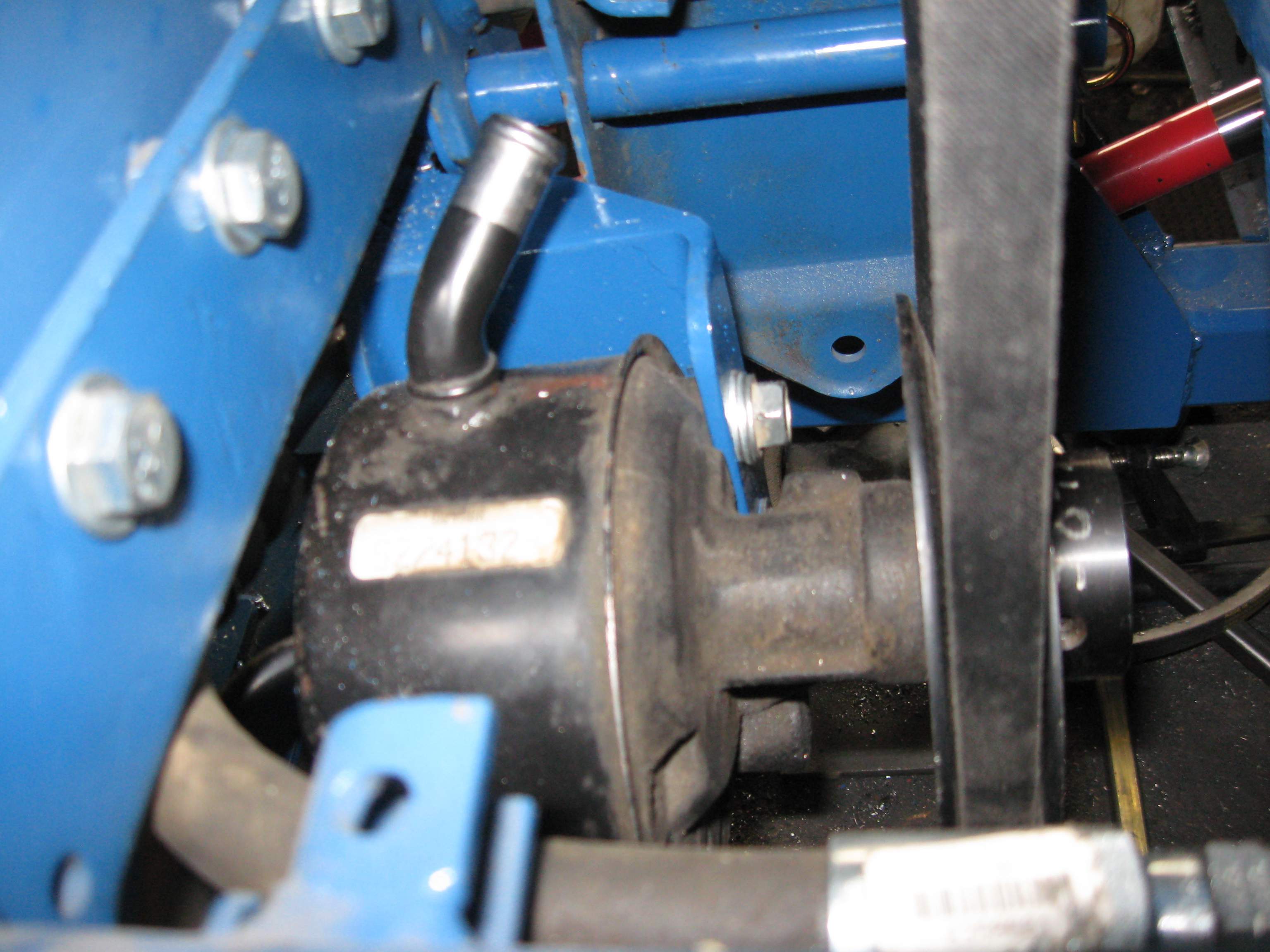

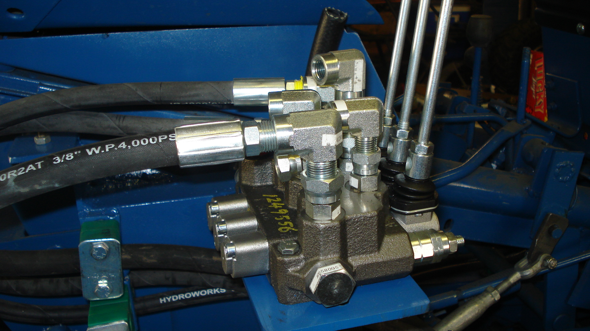

I picked up a power steering pump from Dodge Caravan today, I'm going to experiment with it to see what it can do.

Love the build!!!! There is almost no limit you could build for your 3pt hitch on the back (prezome that's what it is right???)
   / Ford LGT Crawler Conversion
#14
Almost.
It almost meets Cat 0 spec, except for the spacing on the lower arms. Cat 0 requires 20". Mine is at 14".
Nothing that can't be changed out with some flat bar bent to the right dimensions.
I can build an adapter in about an afternoon, so I don't consider that an issue.

I've added a power steering pump to power the front hydraulics. I'm working on the bracket for that. Also waiting on some cash flow to buy hoses and fittings

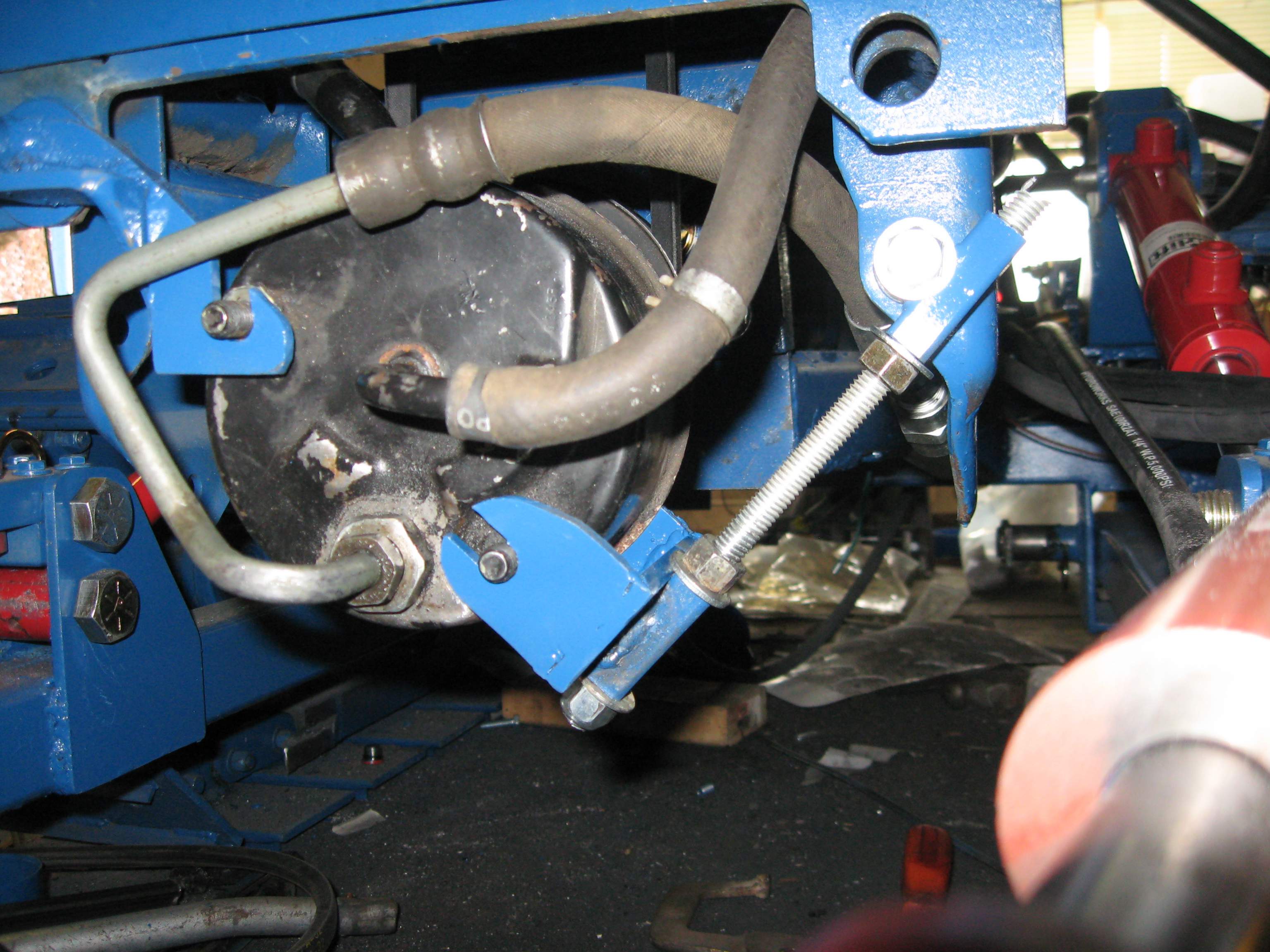

The chopperhed comes from two things, It started when I was playing Battlefield Vietnam online, and I love to fly the choppers, and also in part from my custom CB750 chopper.
The steering is provided by 12" disc brakes on each track, mechanically operated by levers to the emergency brake arms. Rotors and pads are 2008 Dodge Avenger, Calipers are 1988 Lincoln. The dodge rotors are a direct bolt on to the ford hubs. The Lincoln rotors would have fit if I cut out the center hole a bit. If the mechanical steering isn't up to the task, i can rebuild the calipers and use hydraulic brakes. Testing will tell.

If that works as I think it should, it should be a pretty good system for the steering. A lot like the dozers before differential steering came into being. I am interested in hearing of the actual use. Like I said, it does make sense. Thanks for the reply and keep building...

View attachment 416130I put these on all fours. works well in soft ground and protects the tires from spiney things that like to let the air out.
Just put it on for show. I bolt the ends together after letting a bit of air out and then reinflate. Also widen the wheels out a bit both front and rear. Put this in a while back. I like the idea of a full tracked tractor. Was thinking of making a full under carriage that you just drive on, pull the front axle, and change out the rears for a sprocket. By using the hydraulic steering to the calipers for braking, it would be easy to use for both systems.
Using the independent braking as an assist and differential lock when needed it would make a great soft ground machine.
