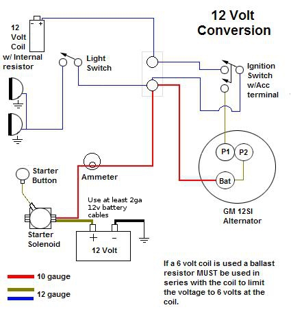

You definitely should not have a voltage regulator in the charging system if you have upgraded to a 12v alternator. The alternator is internally regulated.
   / Ford NAA 12V not charging #12
I like is this simple diagram for wiring the N and hundred series tractors.
