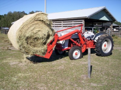

Here is a pic of my 850 moving a round bale of hay. This one is a 711 loader.. but is a later style for a 3 cyl model that I modified to fit to a 4 cyl model.. it's component # is different and has a higher lift and break out rating and this one is a hyd bucket as well... it is mounted on an 850.. which will be very similar to your 4 cyl 4000. this is the pic of the blue loader
I also included a pic of my 660 with a 722 loader, also hyd dump.. also made for a 3 cyl tractor and modified to fit a 4000. It is the red loader.
I have another 711 in parts right now that i am going to mount to my 951.. it is a 19-209 component, and is thus a 4 cyl model and will have the same specs as yours, and is a mechanical trip dump. It's completely disassembled.. so no pics of it yet..
