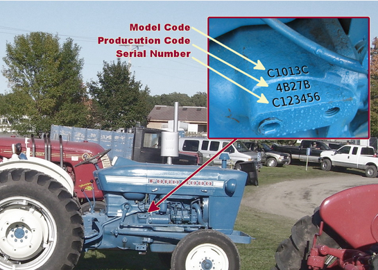

The best option would be to try to ID the base tractor. So when your looking at the radiator from the outside of the machine the data will be on the left side as seen shown in the photo below. Post the numbers and we will ID the machine. The model code is the important one, the other numbers are handy when digging into parts.
Once we know exactly what machine you have we can look up the parts using the OEM catalogs.

It doesn’t really require proper ID as it is an 80s model with modulating valve as described by the OP. This transmission was used with no internal differences on 340/340A/340B, 540/540A/540B, 445/545, 445A/545A, 555/555A/555B and 655A/655B. Many used tractors to choose from that might have good used parts.
One thing it would not be is a 4500, as the OP suggested.

Interesting, I did not realize that all the models shared the same transmission. I think knowing what the base model is would help with all parts issues. Also it is hard to say that it is not an older machine, and the year is wrong given the disconnect between 80's and 4500 model. Having the model code and date code makes the parts side much easier and safer.
