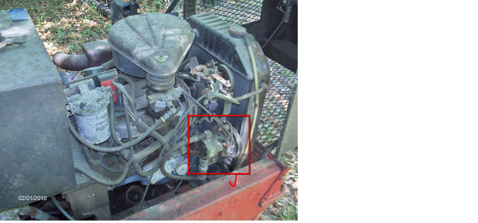

I have a 3 hyd pumps on my Power-Trac. One of those pumps is for the loader and steering. It is a 3 GPM, 3000 psi pump, that runs off my fan belt.
You can do the same, or match up the bolt holes, the pump shaft type and size, etc to your old pump.
A PTO pump would work also if you did not need the PTO for other implements.
JJ, can you post a picture of your auxiliary fan drive hydraulic pump, and possibly the part number for the pump you used?
I also have a 1200 with a weak / inoperable hydraulic pump and have been unable to find a replacment.
   / Ford / Shibaura hydraulic pump hard to get !! #8
   / Ford / Shibaura hydraulic pump hard to get !! #9
Where is your alternator / generator located? Left side, or is that it on the Top front. I'm not at my tractor's location at the moment and can't remember if the water pump is at the top or bottom.
