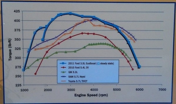

Not just my heavy towing experience, have you seen the up hill challenges?
My answer is: The additional 900 lbs in your example would influence the frequency and need for downshifting. So would additional aerodynamic drag. So would the grade of the hill. Do I really need to explain this?
Point being, turbocharged gas engines produce more torque are lower rpms than NA engines of larger displacement. This enables them to hold a gear without the need to downshift plain and simple.
Fact is, the ecoboost produces more torque than the hemi below 4000 rpms. 15% more at 2500 rpms.
Here is another article of unbiased testers who have similar experiences as I:
http://m.trucktrend.com/oftheyear/truck/1202_2012_truck_of_the_year_ford_f_150/viewall.html
Notice this quote from the article?
"On the road, the EcoBoost makes the 5.0-liter look like obsolete technology. The twin-turbo V-6 is incredibly quick and eager, power is abundant throughout the rpm range, and I didn't really notice any lag. All our testers had similar remarks, and for good reason. The EcoBoost delivers more torque to the ground than the big 6.2-liter up to roughly 5000 rpm and more than the 5.0-liter all the way up to 6000. In loaded, towing, and uphill testing, several judges noted how hard the 5.0-liter was working. "Power seems opposite of where you want it in a truck" to "had to keep the throttle mashed while the transmission hunted" were typical comments."
Your answer of "probably not" leaves me with a sense of your uncertainty. Understandably after all this teaching. Now go out and test drive an ecoboost pulling ANY trailer you desire and report back. I promise to not take your post on a wild tangent excursion. Until then, you have no reason to doubt.
The new 8-speed with the hemi will be interesting. How many gears will it be dropping to crest a hill?
A blanket statement like this is wrong. It's the Direct Injection that creates low end torque NOT the turbo. "A direct injected engine will produce more low end torque than a larger port injection engine" is more accurate. The turbo just makes up for mid-range and top end in leui of displacement.
Turbo gas engines are useless at low rpms, it's the direct injection that makes up for it.
Direct injection will do that. I'll be the first to admit the HEMI is an aging design, it doesn't even have overhead cams. The fact it still performs so well is a testament to a proven design. Adding DOHC or Direct Injection would certainly add to that performance.
I like how your trying to compare engine dynos again.
