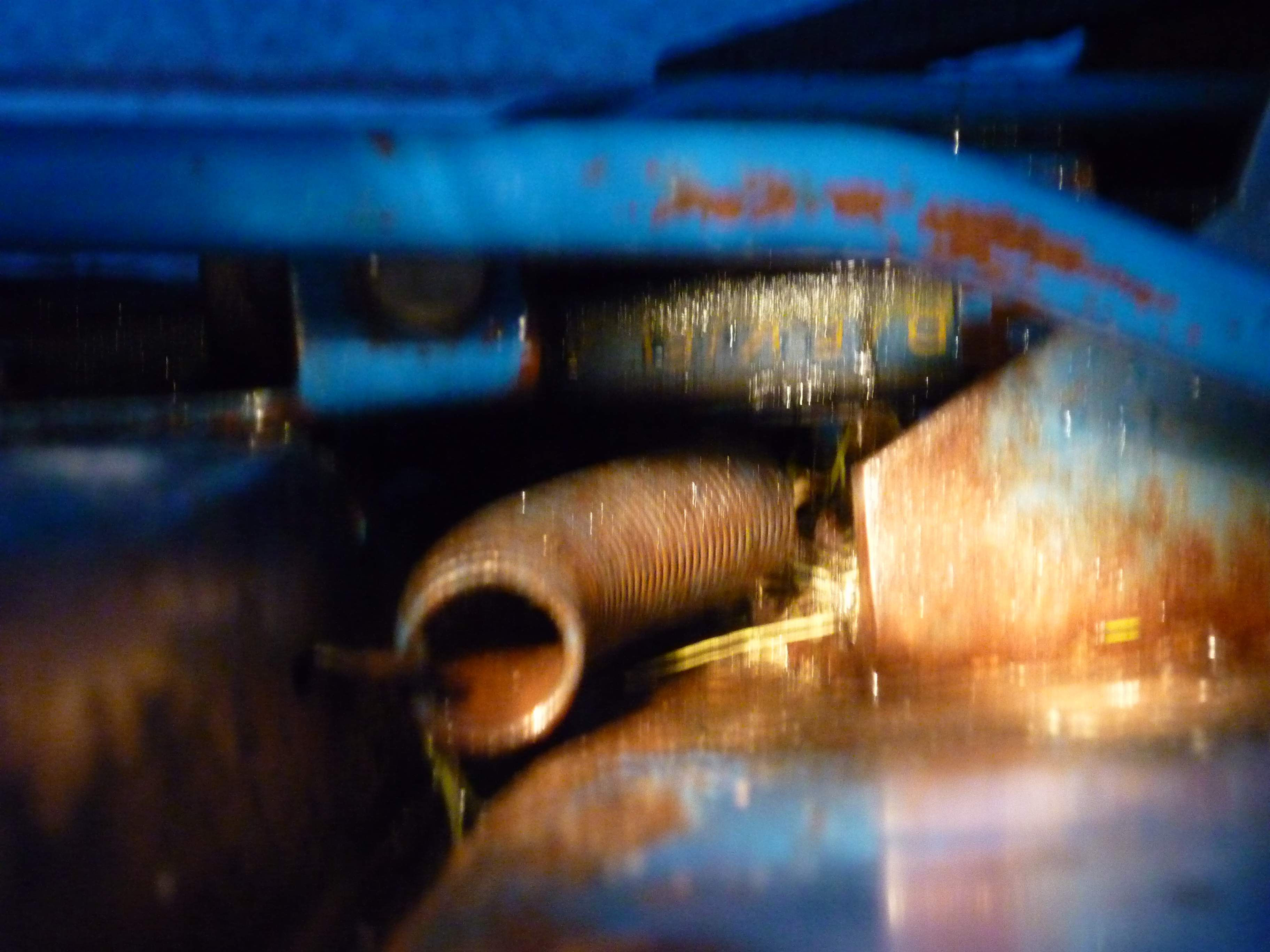

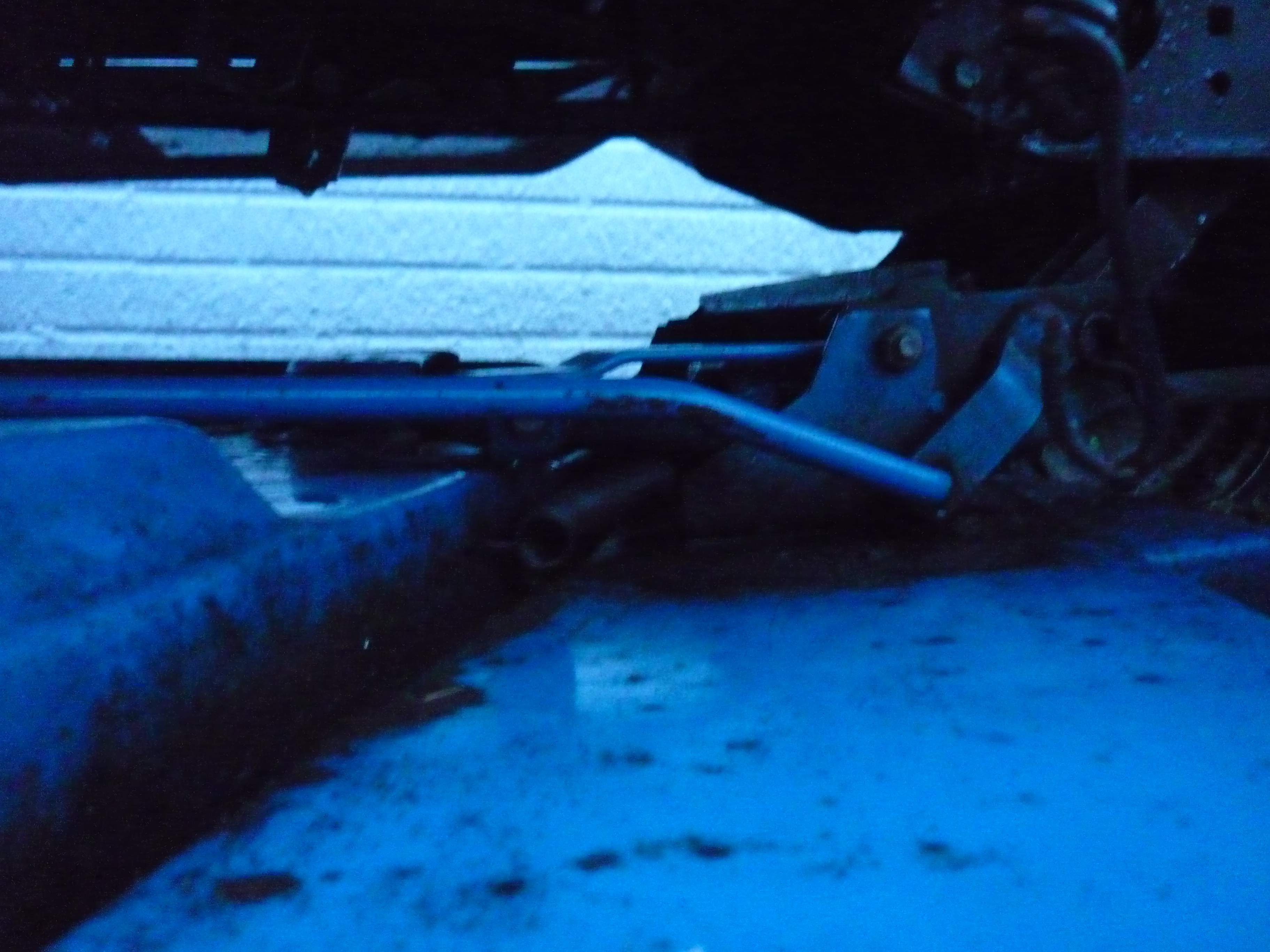

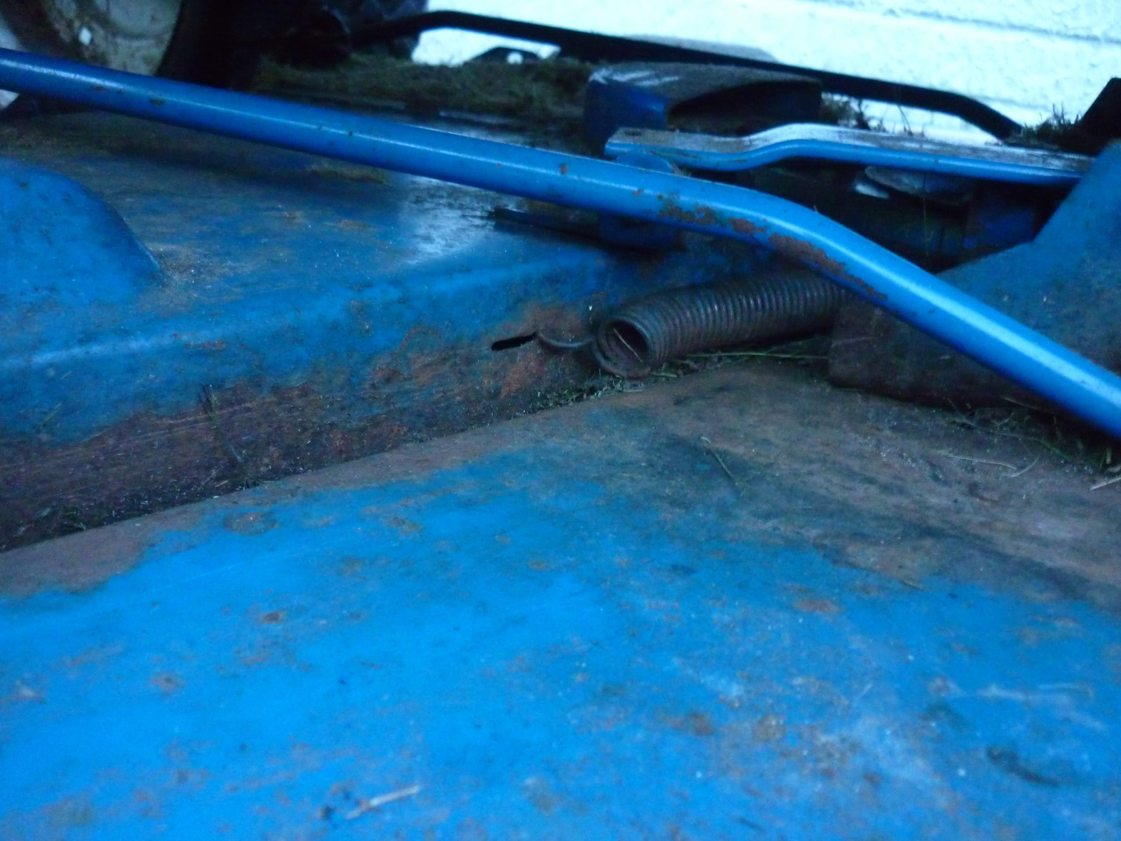

Is it possible to post a close-up picture of the idler pulley tension spring installation? I inherited a YT 16 from my neighbor and it's missing the spring. Assuming that I can find one, how is it installed? There is nothing obvious for it to hook on to. HELP!?
   / Ford YT16 #53
Hi sure, I can post a picture later this evening. The spring is installed via the two hooks on the spring, one goes into a little slot in the frame of the mower deck and the other connects to a little notch under the pulley. Sorry it took so long to get back with you, I was really busy at work and was coming home after dark.

Attached are a few photos of the spring attached to the mower deck and the underside of the pulley.
