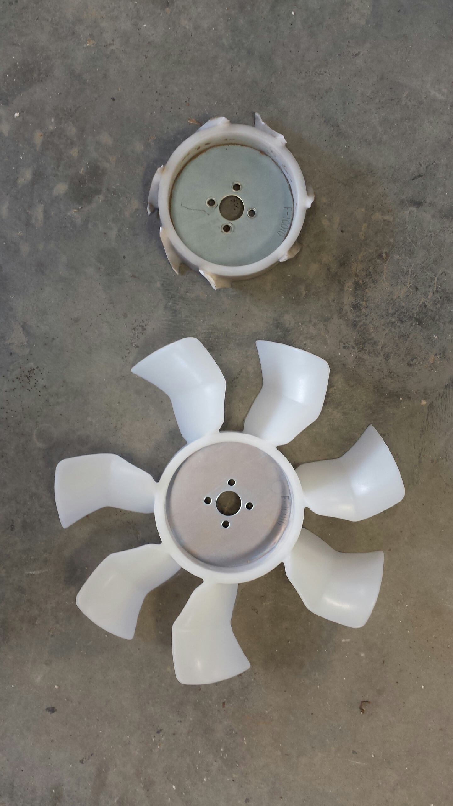

While you exploring mods on your tractor maybe you can come up with something to prevent this problem.
Picture is of my original engine cooling fan "hub" above my replacement engine cooling fan. Sheared every blade with a sprout that I backed over...... :(

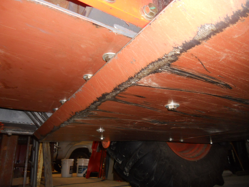

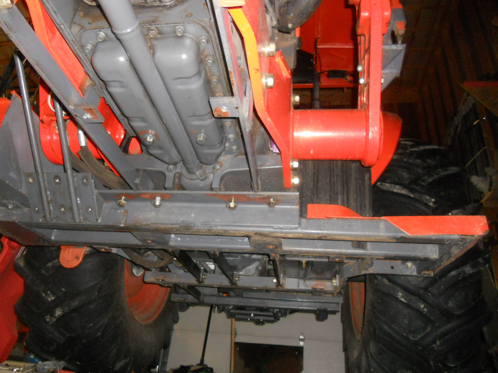

It's seen some action since then.
I built quite a bit of supporting framework to support the weight of the tractor (sitting on the "pan" on a rock or stump) . I wanted to only use 1/4" for the pan (for reasonable removal & cleaning) and wanted to minimize ground clearance loss. IIRC this set up cost me 2.25" of clearance but the pans lower nicely with a floor jack, there are 3 pan sections.

Hey Carl! Yes, still renting it out. No welding to the tractor, I used existing holes in the trans & I quess what would be called the bell housing area and the loader mounting points for the engine pan. I have a ton of pics if you'd like them. I'm not much on a computer and wish I could mark up a pic for explanation. The majority of the "frame" is 2x2 5/16 sq tube with a heavy angle @ the front (where the 45* bend in the plate is) I guarded the plastic fuel tank from the bottom with the plate and the side with a junk plastic p/u bed liner and incorporated a big enough step for some one to hitch a ride on. The hyd filters got guarded along with the loader "plumbing" and it involves a decent saw holder and space for bar oil and mix- a toolbox.
