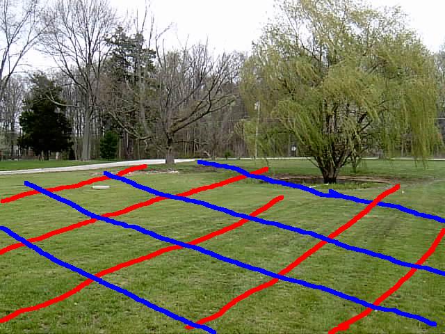

   / Forget bagging, go muching #10
<font color="blue"> The dried long clippings just don't "go away." The mower blades don't get a chance to cut the dried clippings up much because the air stream immediately propells them out the chute where they resettle on the top of the cut grass again.
This is the Major reason for me to vacuum... </font>
This is why I mow in two directions with my rear discharge mower. Not only does it give it another chance to cut the clippings further, but it also helps spread the leftover clipping more evenly. I don't see the need to bag the clippings when this seems to work quite well for me.
To each their own though! /forums/images/graemlins/smirk.gif
