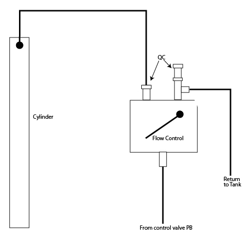

A real forklift will drop pretty dang fast. It doesn't break the sound barrier, but if you push the lever all the way it drops fast. I don't know how the valve works. You can just barely push it and drop at a snails rate or push more and drop faster. A real forklift cylinder doesn't have as much oil volume as you would think because most forklifts have telescoping cylinders.
   / Forklift Hydraulic Question #12
it's still oil flow vs orifice.
you just barely crack the spool, and the oil hase to squeeze thru a pinhole to move = slow.
#13
Show picture and explain about the flow valve power port and plug the return.
If you put fluid into the cyl, it has to flow out of the cyl.
Let me clarify when I said "PLUG THE RETURN". The flow valve return is plugged with a QC but prior to that has a T connected to the tank return. Sorry for the confusion.

Yep, the RDRS150-16 is the one.
   / Forklift Hydraulic Question #16
#17
No J.J., the valve was previously installed on the tractor for other purposes. I just wanted to make sure I could use it to test the forklift. I will probably fine tune it with a needle valve for the finish product.
