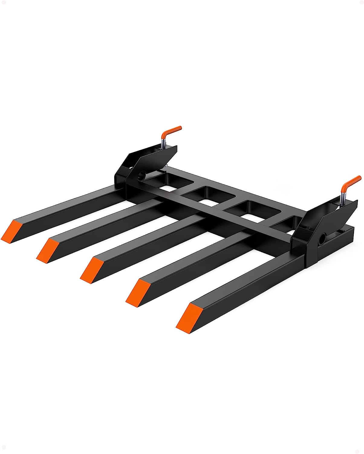

I recently bought a set of debris forks. They are fantastic.
They are bolt on with HEAVY DUTY bolts.
They do not need stabilizer because the whole attachment is welded together.
They will plunge into a S*** pile of brush and pick up a lot without handloading.
They did not get loose or unstable!
Very pleased with product and performance

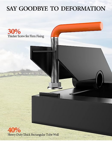

Do you really have these forks? I looked at an advertisement of theirs and it looks like someone photoshopped them into different pictures. The "rugged heavier bolt" appears to have about 1 thread engagement into a 12 ga piece of metal. See below:

Do you really have these forks? I looked at an advertisement of theirs and it looks like someone photoshopped them into different pictures. The "rugged heavier bolt" appears to have about 1 thread engagement into a 12 ga piece of metal. See below:View attachment 809199
Yes I do have the forks I showed. I recently shopped and then purchased. Maybe they have improved, I do not know. I do know that what I bought is very solid. I work equipment hard and put these to the test
