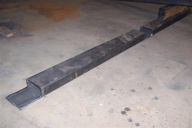

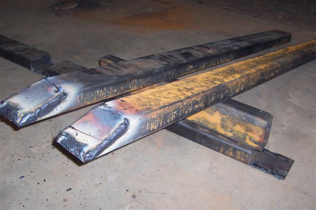

I spent a few hours working on it last night. First I cut out three notches in the cross bar. This is what the forks will be welded to, so the longer pieces will stay intact and I'll weld them into the notches.
Then I cut out a triangle with my cutting torch from the ends of two forks. I'll do all five, but ran out of gas for my torch. Then I heated up the steel and beat it down with my hammer to create a point. It's probably overkill, but I welded the tip together with some 7014 rod to make it a little harder.
Eddie

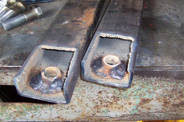

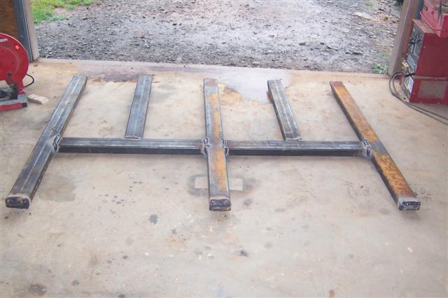

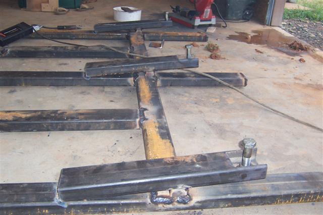

Here are the latest pics of my forks. They are almost done, but not quite. I still need to finish welding up the brackets, and then add some bracing to make the weak points allot stronger.
My bottom of my FEL is twice as thick along the front nine inches then it is on the rest of it. There is also a cuttinb blade that's bolted onto the FEL that makes it even thicker and stronger. This is where I've lined up the bolts that will hold the forks in place.
My thinking is that the front edge of the FEL will handle the majority of the weight of the fingers. The bolts will mostly be there to keep it in place.
The pictures should explain what I've done.
Thaks,
Eddie
