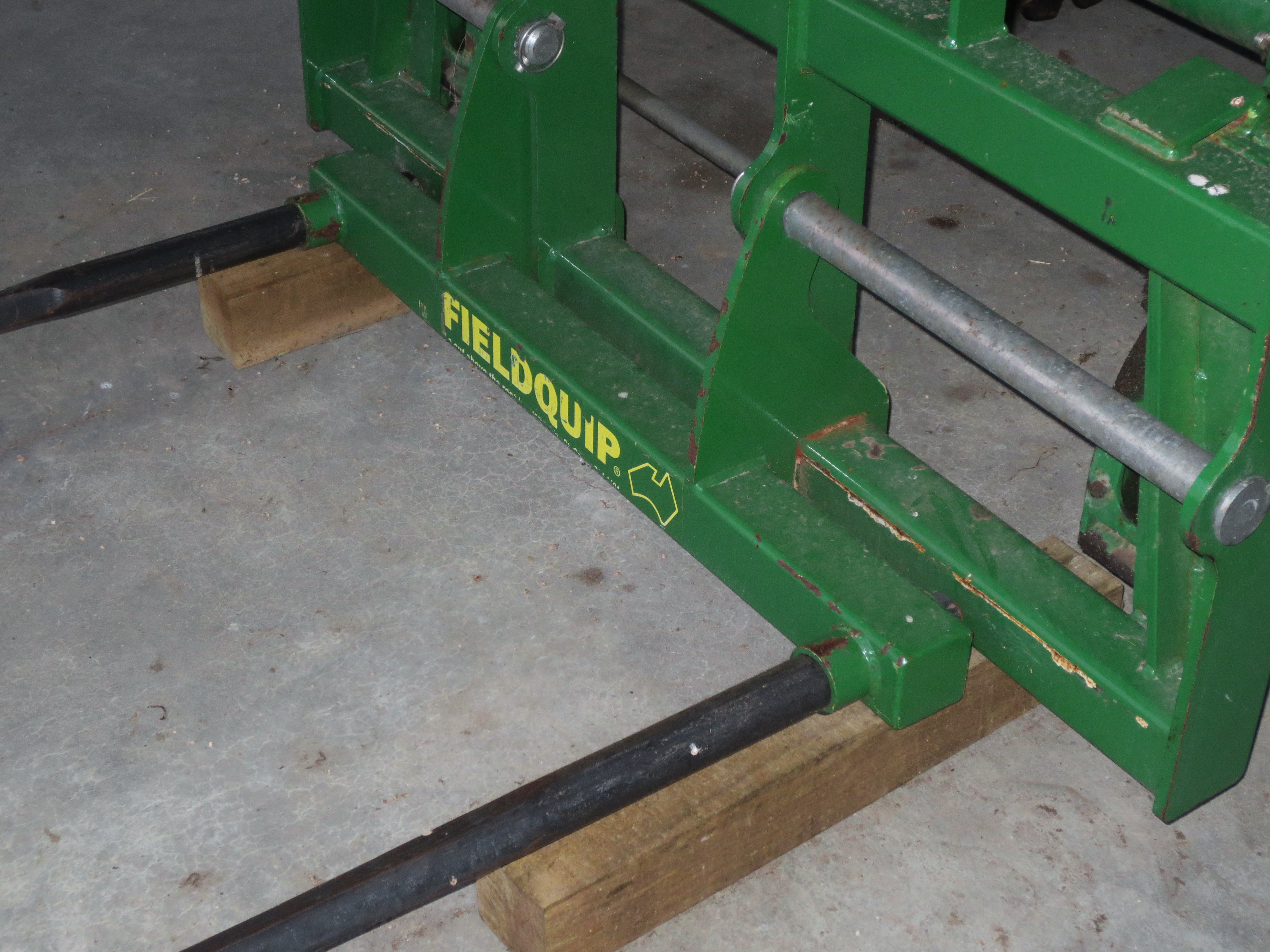

I'm looking to purchase a set of forks and. Hay spear. Or a combo. Or just forks. At this time I'm having someone cut the fields for hay but I'm having to move the bales. So my first thought was... hay spear....then I thought a set of forks would be useful in countless ways...then I stumbled across a combo unit.
So the question is...can a set of forks be used as effectively as a hay spear? Should I save a few bucks and just get forks and make them work for the hay? Or spend the couple hundred more and get a combo unit?
   / Forks, spear, or combo? #3
A combination is the way to go... one where you can swap between either the spears or the forks for the job at hand.
I wouldn't recommend trying to save a few $'s by just using pallet forks on a bale of hay as it's too unstable for a long distance move, over uneven ground.
The right tool for the job is always better.

I need to remove the forks a lot to use the receiver to move trailers. I made the removal slot on the bottom a little wider. Just put them together in the center and set them down on a level surface. Tilt forward a little and lower a little. Then back out. Putting them on is the opposite. No lifting.. tilt forward after moving past the slot and they slide easier.

Pallet forks are one of those items that will make you wonder how you ever got by without them, I would say 98% of the time my loader is on the tractor the forks are on it. When it comes to moving hay yes you might be able to do it with pallet forks but there is nothing to keep a bale from rolling back if you lift it high, there is nothing to keep it from falling off, and when-if you stack 3 bales in a pyramid you will likely tear apart the lower bales when you go to pick the top one.
Bale spears on the pallet fork frame are much more useful. They way I built mine is I have two bushing welded into the frame that accepts bolt in bale spears, when the spears are out the bushings are there and not in the way. The forks themselves all I have to do is slide them to the middle and they lift off the frame. FYI-- bale spears tend to bend or break when using them like pallet forks and lifting heavy things.
