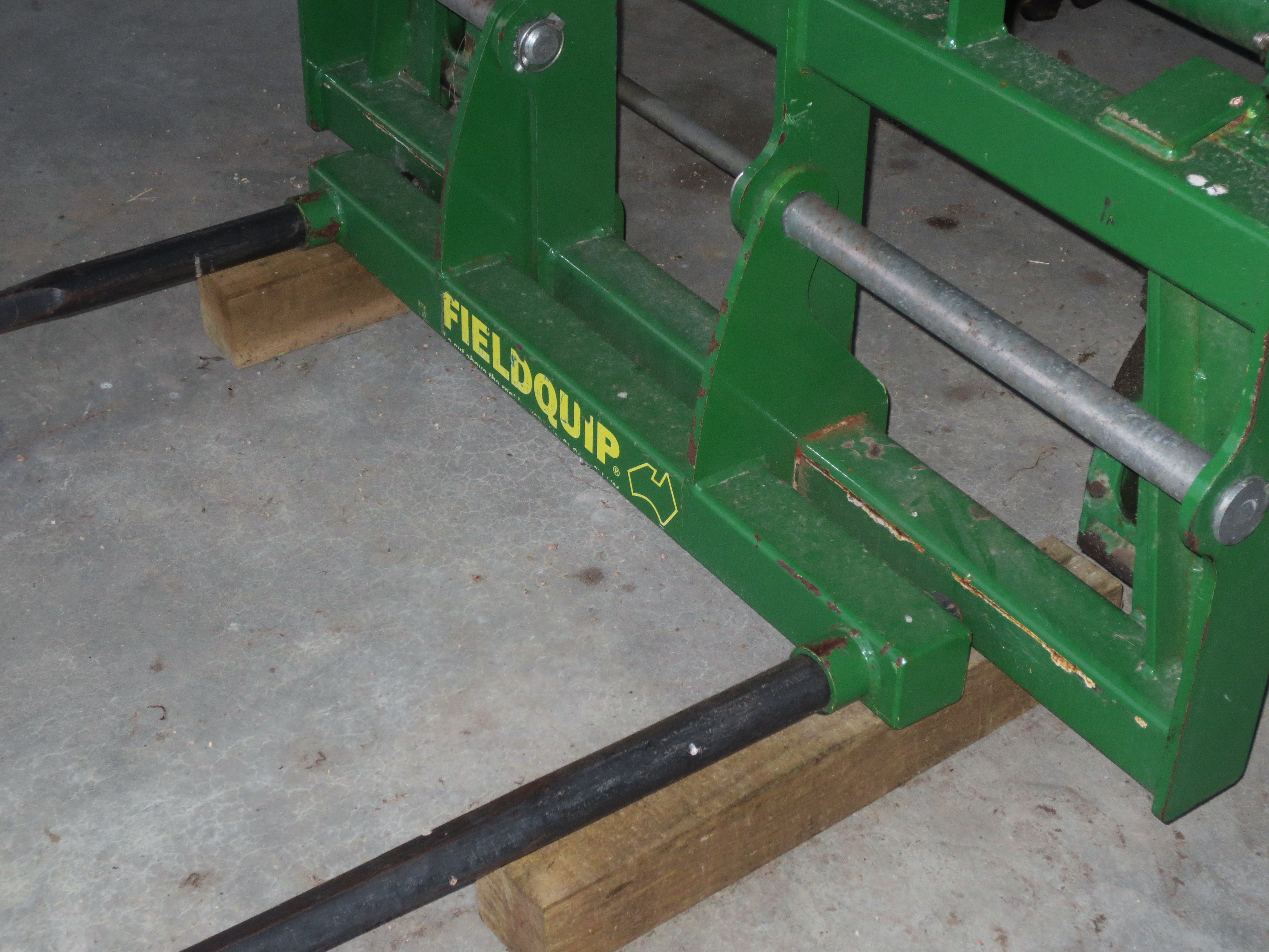

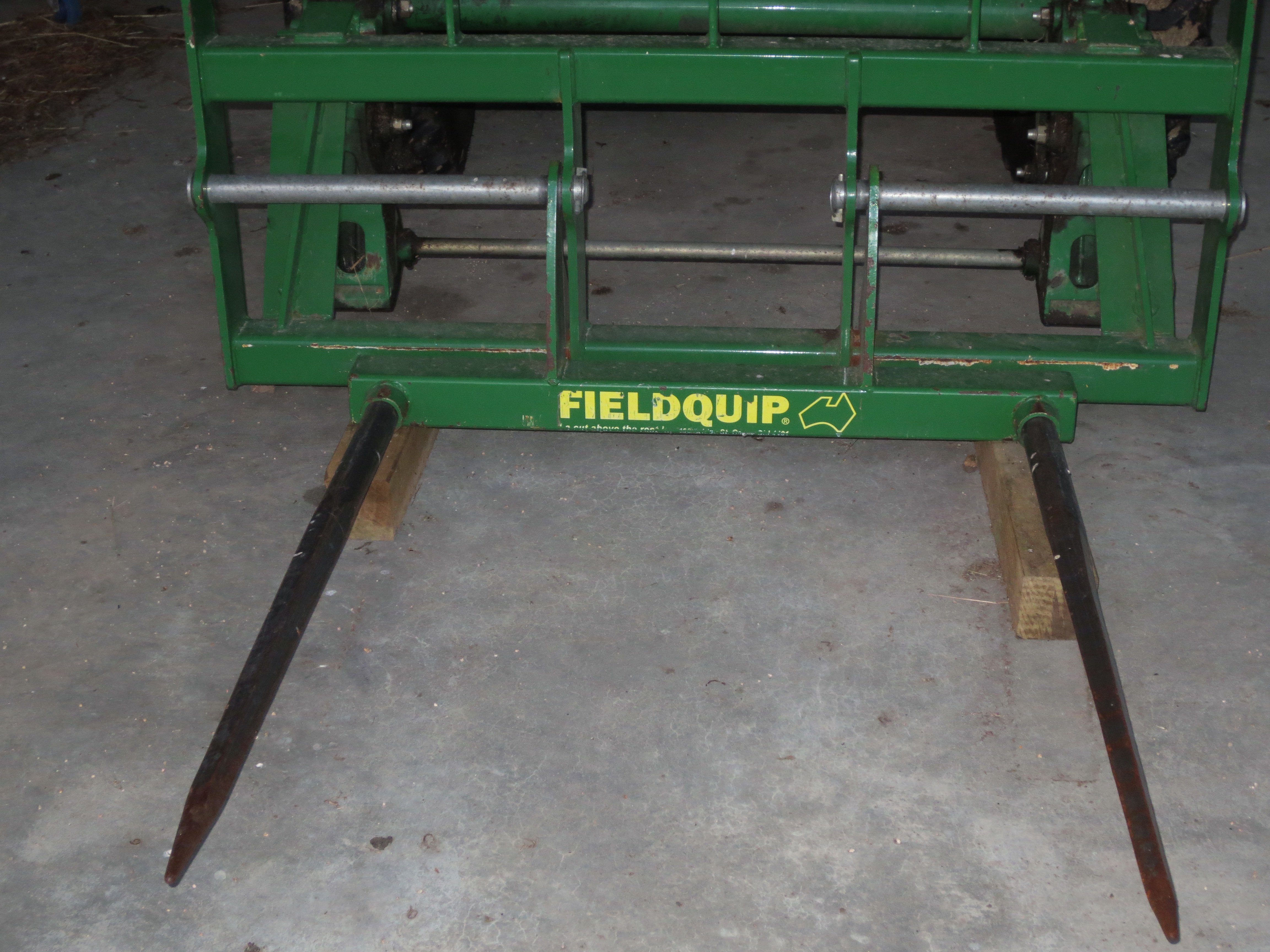

And that's why I recommend the 'combo'. I'm the opposite to you, and duramazsky... my bale spikes are constantly on my FEL. Occasionally I'll need to swap to the forks.
But I can.
