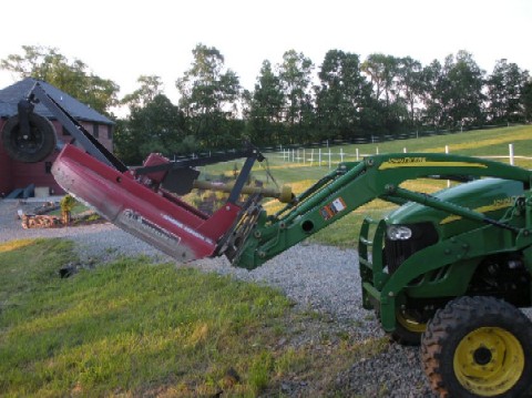

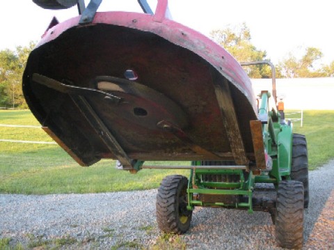

Here is a pic of my lifted Bush Hog for deck cleaning and blade sharpening, using
Chris Perry's fork lift attachment.
regards,
Steve

   / Forks #8
I just bought a set from my Kubota dealer 3500 pound capacity for a bit over $600. They are a no name brand, but seem really well built.
