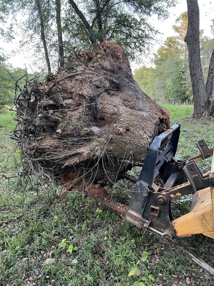

I have 4 foot forks.
When I first got them, I tried moving some pine trees to the burn pile with them, but it's almost impossible to get the balance just right. I have a grapple, and it's the ideal tool for moving trees, but since I had the forks already on, I tried using them. It was so frustrating that I will never do that again.
I was surprised to read that, as that is something I do all the time with my pallet forks and its no big deal to do at all.
I bet I've moved brush and logs a thousand times with my pallet forks, I just move the forks as far apart as they will go and drive under the load.
Most sawmills use pallet forks or pallet forks with a matching grapple, just as I do all the time around here. I switched from a dedicated grapple to my pallet forks.
SR

Moving cut logs with forks probably would of worked a lot better then an entire tree with the stump still attached. Something about driving across a field, and keeping it on a set of pallet forks, was just more then I was capable of doing.

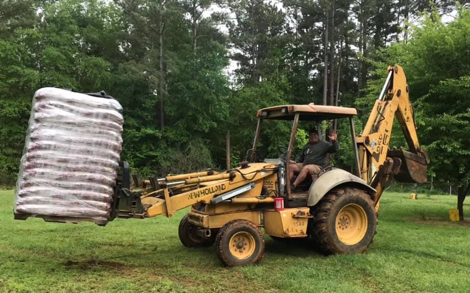

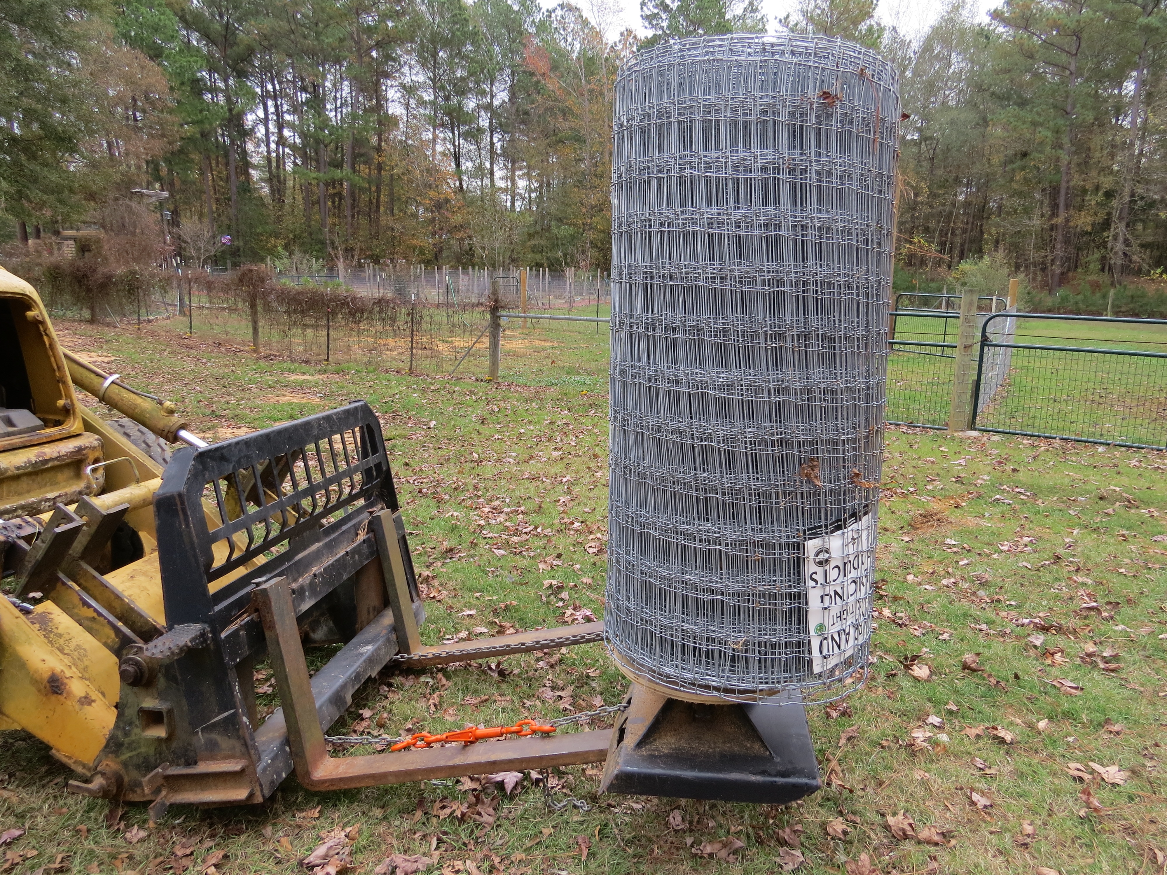

When organizing pallets, forks longer than the pallet can cause problems. Holes poked in buildings, damage a pallet behind the one you are moving.
Yep I have to be very careful with these 6 footers:
unless they are going in the long way:
