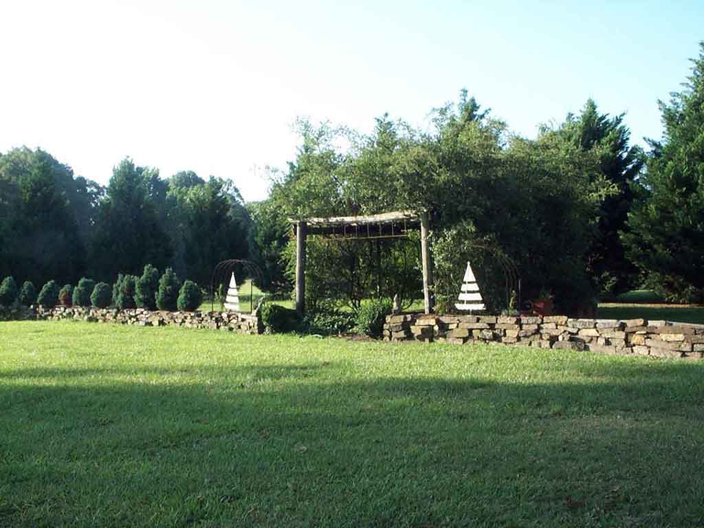

Post some pic's of your stone projects in the "projects" section John. I'd be interested to see what you're doing.
We've built a few raised beds around here.
