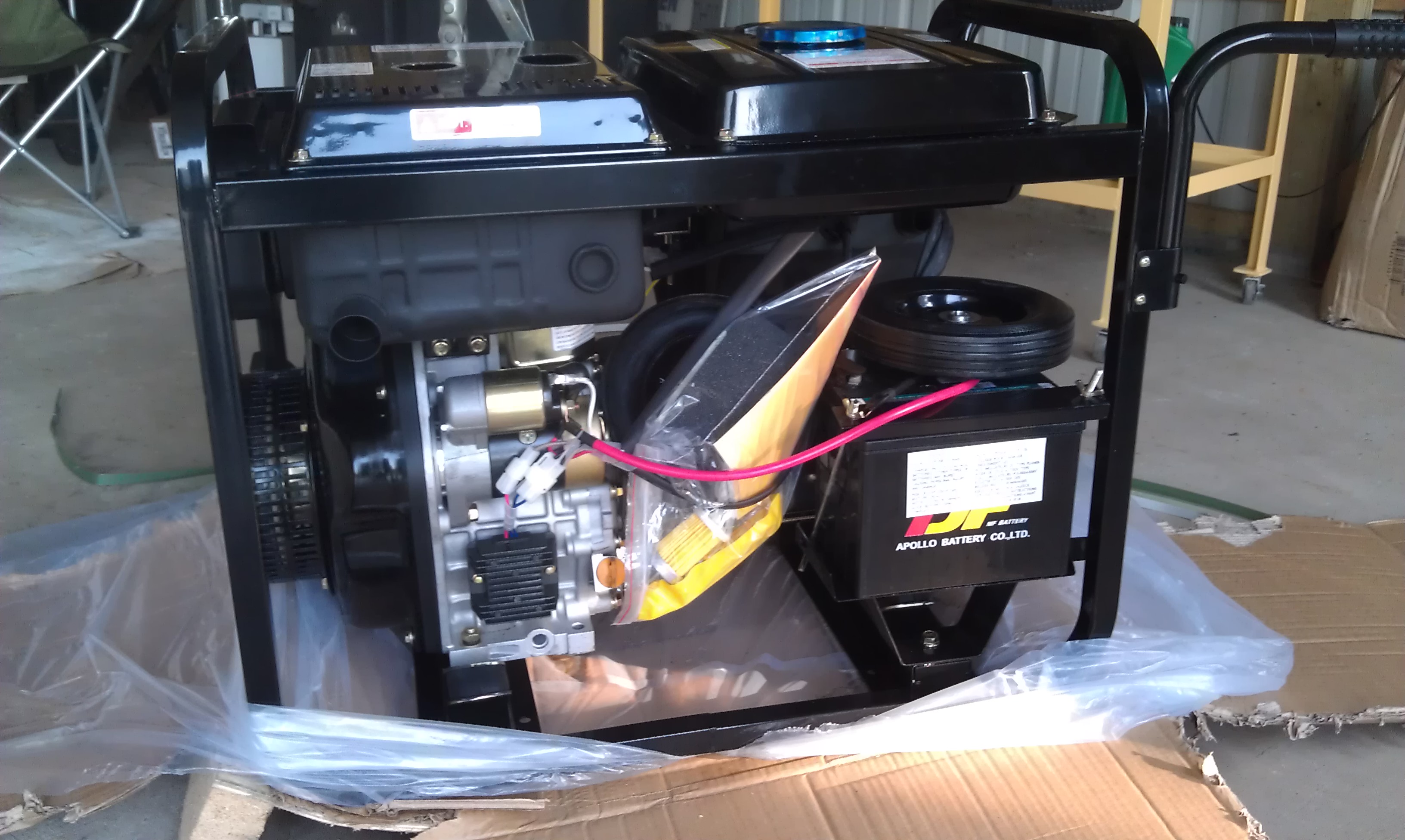

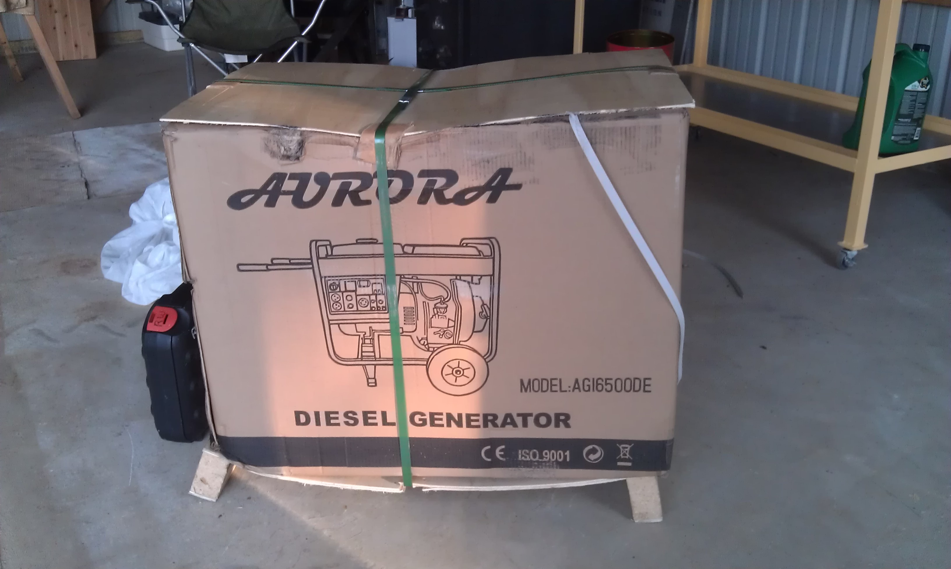

Finally got to Atlanta and picked up the Aurora generator.
Nice folks there....huge airport type warehouses.....
They loaded it with a small forklift and I headed to Va.
I had several projects to do up there more important than to open the generator crate.....mistake.

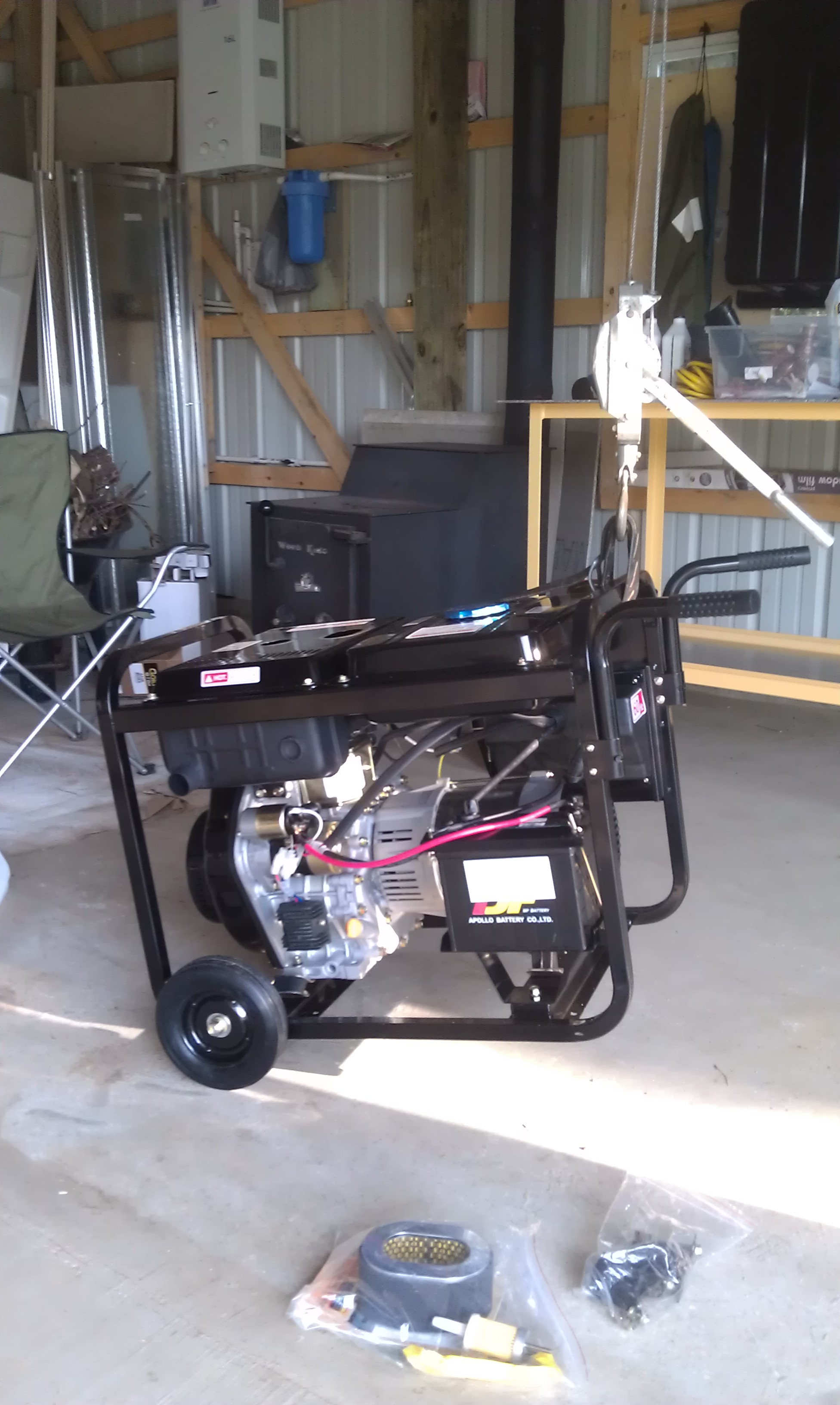

I hauled in water tanks, worked on my dilapidated road, unloaded my "project" Blazer. It was 3 days before I opened the crate. All looked good, I lifted it with a leather strap and a come-a-long to install the wheels. Installed the wheels, front feet, checked the air cleaner, installed 1.5 qts of oil, hooked up the battery cables and looked...and looked....and looked for the ignition keys. Nope, no keys....I searched everywhere, the box, the frame, inside the air cleaner etc.......nope. I called Mike in Canada, "supposed to be wiretyed to the frame or IN the ignition switch"........nope.

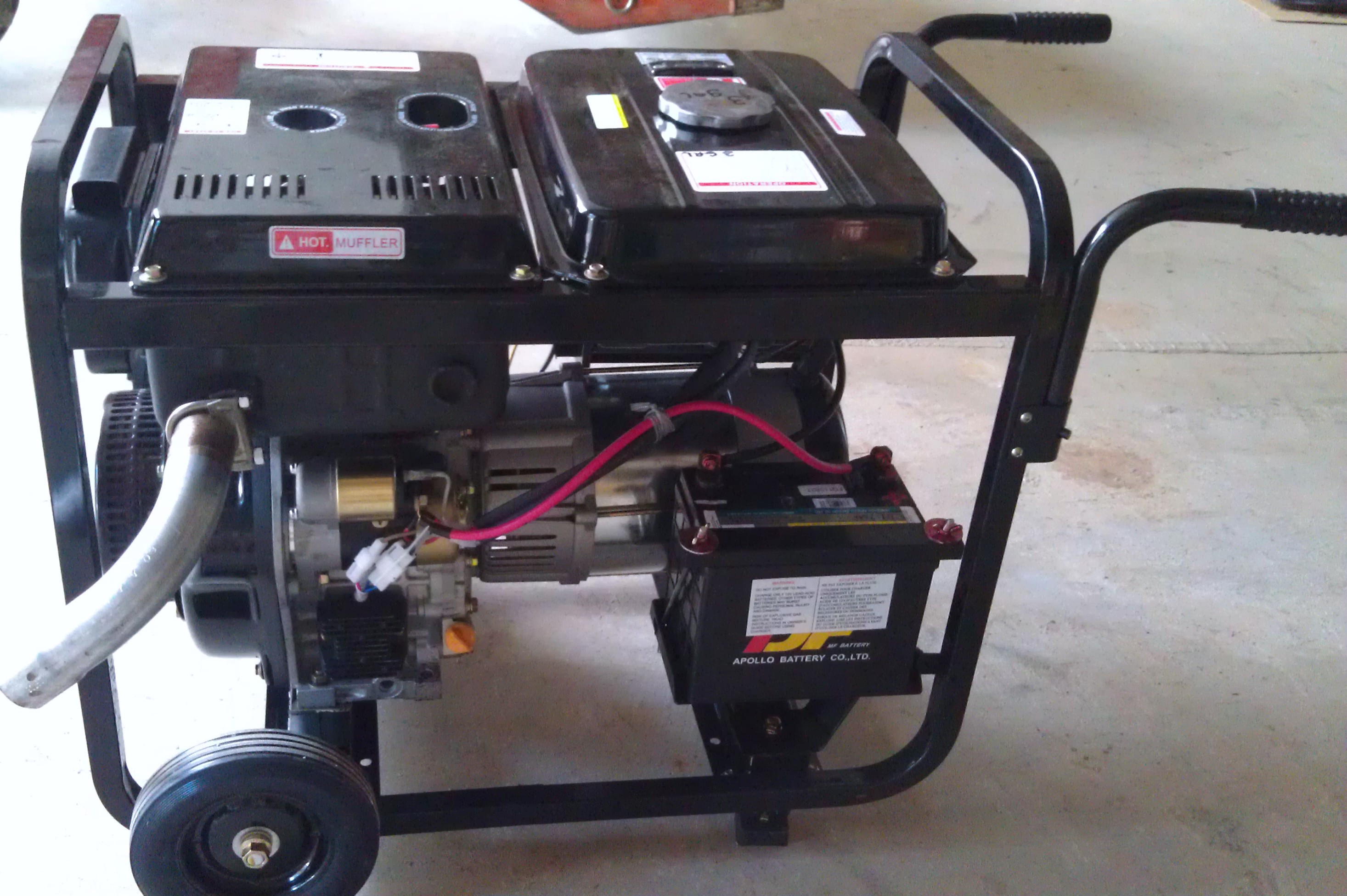

I DID get the new switch (with keys) from Aurora. Got back to Va. last week and rather than disassembling panels to change switches I actually TRIED the new keys in the orig switch....THEY WORKED..!!! no disassembly required:thumbsup:
I added a 90 degree exhaust elbow to direct the blast away from the gen area.....and it ran wonderfully. Smoked for about 15 seconds I will say it is GOD awful LOUD......maybe an auto muffler would help. Right now it requires earplugs.....:confused2:
