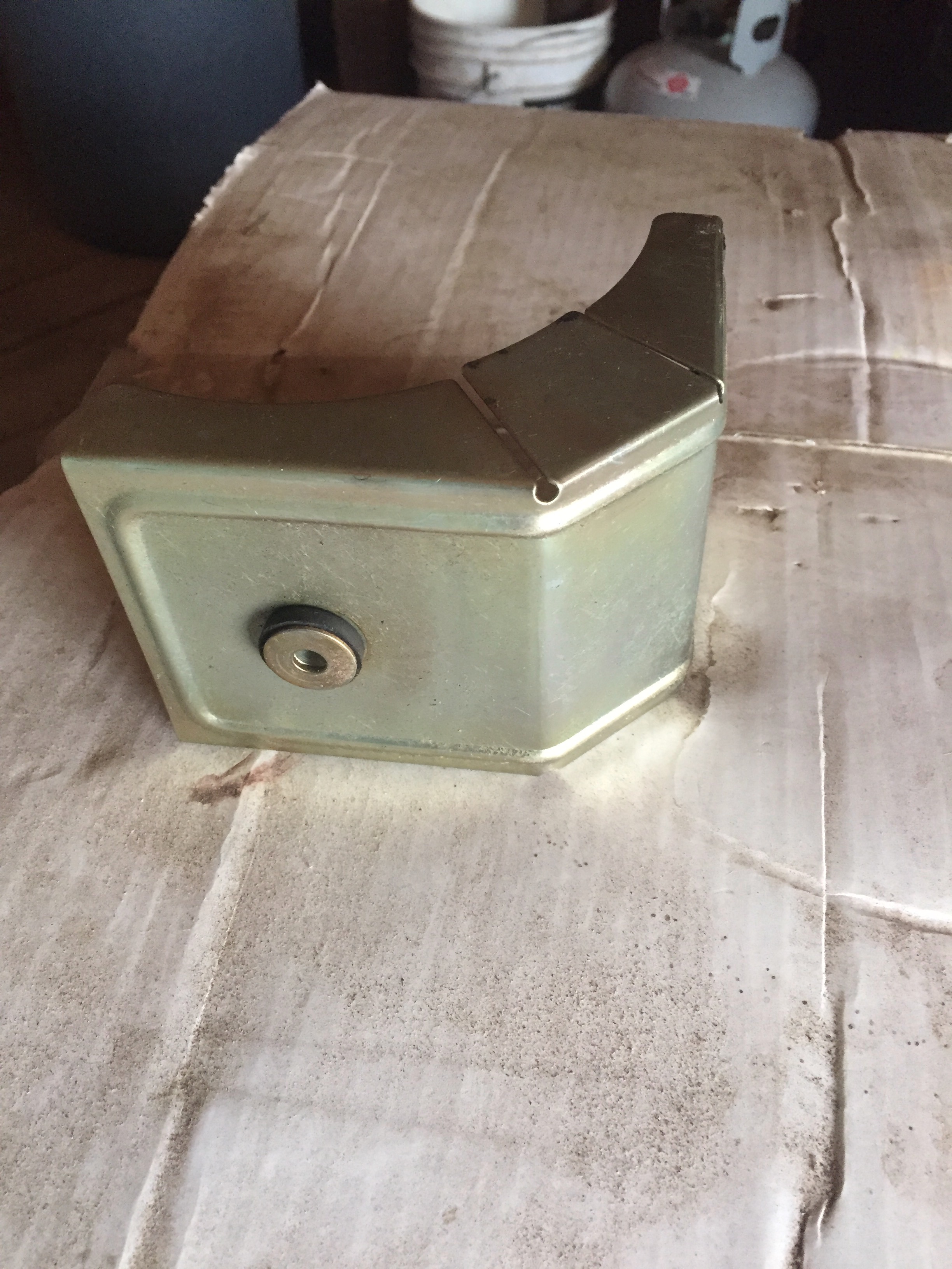

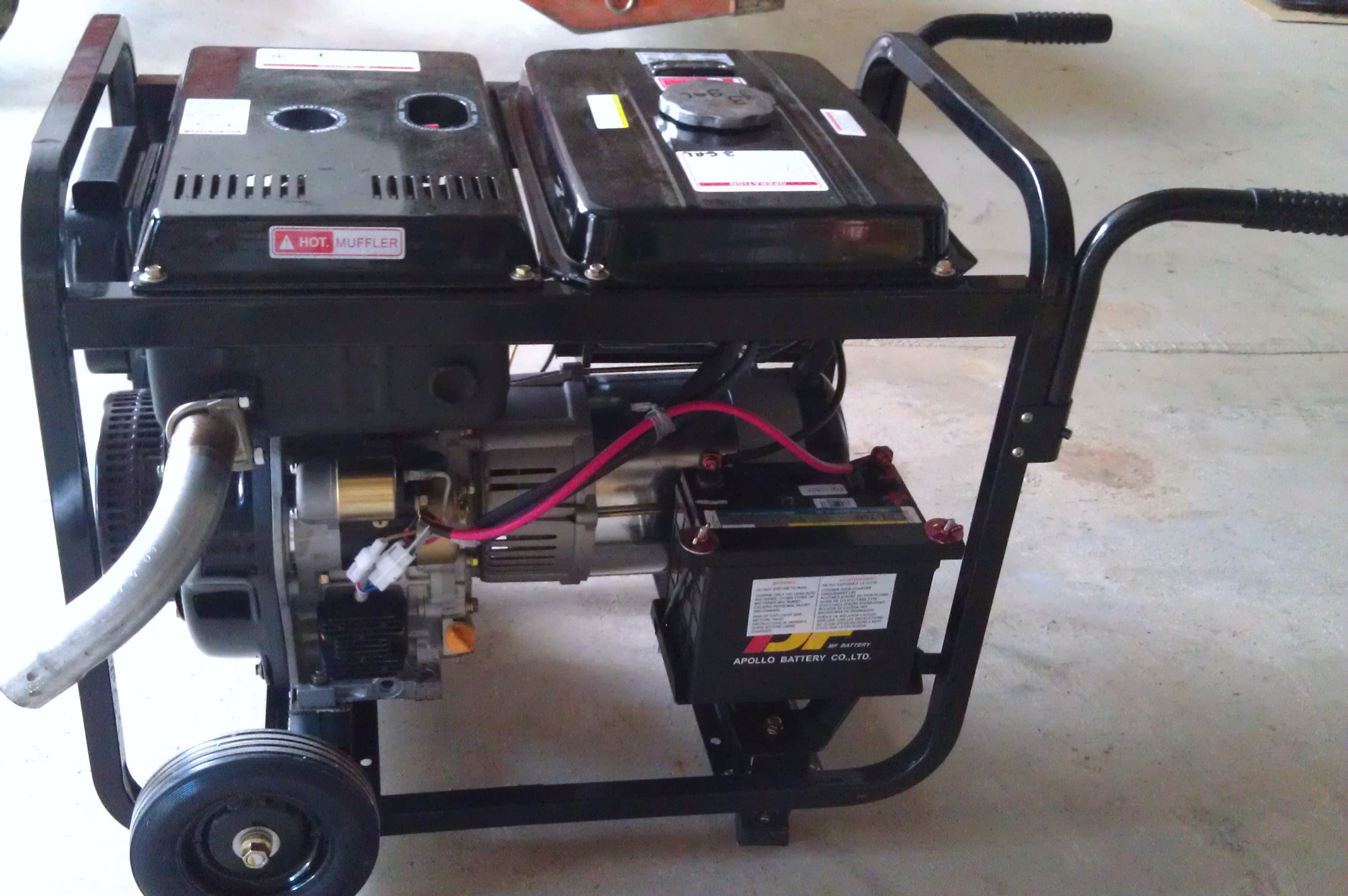

I guess I outsmarted myself.....I had complained about how LOUD my diesel Aurora Gen was. Several folks suggested ways to add a auto muffler or other ideas to disperse the noise. I CLAMPED A 90 degree ELL on the factory muffler short pipe, THEN I added a flexible exhaust pipe that got the exhause about 30" away (not shown)....and that helped. BUT, this addition weighed about a pound and caused a crack around the muffler's exhaust tube. I had it welded and added a support bar across the frame to hold this weight. It worked for about 2 hours and the muffler's tube broke off completely this time. Anyone have a better idea? Don't think that it was added weight this time.....maybe too rigid for the motors vibration....... sure is loud!!!! Still looking for ideas.....aye, what was that....couldn't HEAR you...:laughing:
