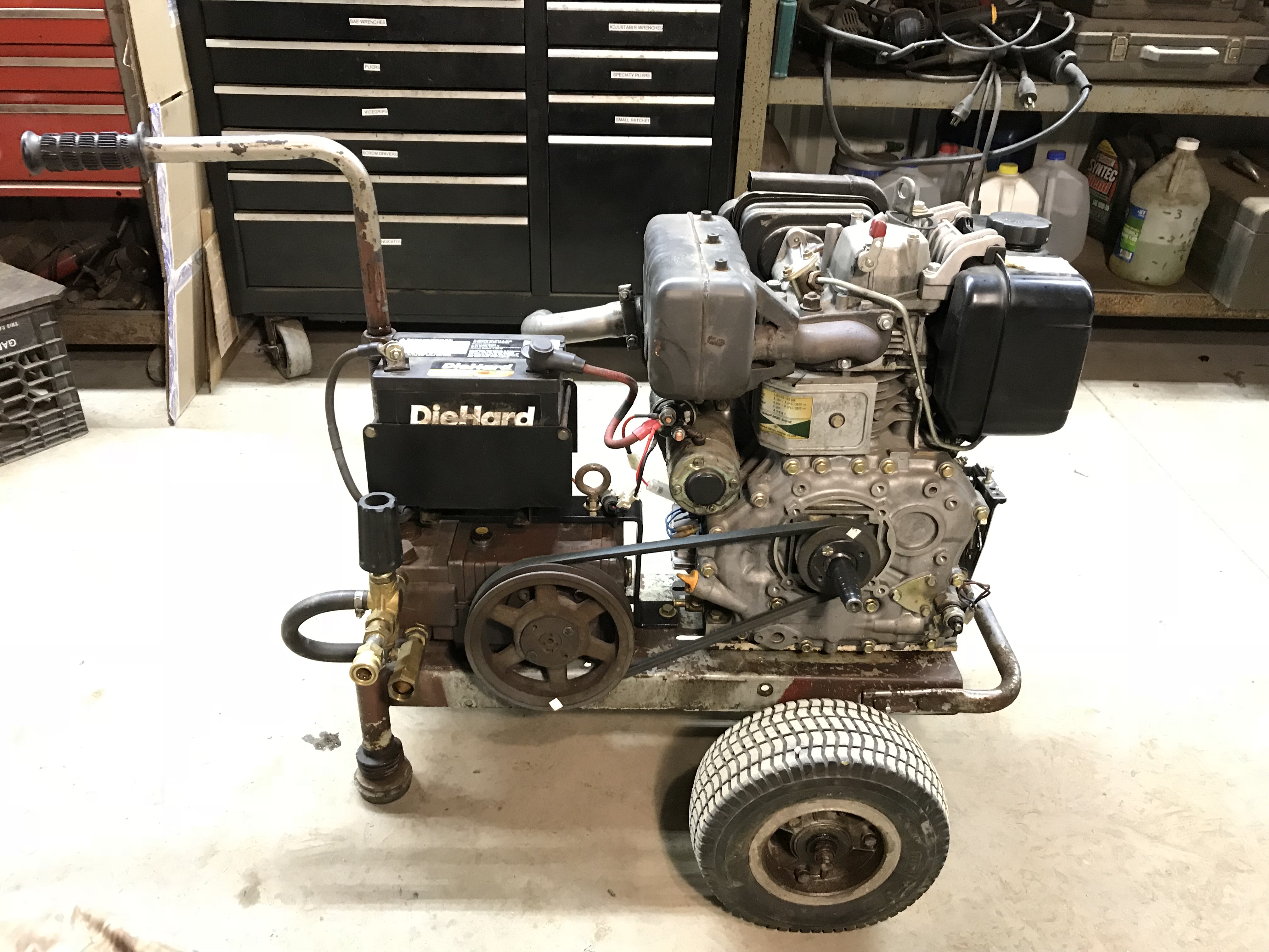

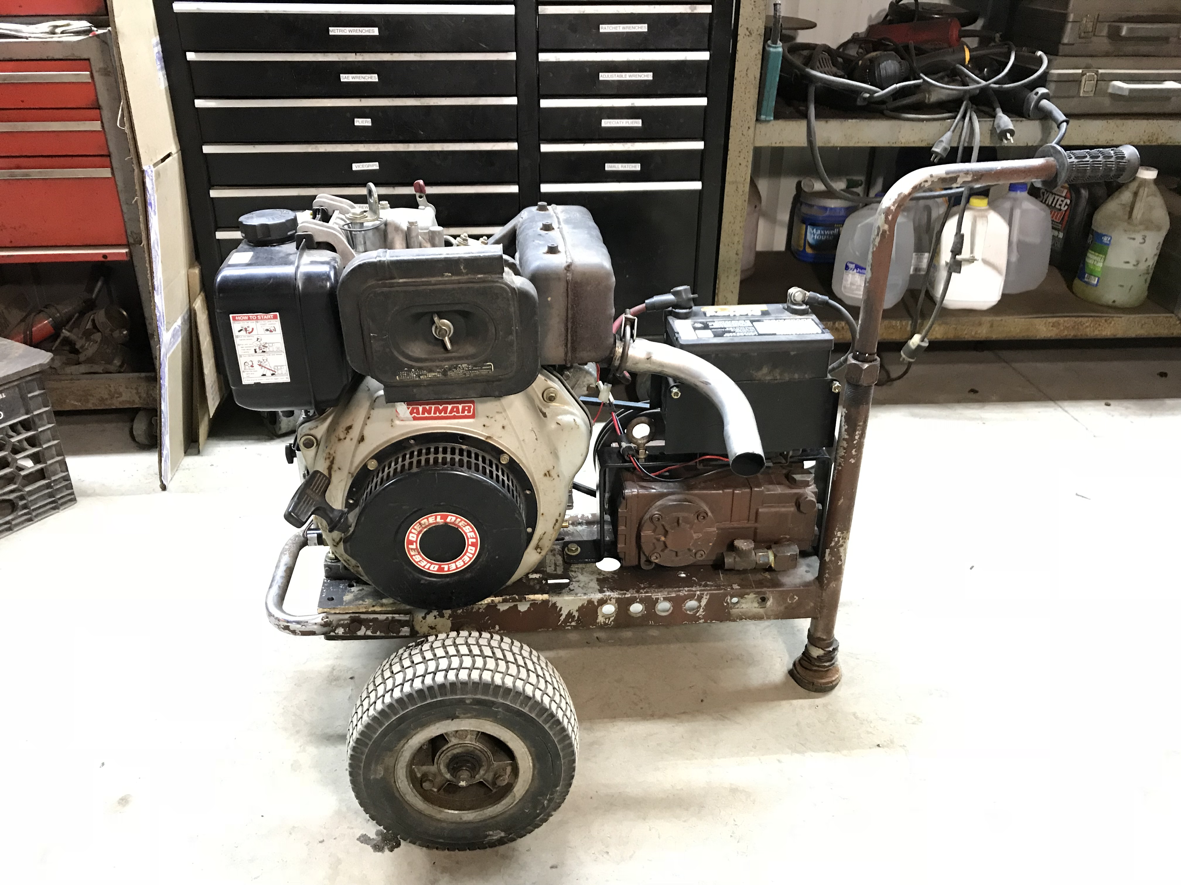

My newest Yanmar project.
I acquired a Landa pressure washer a couple years ago from a friend who was moving to Virginia and needed to part with some equipment.
The first thing I did was remove the Cast Iron 10hp Briggs and install my 9hp L90 Yanmar diesel that I had previously rebuilt with a new piston & rings. The original piston was broken from I assume the use of starting fluid.
Once the engine was installed I fired it up for a test and couldn't get any pressure.
It's a Giant brand zero trapped pressure type with a slow pressure rise when the trigger is pulled and it refused too build pressure so I moved on to plan B.
I had an old adjustable regulator laying around on an electric drive Cat Pump so I decided it was time to swap it out and finally have a high capacity pressure washer.
The pump is a General T1011 best I can tell. This pump shares many common parts with the T1011 2000psi, TS1021 3000psi and TS2021 3500psi but not knowing which pump I have I've set it for 2500psi..
The pump belt driven and under load is currently turning 1300 rpm and the engine is at 2800 rpm.
The pump is rated at 5.6gpm at 1450rpm & 4.5gpm at 1125rpm.
I installed a 5000psi gauge in the line and ran it up too 2600psi with no effort.
The Yanmar has electric start and a charging coil so I made a mount for the battery and necessary wiring to save my shoulders.
These Yanmars are amazing little engines needing only 1 good pull to start but you can't beat electric.
My current nozzles are rated at 3 gpm so new 5.5gpm nozzles are needed to fully utilize the power.
I ordered new #7 nozzles to utilize the full capacity of the pump.
The only thing I have left to do is fabricate a belt guard.
This is my 3rd Yanmar powered project and perhaps the one that will get the most use.
This machine came with over 100 ft of hose, wand and an adjustable nozzle.

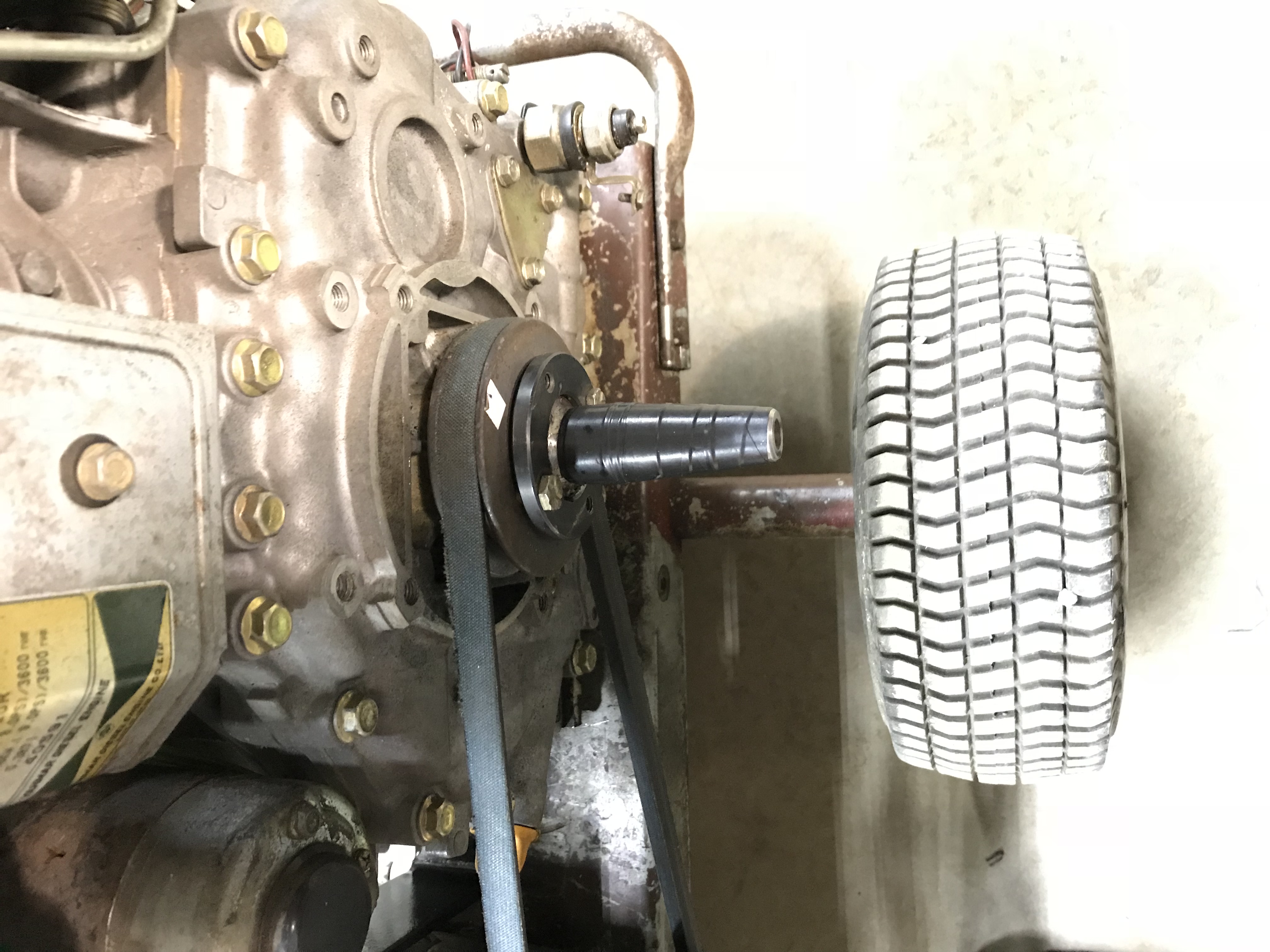

This engine has a crankshaft for driving a generator so a tapered bushed bore pulley was used.
The end is taped to prevent corrosion.
90cummins

Nice job. Just curious. Does Yanmar have different versions of engines for direct drive versus belt drive? I had a catastrophe fifteen or so years in with my low hour Diesel Mule. The crank shaft broke. Long story, short, apparently, the original motor was never speced for having a belt pulling on the crank. The replacement was a beefier crank that they used in the turbo version of motor.
   / Forum for air cooled diesel engines and clones
#399
Don’t know the answer to that.
Yanmar’s installation manual for the L series is very specific as to the angle the belt can pull on the crankshaft.
They prohibit drives that are above the engine.
Only fore, aft and below are permitted.
90cummins
