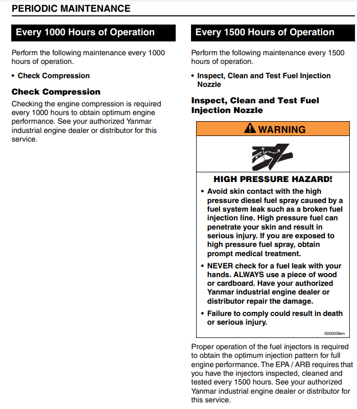

Should I replace the injector and the fuel pump at ~1K even while its running 'ok' as the service manual suggests? The speed hasn't changed a bit when idling or fully loaded and no visible smoke, holding a tissue near the exhaust starts getting greyish at ~4kW (80%) after 10 seconds, surge duration at ~5.6kW is around 3 seconds before overfuling hunts the engine (same at 30 hours testing). If it protects the engine from fuel dilution then I'll start ordering from now as the kama/kipor modified parts take time to ship from abroad and until a battery backup system or migration is finally done.

I am sure parts are challenging to obtain, but I would replace them if I could. Not replacing them risks slow fuel injection deterioration, resulting in carbon fouling and increased fuel usage.
You are well on the way to being the high hours owner here!

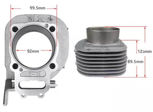

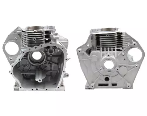

Good idea!
In this air cooled genset I'm guessing that I should be scavenging heat from the exhaust? modified intercooler?
I guess it requires a lot of work to convert it to a water cooled engine. (this one has removable cylinder with wrapped around casing for circulation.)
removable type:
non removable 192f:
Thanks.
   / Forum for air cooled diesel engines and clones #586
Well, how much water flow are we talking about and what is the pressure?
I have known people who ran the exhaust through a 55 gallon drum in a pipe, and then used water in the drum to transfer heat to a second coil of water. This is the simplest and least likely to cause a problem with your generator.
If you want higher efficiency, you could wrap some soft metal tubing around the mufflers, or an external exhaust pipe. After that, I would think about using an external radiator to warm water from the waste heat in the air, which I think on your unit exits over the mufflers. You can fill the tubing with sand, and then blow it out when you are done to keep the tubing from collapsing.
I worry always about water around electricity, so if it were me, I would try the barrel with tubing in it first. I also wouldn't have any joins in the tubing inside the enclosure. Any movement of the tubing will harden the tubing over time, and crack, so make sure that the tubing is fastened securely so that it doesn't vibrate.

Edit: It seems like the Japenese manual does not suggest replacing the injector, only testing is needed, I'm assuming spray and pop pressure? No mentioning of fuel pump replacement. I'll order a spare anyways, the chinese manual is badly translated, should be "check" not "change", I've noticed that after I read "change valve clearance" in the paper manual.
   / Forum for air cooled diesel engines and clones #588
If you can check the spray pattern locally, great. If not, I would swap in a spare as the generator seems to be a fairly critical item for you. If your water heater is a long distance away from the generator, I wouldn't bother trying to capture the heat. It is too hard to insulate long pipes.
