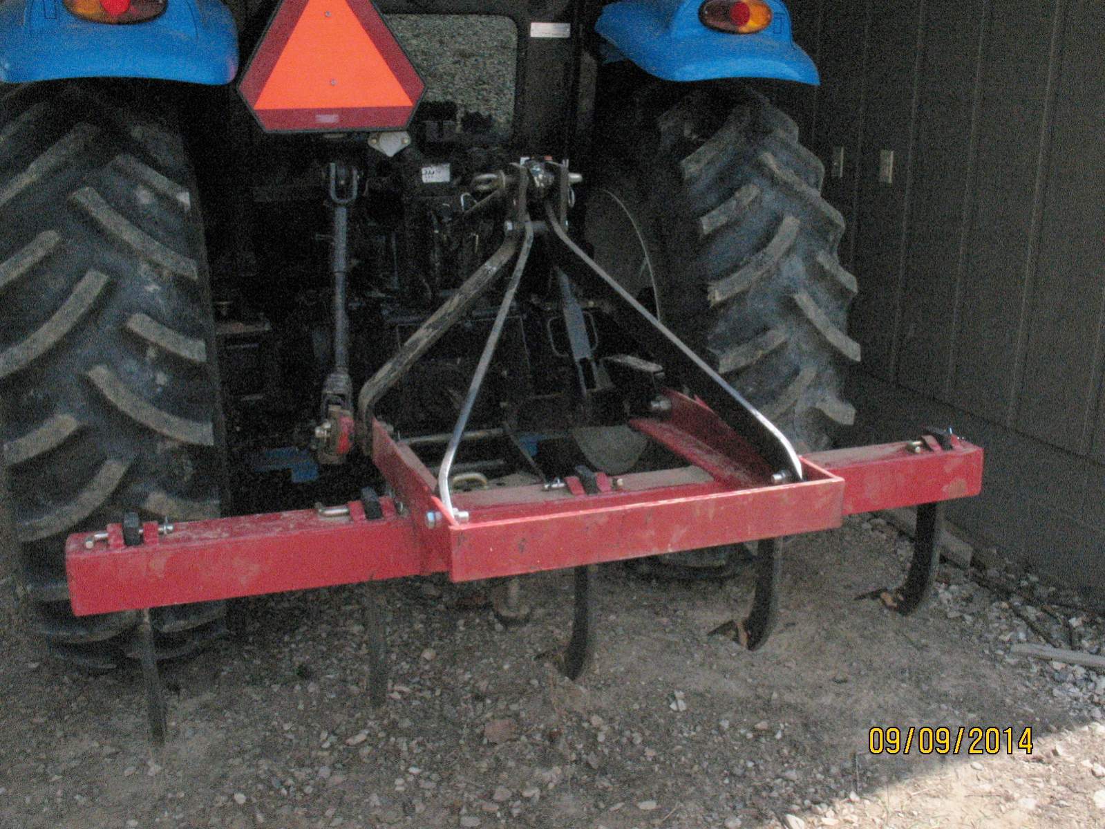

I use this to break up any hardpack and bring up rocks to the surface. It will pull all the way to the frame which is plenty deep enough for any root system other than a tree. If I recall rightly, I think it was around $250.
