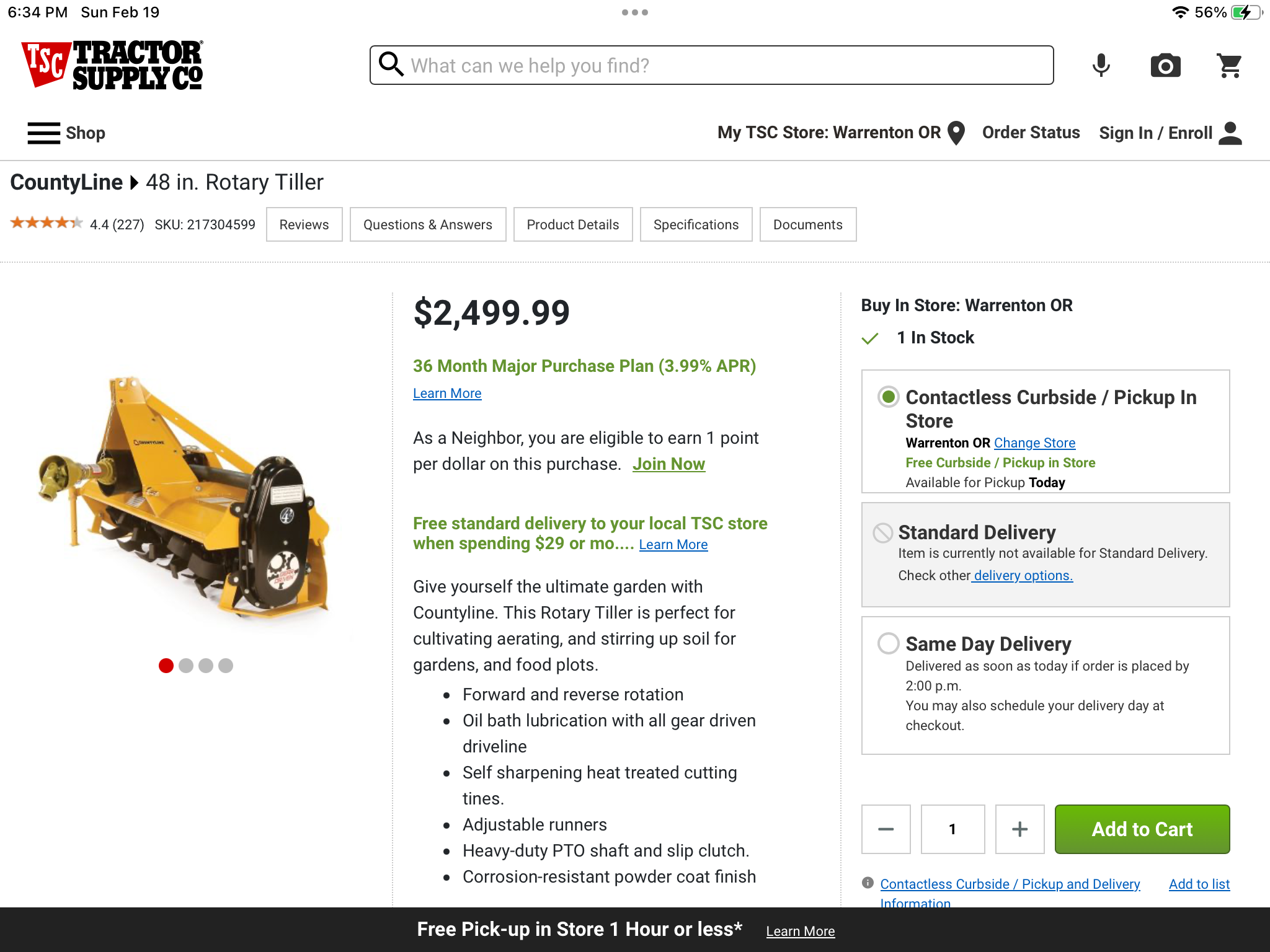

So I’m researching the local market for a 48” tiller for my B2650 and I’m evaluating the differences between the forward rotating models and the reverse rotation and I’m having trouble in deciding…
I kept thinking “why don’t they make a tiller that give you the option of choosing the direction at will? Then, lo and behold I came across the King Kutter and reading their specs, it says “forward and reverse rotation“. Is this accurate? No one else seems to offer this feature.
Made in the US, about 560 pounds, do any of you have any experience with this brand of tiller? Pro’s and cons?
Thanks all!
Not exactly at will, but is doable. You have to unbolt and reverse the tines, then disassemble and reverse the gearbox. page 14-15

The king Kutter you had the link can be configured into a reverse tine tiller but it requires you to flip the gearbox on the tiller around so that run in reverse. Definitely doable but definitely not something that could be switched job to job.
Both tillers have their advantages. Reverse tine will give you an incredibly smooth and well worked seedbed in one pass. It also seems to do a better job of burying the surface debris then a forward tine.
Forward rotation is a lot more forgiving to the tractor but on really hard soils it might not want to dig and will take multiple passes. Hit anything hard the tiller will bounce right up over it. With a reverse rotation it is likely to stop you dead in your tracks.
