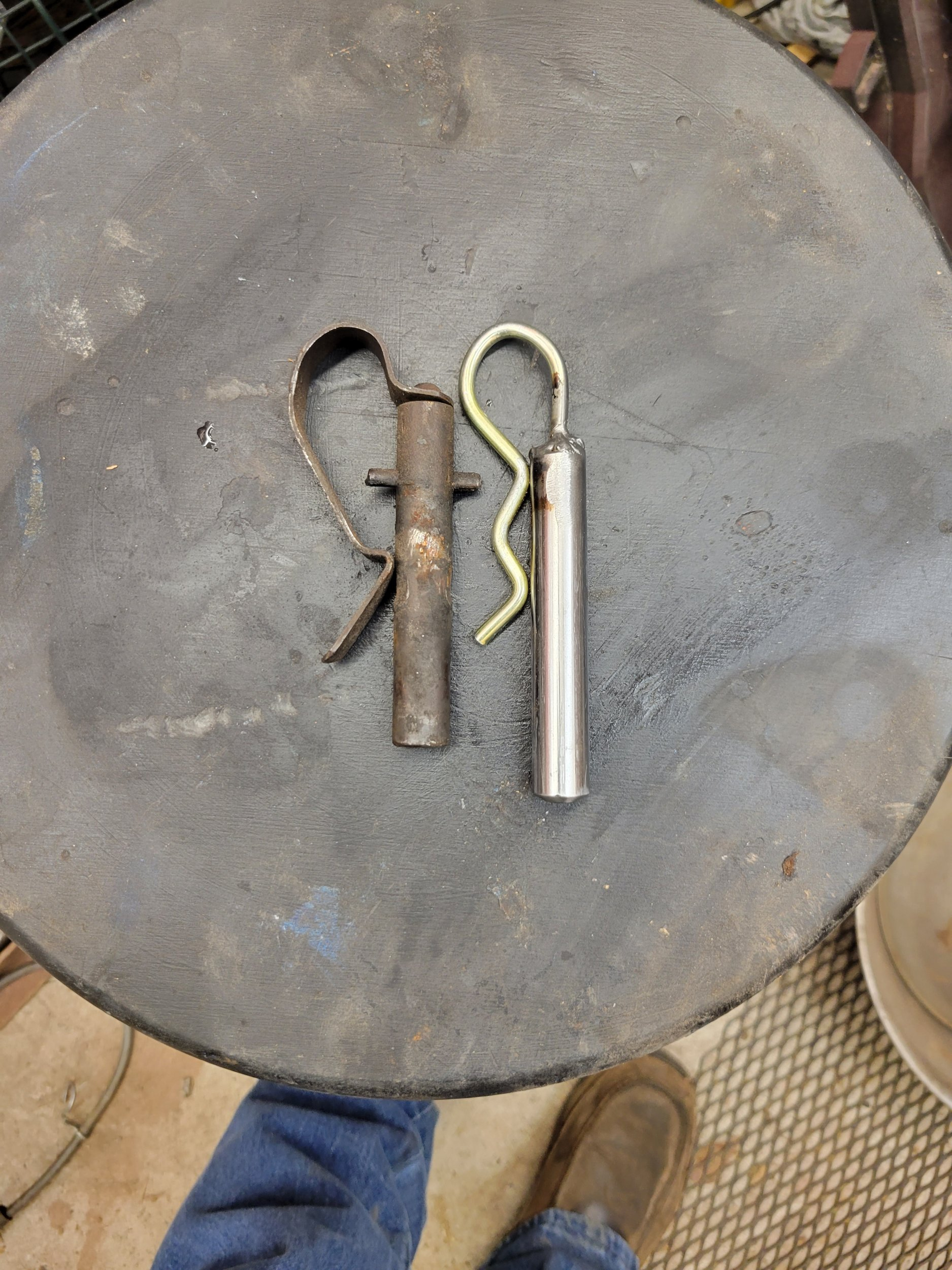

Problem solved. Works better that original.

Good idea!!(y) Now to the next issue :), have you peeked in the trans case yet?
   / Forward stopped in the first 2 gears
#16
Yes. I had a broken fork. I have one on order. As far the tpl, it is plumbed wrong. Gonna fix it all this weekend. Thank you so much for the help.
