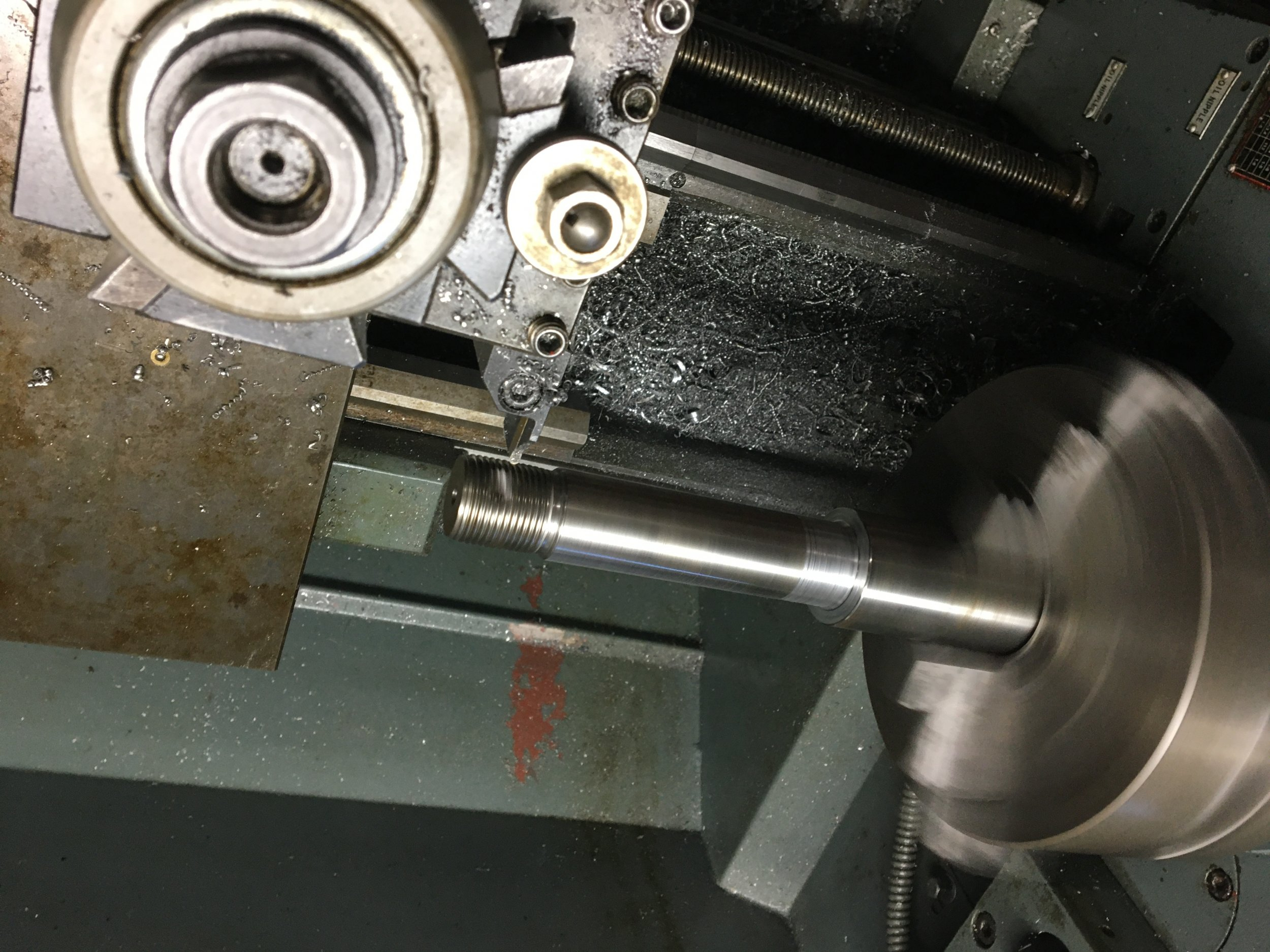

I got a nice little jack that will do the job perfectly.... and I made an alignment toll already to make it easy.
