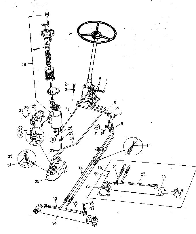

Greg I just did a fluid replacement, I did not flush with any alternate or substitute fluid.
If I did it again and performed a flush with kerosene or something other than the proper fluid how would I remove the contamination of the kerosene in the new fluid?
I would have thought by running the system through with clean fluids and the line open would have removed the ability for any thick fluid to be left trapped in the control box. If I understand this system it is not recirculatory but one hose per cylinder. Would I not have passed all fresh fluids through the control box as it was being bled out the cylinder lines?

No separate reservoir. Note that there are four steel lines at the controller. Two are supply lines, two are return lines; let's call pressure lines 1 and 2, return lines 3 and 4. The pump supplies the controller. When the steering wheel is in the straight ahead position, there's little or no pressure on any of the four lines. Fluid will circulate, but not under great pressure. Turn the wheel to the right, the controller causes line 1 to become pressurized, and routes that fluid to the cylinder on line 2. The cylinder ram extends, sending return fluid through the reservoir/filter and back to the controller. Turn the wheel to the left, the controller causes line 2 to become pressurized, and routes that fluid to the cylinder on line 1. The cylinder ram retracts, sending return fluid through the reservoir and back to the controller. I might have right and left reversed in this description, but the principle is still the same.
Your test proved that some fluid was flowing, but I'm presuming your nature is not to be wasteful (or messy). That leads to a further assumption that you only checked briefly for flow at those two cylinder ports. So the actual fluid flow in the circuit was perhaps only a few inches. Not sure of the capacity, but let's say the circuit holds two quarts of fluid. You moved a few ounces, so there could still be big chunks in there. My longstanding recommendation for the steering flush procedure involves draining the entire system, and replacing it with kerosene. Close it up, and drive around for several minutes making figure 8s. That will circulate the kero throughout the circuit, breaking up the crud, and carrying it along in the flow. Drain the kero, repeating the flush as dictated by the color of the crud coming out. When it comes out clear, refill with fresh steering fluid of your choice. The filter may also have caught a lot of crud, and may justify replacement as well.
This may or may not fix your problem. But unless/until we know you're working on a clean system, further troubleshooting is at best frustrated. Below is a diagram that may help. It's not specific to the FT404, but pretty close.
//greg//
