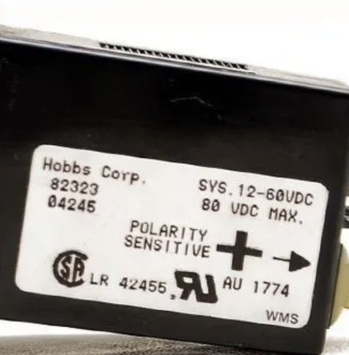

Hobbs Hour Meter
12v 60hz

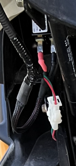

Just tied it into the headlight wiring.
Works like a champ and when/if the digital meter fails, the mechanical meter will still be working.
Lots of China clones on eBay for not much $$.
The meter glass looks scratched.
It was just a protective covering that has been removed and looks great.

OK not to nit-pick, but that definitely is not a "mechanical" meter.
It apparently opertrats with 12V DC. How have you wired it so that it only runs when the engine is running ?
   / Found 2007 GT1554 with 21 hours total
It is mechanical because it uses 12v to physically turn interior gears and wheels.
That’s how it’s referenced in the aviation, etc. world anyway.
I know what your talking about.
It’s tied into the headlight wires.
No switch and the headlights only work when the engine is running.
May not be the case here, but be mindful that there are a lot of riding mowers that the headlights are wired AC straight off of the alternator/stator.

#9
This particular meter is 12-60v
I did check with a DMM before tapping into the wires.
Also installed Philips LED headlight bulbs

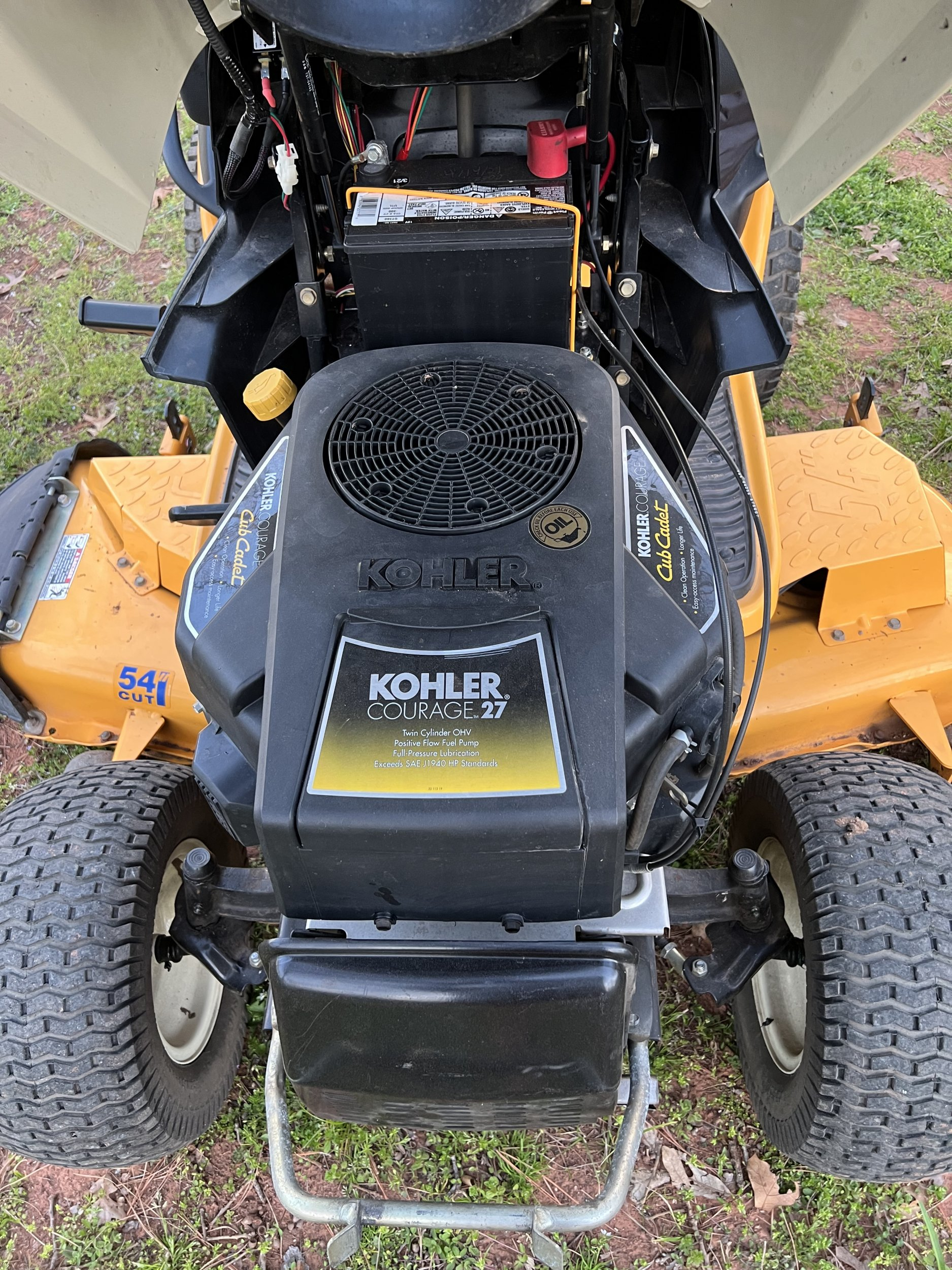

Plenty of room for a nice clean install.
